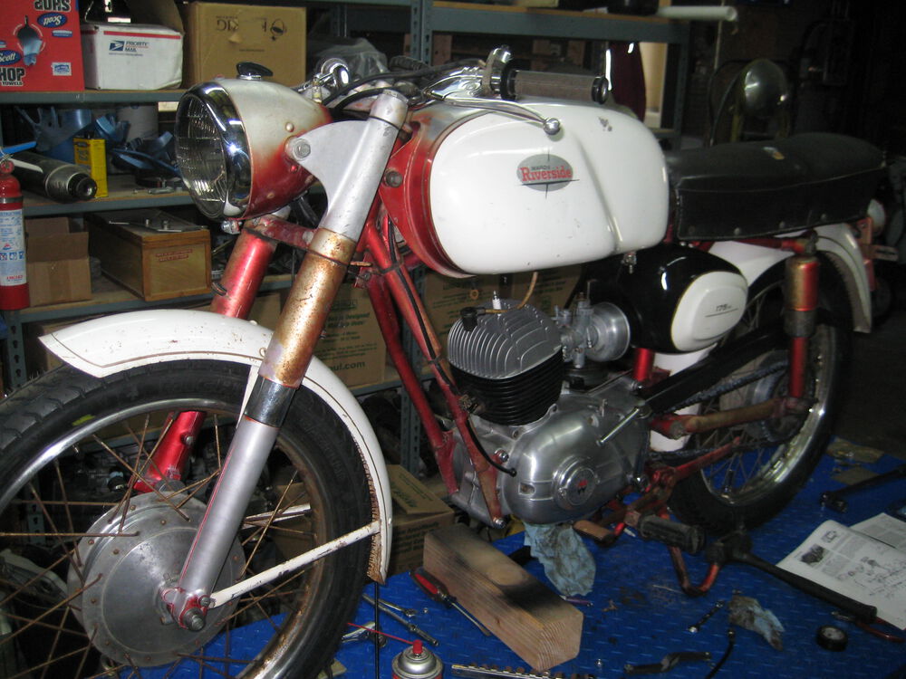

I have put two condensers external and removed the internal. That allowed me to move the wire from one to the other if the current one fails.

it was on a Benelli/wards riverside.
same could be done on a lambretta. I mounted it on the same bracket as the coil. wire then just goes from the hot side of the coil to the condenser.

Hi,have you better photos of them mounted ,cheers
I looked, didn't get a picture of them.
