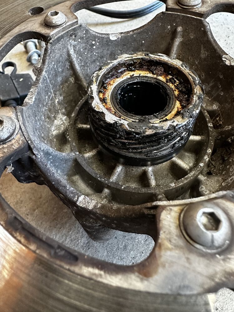

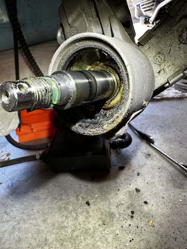

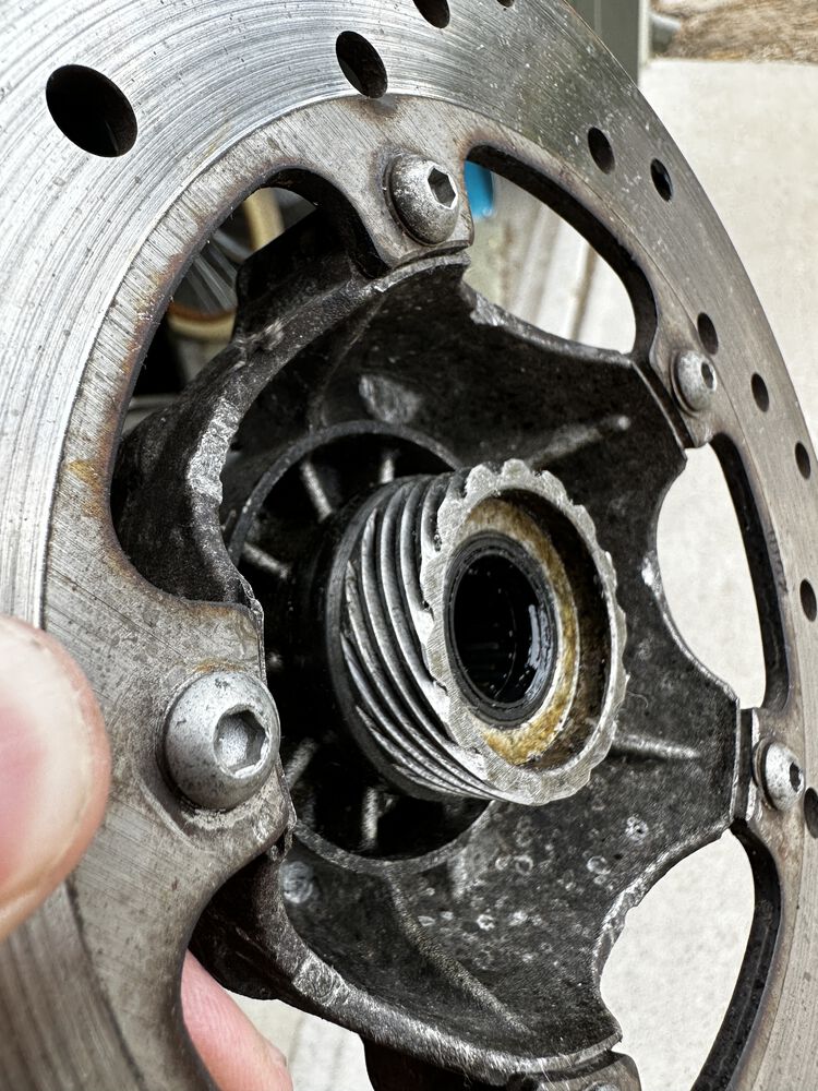

I was able to get the hub off. The grease is definitely congealed! As soon as I pulled out the speedometer gear, everything started moving a little easier. I think cleaning up the old grease should fix my problem.

Eeew - yeah, get that seen to and you'll feel good knowing you can eat off the insides. πŸ‘
Pull the speedo cable off (and the plastic gear) - you'll find a lot collects in that area.

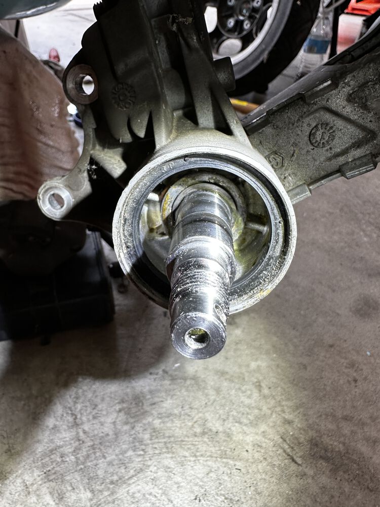

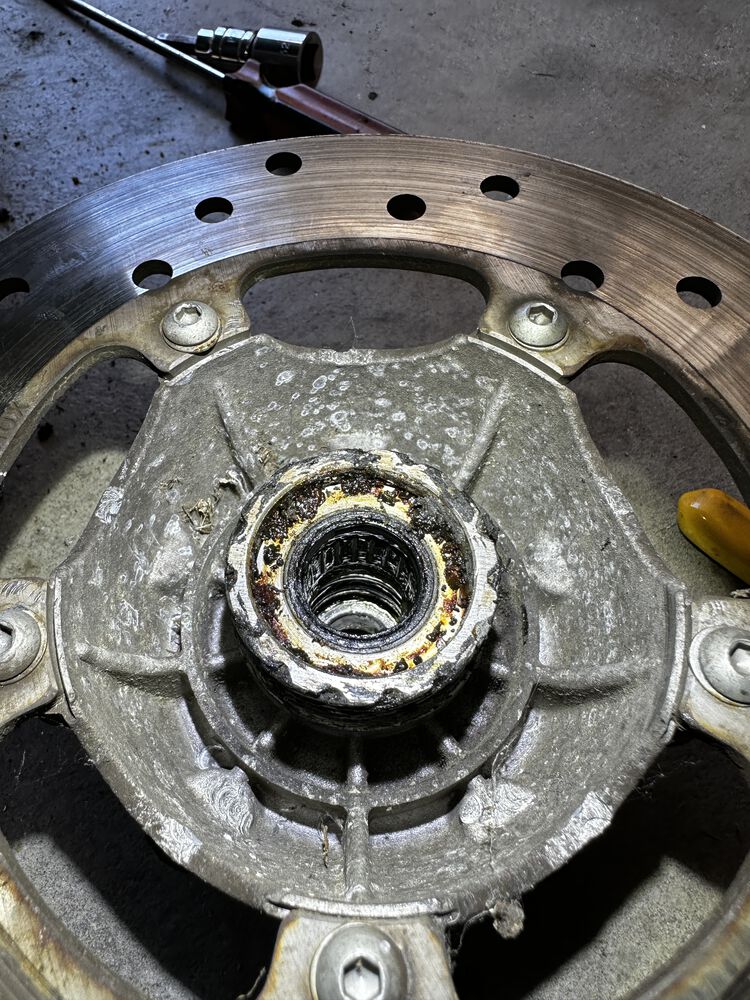

All cleaned up 🧼
A little grease and everything will be going back together

much better.
remember to throw some grease on those inner bearings and lube the lips of the seals.
torque the hub nut to spec and don't forget the cotter pin!!
