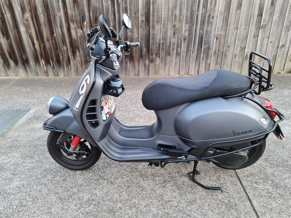

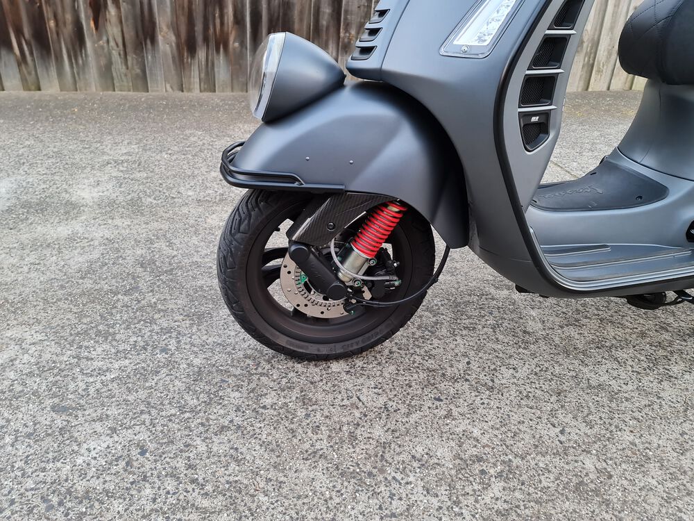

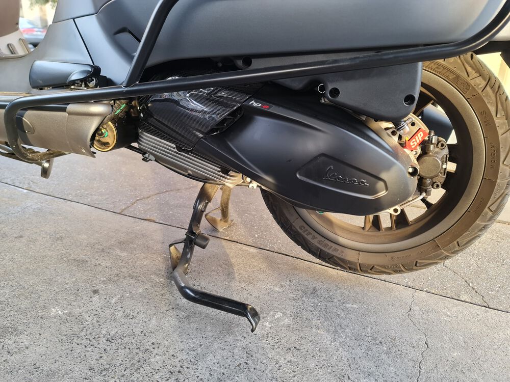

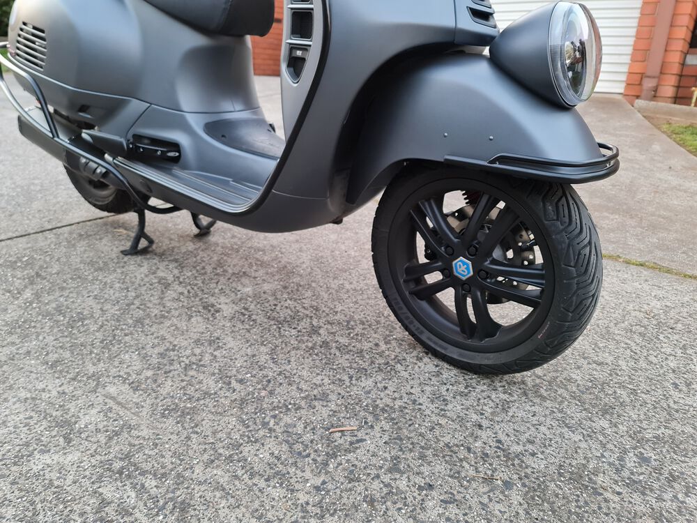

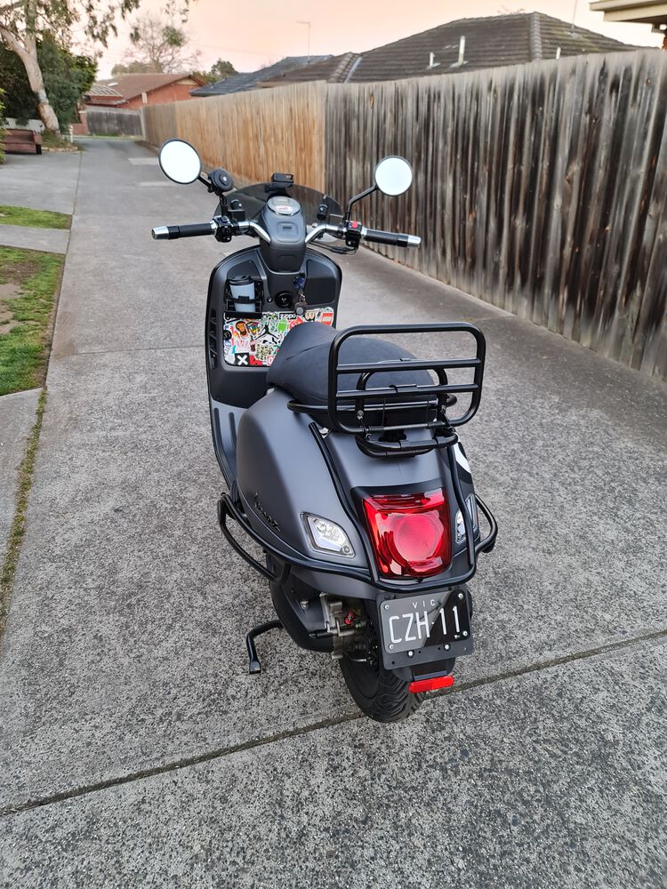

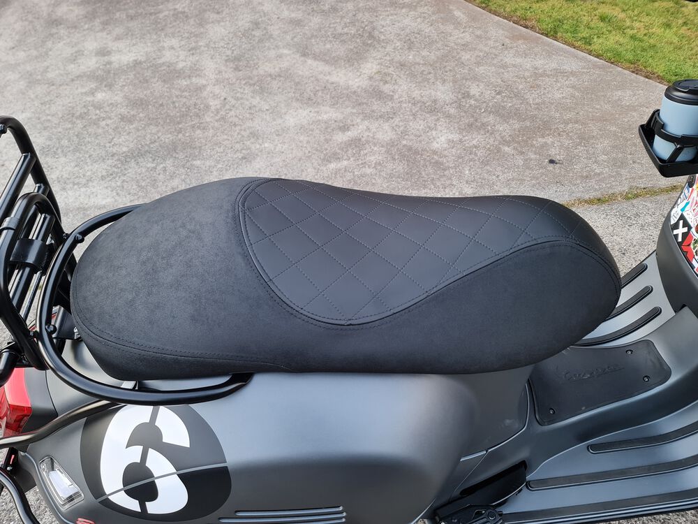

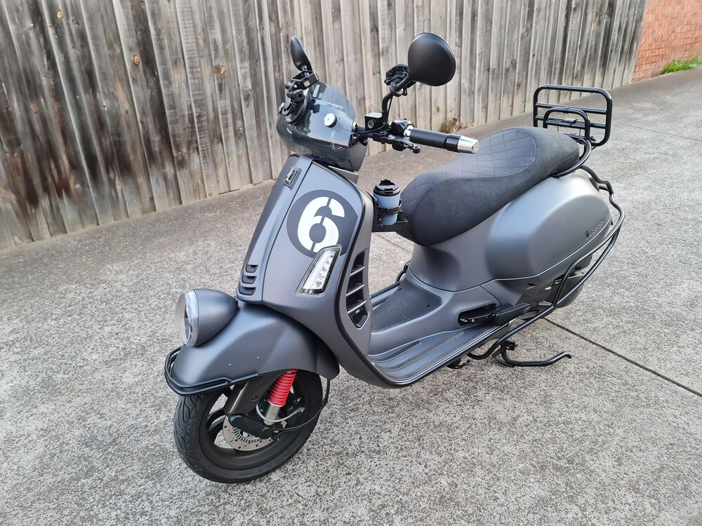

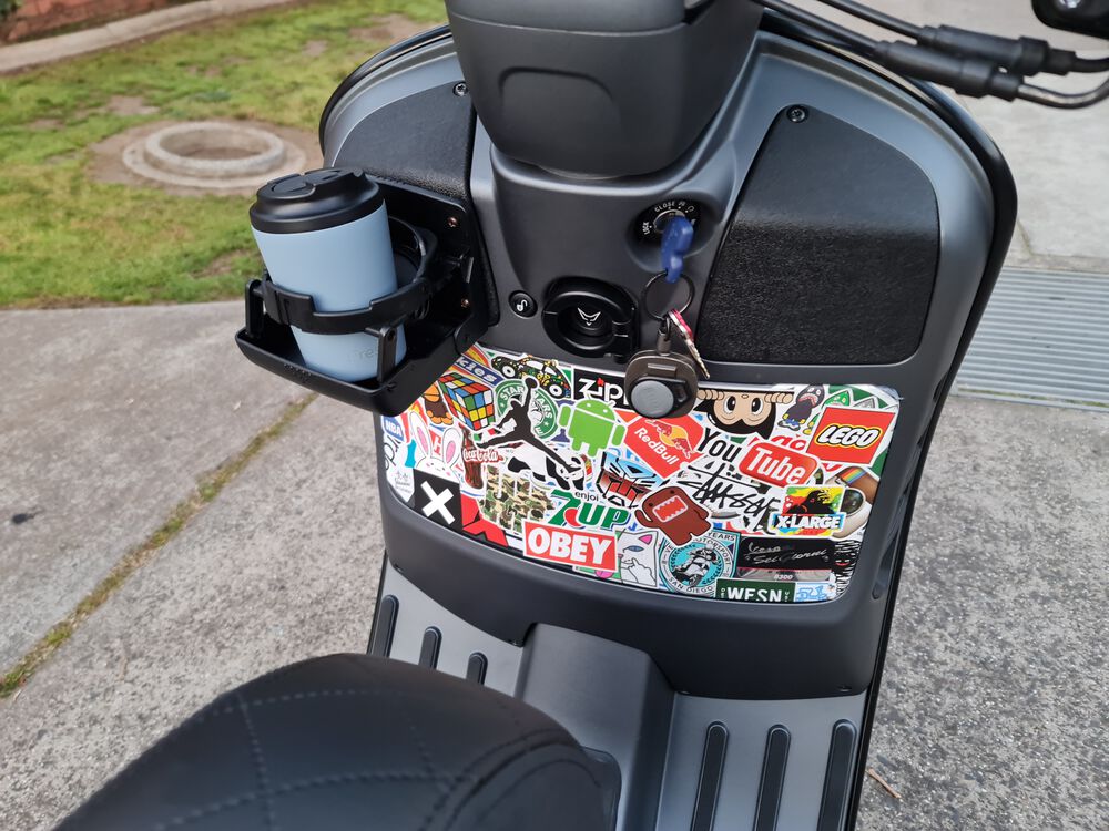

Interesting stuff
Here are some pics!

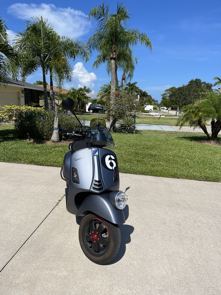

Gorgeous pics. The leg shield black trim is sweet. Do you know if the wheels are original. So many nice things blocked out. What component is SIP on the rear wheel. Nice bike!
Wheels are from an MP3 https://www.sip-scootershop.com/en/product/rim-front_PI58618R?q=Rim
The red sip you see is a replacement transmission oil dip stick https://www.sip-scootershop.com/en/product/oil-dipstick-gear-oil-sip-series-pordoi_MV832130R

Steelbytes, how do you do it!? You must be a genius to see those parts and figure where they are. Thanks very kindly.
I've got too much time on my hands and I had seen those before

SteelBytes wrote:
I actually purchased them from Falan Parts as I think it worked out cheaper, but SteelBytes is 100% correct on the product/item.
I couldn't stand the chrome bits on the Sei Giorni so have been trying to black as much of it out as I could......which brings me back to the whole point of changing the speedometer

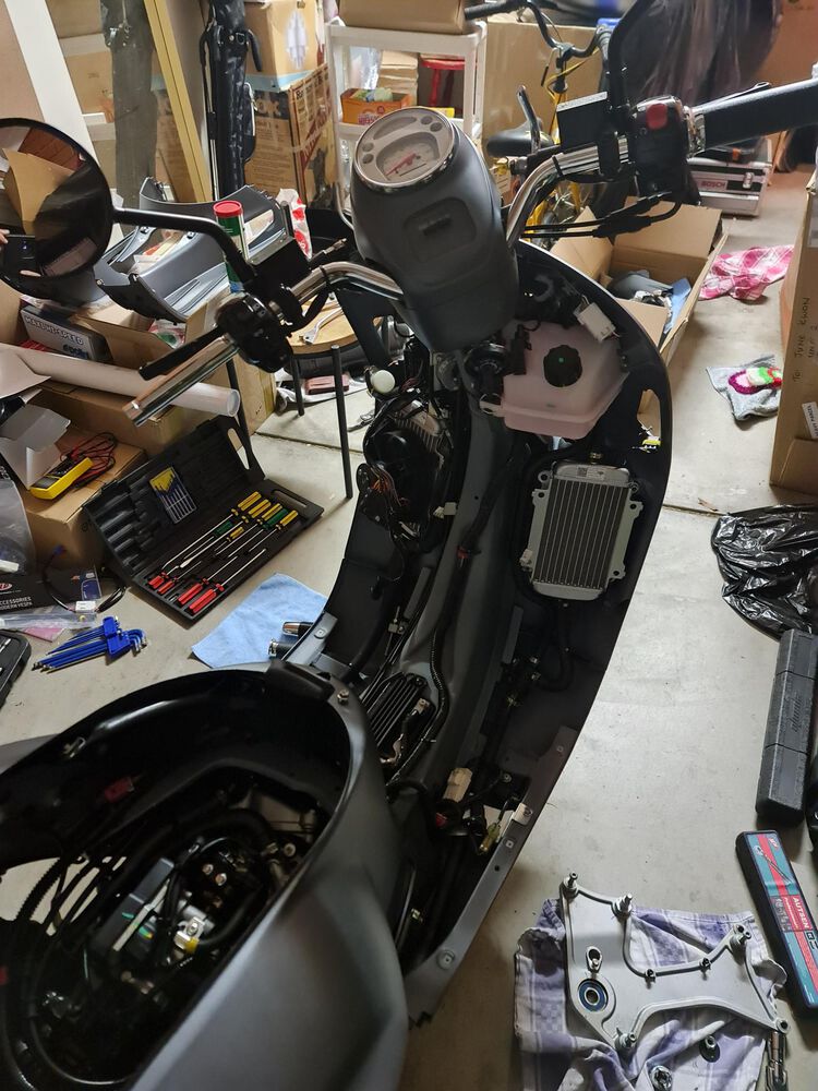

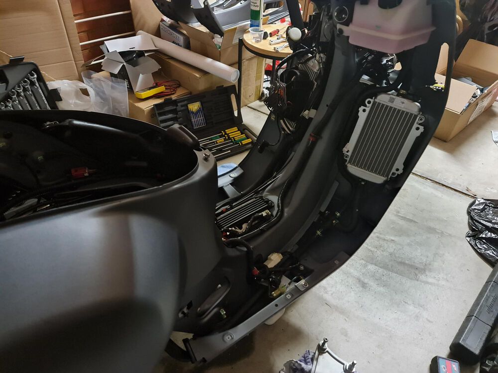

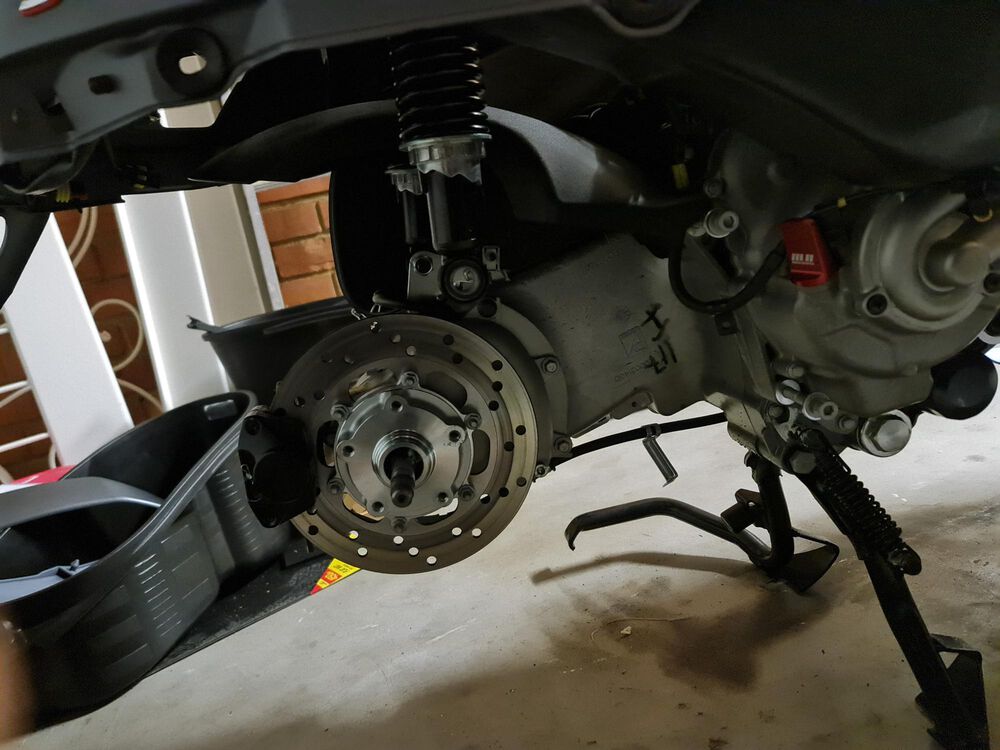

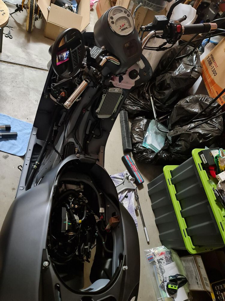

Yeah, I did everything myself. Headlight, exhaust, the rims, crashbars, shaving down the seat (it didn't actually fit because it was from the previous model...), installing an SAE lead from the battery to connect to the Quadlock wireless charger, cupholder (lol) etc.
But to be honest, it wasn't that hard. Prior to this, I'd NEVER taken anything apart. I mean these days, with Youtube, there's really no excuse for not trying something I have ZERO mechanical experience.
The videos by Robot helped alot. I think I've also watched all of ScooterBud's videos too. I like watching different videos because some had all the proper tools (e.g. Robot), but others would use makeshift tools which was similar to my setup (i.e. I only have basic tools).
Not sure where you're based, but I'm in Melbourne, Australia. If you were local (or if anyone else is!), I'd be happy to help.
Lastly, yeah, the leg shield trim is pretty involved. You pretty much have to to take everything off. The most stressful part to remove is the glove box. It's scary. You have to wriggle it around the cables and there are always things stretching/creaking etc. I hate doing it so much that I ended up retracing my steps and writing down the exact steps on how to take it off. It's honestly the worst.
But if you can get past that, you'll be fine!

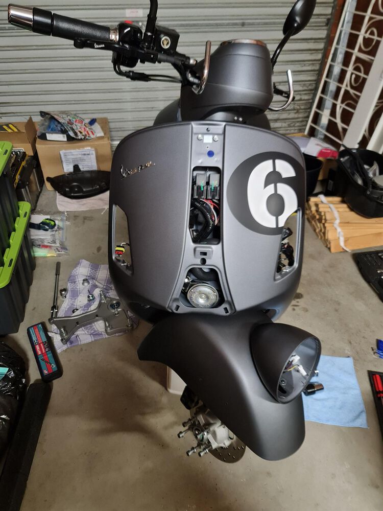

I've attached some photos of when I took it all apart

Attached is my Sei Giorni now. Replaced the mirrors a few weeks ago. I'm not done blacking out. I like the touch of red on the OEM wheels. Always fun!
