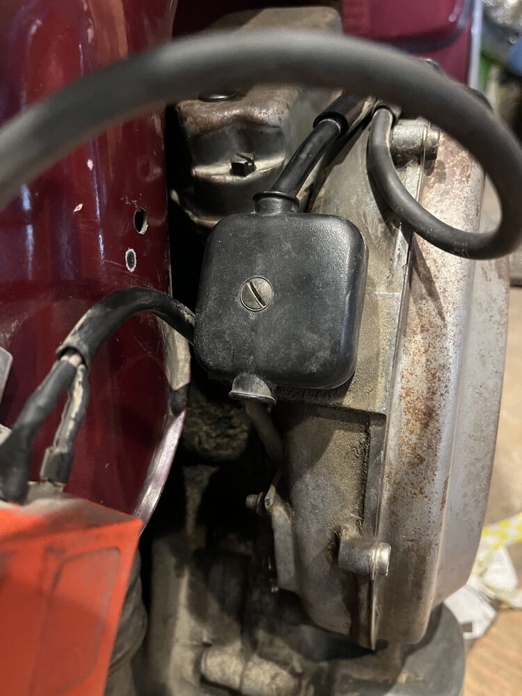

Can someone post a picture of the correct Junction box for Rally 200.
some background:
I have this German Rally 200 here, FEMSA equipped, with turn signals at the end of the bars. I understand it's not a USA market bike and some equipment will be different. I am looking at getting the correct reproduction.

"junction box" being the battery side or top of the engine?
does this have the key at the headset or near the curry hook?
Thanks for the reply.
top of the engine.
This bike has a switch on top of the headset.

This is a '74 US market. it's not 100% unmolested but I think this bit is as original.
Wires to the FEMSA come out the back of the case. rest go to a "normal for the year" junction that has no wires exiting the rear of the box.
