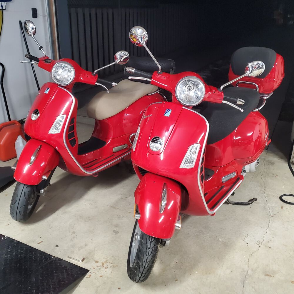

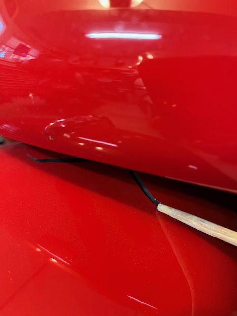

Looking over my '06 GTS today the front fender has major cracks. 17+ yo plastics I would assume, or my horribly potholed streets en route to work.
At this point its not rideable. From the Robot vid I'm buying some specialty tooling, removing the entire front assembly, and reassembling.
While I'm at it might as well replace the bearings / races that are 14k miles, as well as the mechanical speedo cable that I tried and failed to replace 5000 miles ago because the OEM fender made it difficult.
Plus I guess its time I buy a lift - way overdue
In the meantime, the '18 GTS will get me to/from the place of employment to pay for all the things. I've been thinking of paring down the fleet of late since I can only ride 1 bike at a time, this is why that's a bad idea....

Love having two identical models.
The part I need is on back order? lol no it isn't
