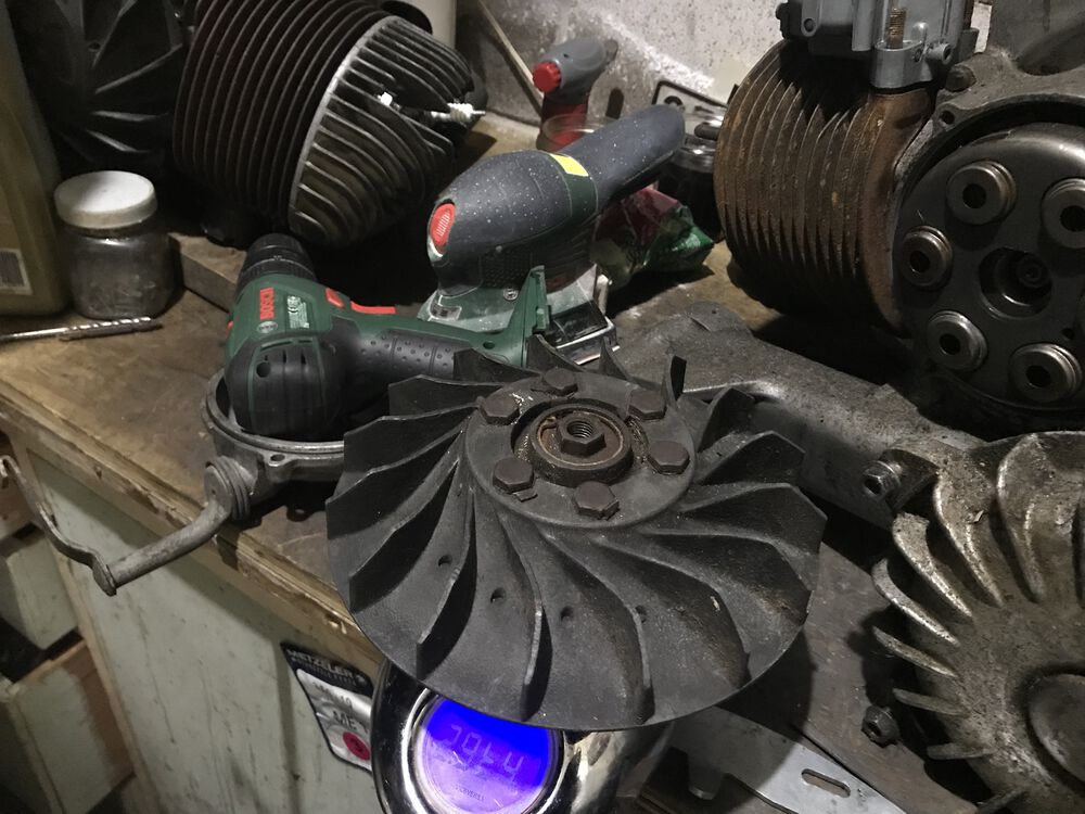

Cool! I'm pretty sure it's either 2300g or 2600g.
Posts: 98
Posts: 98
Cant confirm accuracy of budget scales, but 2900 is what I get if this helps.

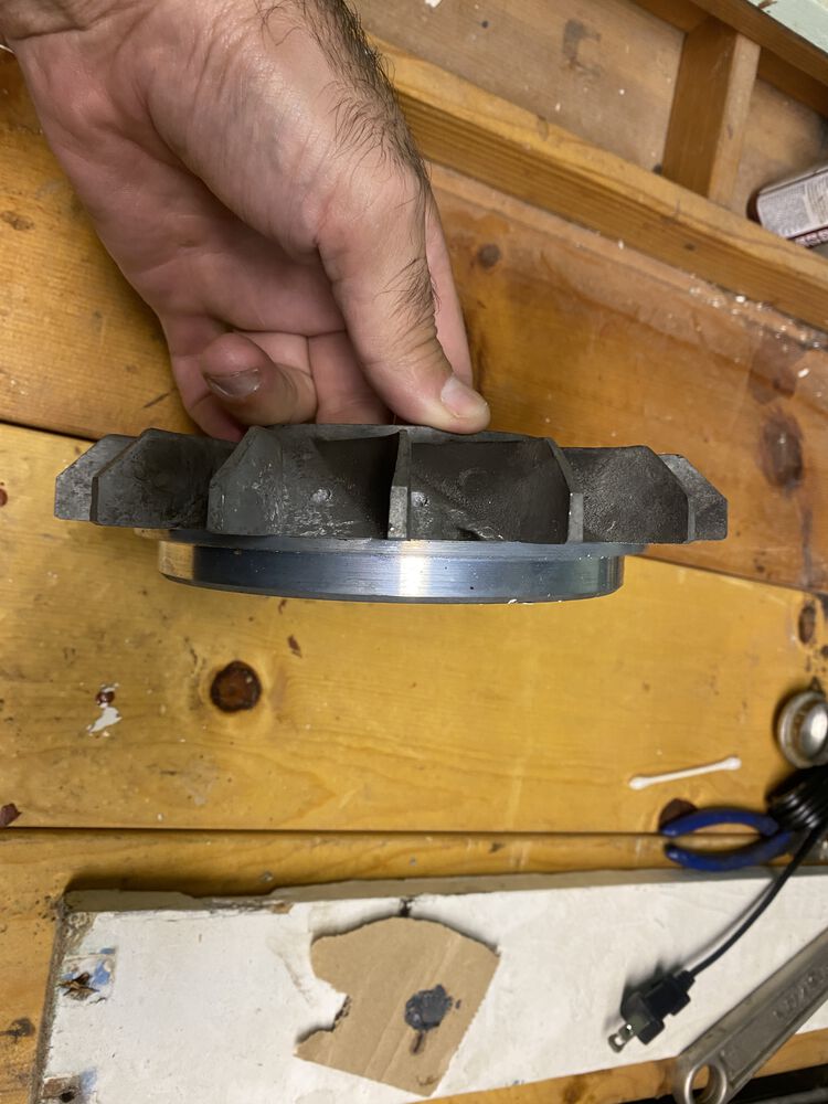

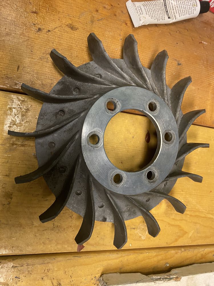

If you are looking for something lighter than stock, I have this one that is turned down.

Wow! Heavier than I thought. I'm looking for just the opposite. I firmly believe that the new electronic flywheels are too light and change the wonderful smooth torque of the SS motor. Trying to encourage a friend to stay stock.
