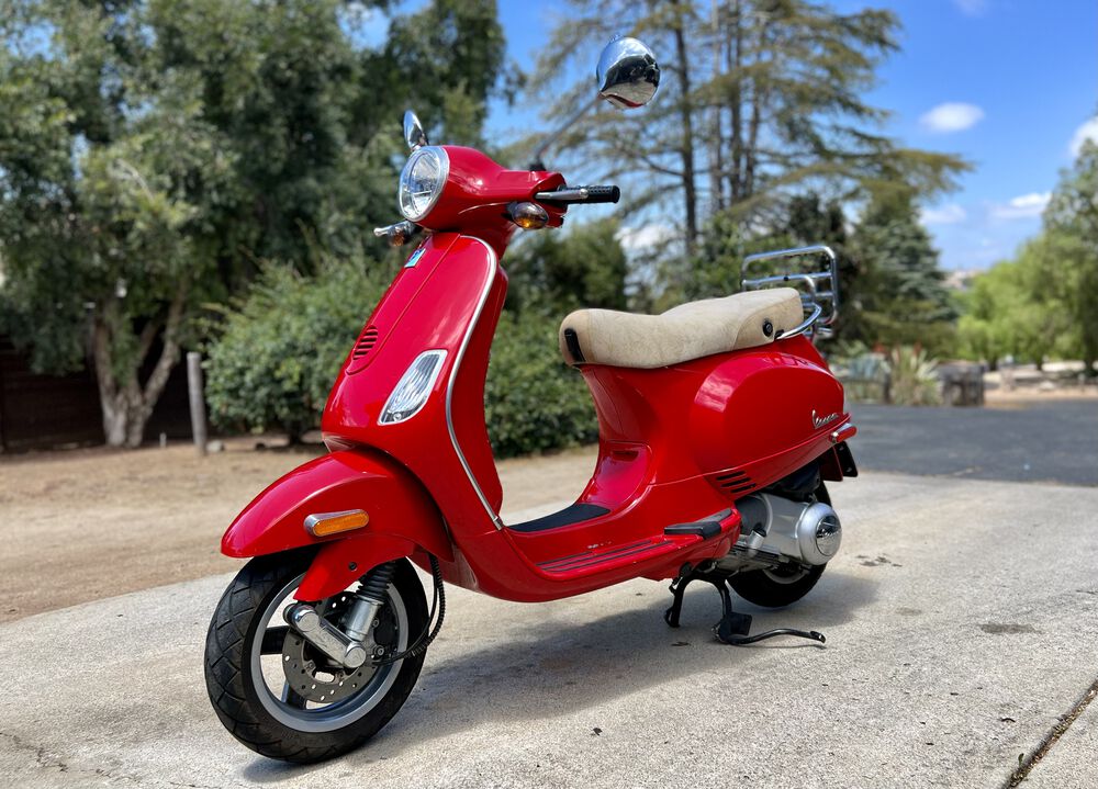

Stumbled across a 2009 LX150. Very very inexpensive - had to buy it. Remarkable condition - only 3k miles - original owner. But been sitting most of its life. Drained gas and put in fresh. Six year old battery pretty much worthless. Charged it and got scooter started but weak idle and dies with any throttle. Figuring carb needs cleaning. I've never gone that deep on maintenance. Do-able for a rookie? (As an aside, this is for my wife - she caught the Vespa bug when she was filming a documentary about the scooter cannonball this summer while I was riding in it.) Tips and tricks on bringing this LX back to running life would be welcome.

Decided to clean the carb myself. Now this $500 find is running great. I almost feel guilty… almost but not quite!
