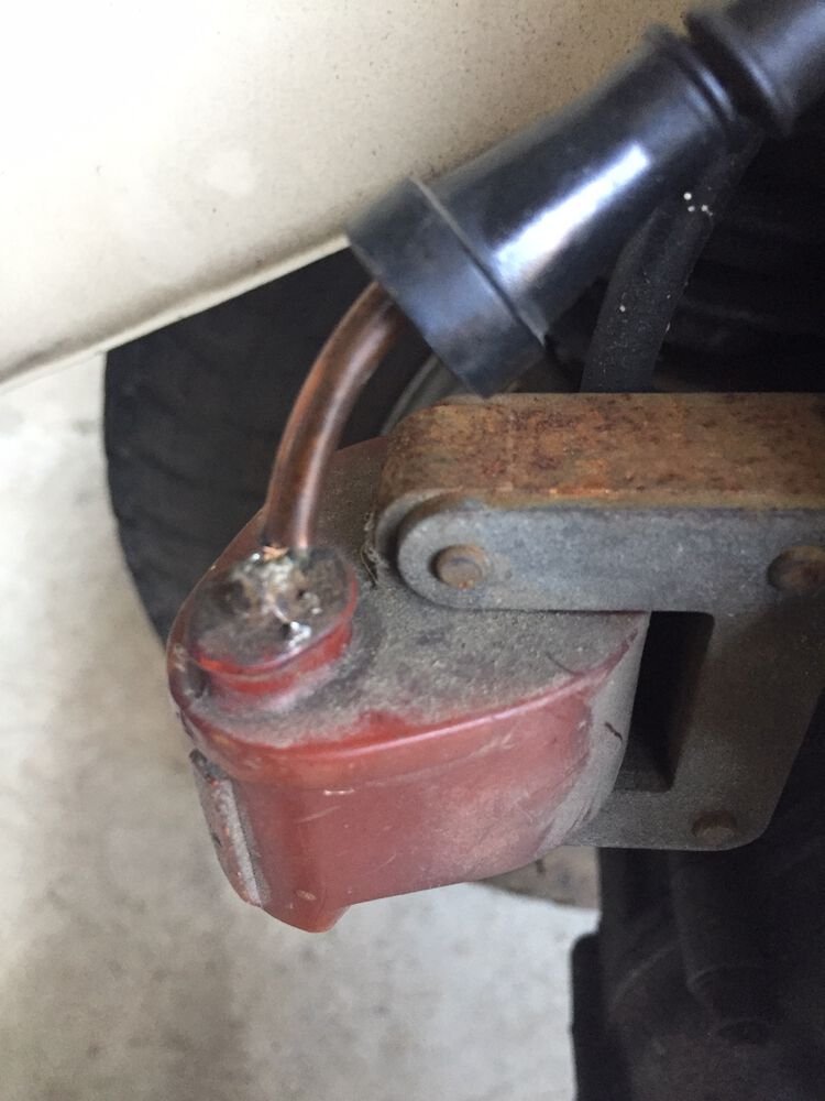

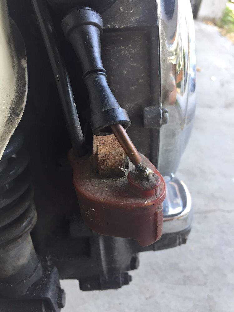

Anyone ever cut into there coil to be able to solder on a new sparkplug lead? Mine's frayed and will order a new one if you can't.

Frayed at signal from stator?

HT lead fine?

Which lead are you worried about? The primary connection repair from stator looks like it should work... the secondary HT sparkplug lead looks normal, I doubt it needs internal fixing or that this would be a good plan. The coil looks tired, but who cares if it works. Test it w/ a 6V power supply.

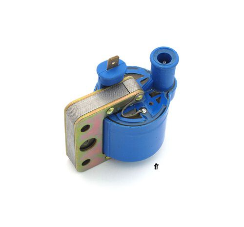

replace the coil with one like this where the plug wire is not molded in.
These Piaggio coils are hands down the best ever. I use this coil on three different 6volt bikes (GS, SS, V90) with great starting and superb reliability.

Just installed that coil. Maybe a bit more power since the wires aren't frayed and the original HT lead worked.
