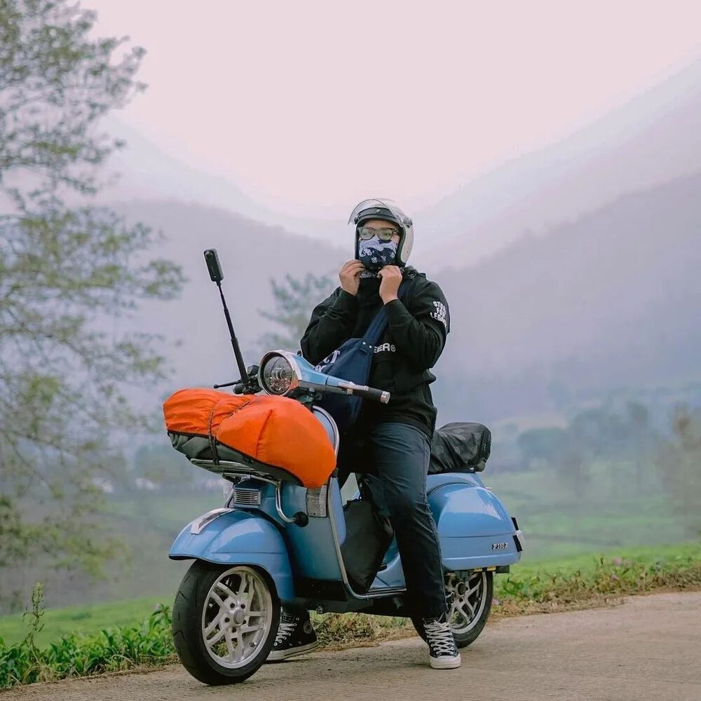

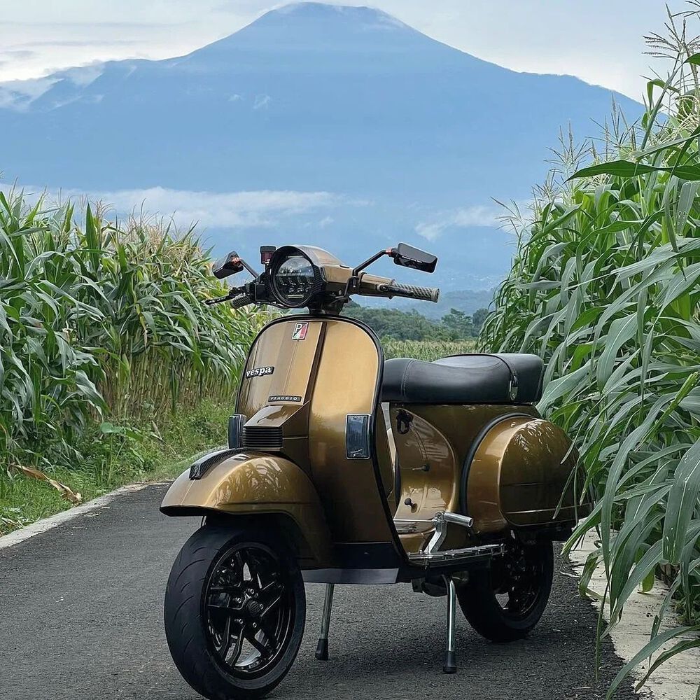

Has anyone ever used a 12" wheel for vintage Vespa?
I saw Indonesian scooters using 12" wheel on their P-series. Looks cool, I wonder how that would affect the top speed and long riding experience.
Also, there is a manufacture called Scarletracing that makes 12" rims which using the 10" drum brake as the adaptor.
what do you guys think about this?
