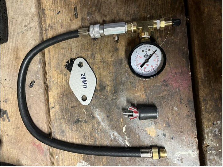

I made my pressure test kit
Unfortunately I have a leak... I just finished totally rebuilding this engine, this is very frustrating... Could not find the leak with a spay a soapy water, no leak on the flywheel seal, nothing at the base of cylinder, nothing between the cylinder and the head, clean on the spark plug, the plug on the manifold is ok. I can't believe the oil seal on the clutch side is leaking, it is brand new, the crankshaft is brand new, I have the special tool to pull the crank from the clutch side and I know how to use it, please no, no, don't tell me I got a failed oil seal, please.
What is the last check ? The exhaust manifold, hopefully the engine is on the stand, I rotated it 180° the have the manifold pointed upwards and I was able to spray from the top and see some bubbles, and YES, a lot of bubbles ! it leaks from the manifold where it is screwed to the cylinder, good news, it doesn't matter finally !
So guys when you have a leak, think about the manifold connection to the cylinder before splitting your engine

MJRally wrote:
How fast is it leaking?
With the inlet and exhaust suitably blocked it was just a matter to connect the pump and gauge to the bleed nipple on the inlet bung and pump away. If the motor is healthy then you should expect it to hold pressure, or more likely to leak very slowly. It has been suggested that the threshold of acceptability is losing less than 1 psi (or in this case 50mmHg) per minute.
https://archive.scooterlab.uk/engine-pressure-testing-leak-cheap-tech/
I don't get it (English is not my mother language, french inside ), you mean using a tube like in the video ? I dont have an intake manifold for that kind of carb, SI 24 only...
I could remove the exhaust manifold and try to block the exhaust port but I dont have anything that would fill the hole. Maybe a cone shaped silicone plug would fit ? Don't know
@mjrally avatar
Posts: 5363
@mjrally avatar
Posts: 5363
You said you have a leak. I am asking how fast does it leak? 50mmhg/ minute like the article says? Or faster?
@colinbelgium avatar
VBA1T/Px200 iris/VNB6T
Posts: 737
Posts: 737
Faster, I'd say 100mmHg/min at least, maybe 200 ! But the leak from is manifold is large, as soon as I got soapy water on the threads I could hear the sound of leakage + lots of bubbles.
@mjrally avatar
Posts: 5363
@mjrally avatar
Posts: 5363
200cc stock cylinder and exhaust stub? If so, you can unthread and retread the stub on. Make it a two person job so it is extra tight.
Posts: 737
Posts: 737
Yes 200cc stock cylinder/stub. I took the stub off the cylinder to clean it, maybe I didn't screw it back tight enough (cylinder was in the vice so I put quite a lot of force).
Or use some heat resistant silicone on the threads (for fireplace application, 1600°C grade)

garncarz wrote:
The HVAC industry uses smoke matches.
Nowhere near enough output, plus you still need to get the smoke inside the motor.
I mean, sure I could just buy one, but where's the fun in that? Razz emoticon
Posts: 10670
Posts: 10670
Swisher Cigar at the corner bodega.... $1.00
https://www.youtube.com/shorts/0TuVwLUugU4
px 125 disc
Posts: 314
Location: Essex, GB
px 125 disc
Posts: 314
Location: Essex, GB
ColinBelgium wrote:
Good idea ! Do you know the right diameter to fit a stock 200 exhaust manifold ?
I used these on my vmc super g exhaust stub
https://www.amazon.co.uk/gp/product/B08JTW5JRV/ref=ppx_yo_dt_b_search_asin_title?ie=UTF8&psc=1
