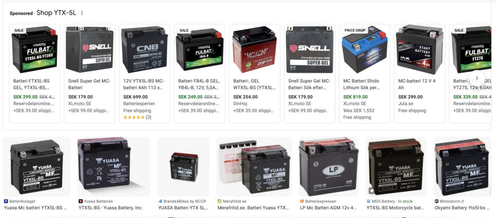

Hi all, thanks so much for the reply! Looks like from all of your suggestions, I need to replace the 12V battery under the plastic cap.
Does it matter what kind of 12V battery I buy? or is there specific ones I need to get? If yes, could you please help me understand which one?
I looked up online, and some forums mentioned the Yuasa YTX5L. Do I have to get the same exact one, or some of these pictured are okay?
Thanks a lot once again in advance, and sorry for my technical naivety. [img][/img]

First: Do you have tried to charge your service battery?
In your Picture are multiple battery brands, an maybe multiple types.
Go for Yuasa if it is available. Yuasa is a good choice, it's OEM quality for a reasonable price.
In Primavera/Sprint a Yuasa YTX7L-BS is used, it has a little bit more capacity than the Yuasa YTX5L-BS (4.2Ah) which comes with the Elettrica, so I would go for the stronger YTX7L-BS (6.3Ah). It will fit perfectly in your Elettrica as it is the same frame as Primavera/Sprint.

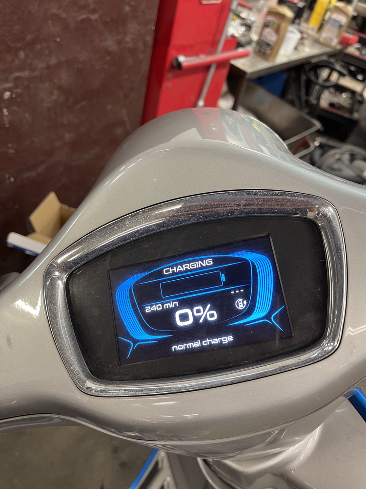

Hi guys, thanks to the replies- but I have another issue. So I followed all of your advice, which is to replace the battery with a brand new one.
I just did that, and finally the screen lights up for the first time in two days- but the charge stays at 0% and the red light is blinking (just like on picture).
Anyone can help me figure out what's the current problem - and possible way to fix it? Thank you in advance!

Out of curiosity, if you unplug the Vespa from the mains electricity and then turn the key in the ignition as if you are going to ride the Vespa, can you hold the start button and then ride it? Or does this also show the charge at 0%?
I would try unplugging the Vespa from the mains electricity, then disconnect the battery under the floor for a minute or so, then reconnect battery under the floor, then plug it back into the mains. Hopefully this is enough to "reboot it".

what red light? (don't see one in the pic)

9 months? Generally you want to keep a lithium ion battery between 20-70% during storage. Below 20% the cells can start to degrade. At 0% they absolutely start to degrade (meaning, their ability to hold electricity starts to decrease.)
You might have to replace the big battery my guy. Which is going to be really really really expensive. google searches show people talking around the $3800 ballpark for a replacement battery.
good luck. if you want an unbiased opinion on lithium ion batteries, call Powerful Lithium in NYC. Probably one of the top 2 aftermarket ebike battery shops in the US. Really nice guys.

I doubt it was ridden and then parked up at 0%, and the traction battery doesn't really discharge when stored as all the instrument cluster, immobiliser etc are all run off the 12v battery.

Just wanted to update everyone since folks had a variety of helpful suggestions. Ended up having to return the Elettrica to the dealer and he said something about the software being corrupt? So it had to be reprogrammed somehow. In any event, it charges up fine now, but it seems like something the dealer would have to do.
