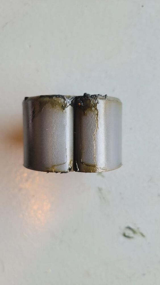

Silent Block after installation and removal.  Cracked

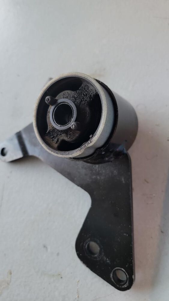

Top view of installed silent block.
