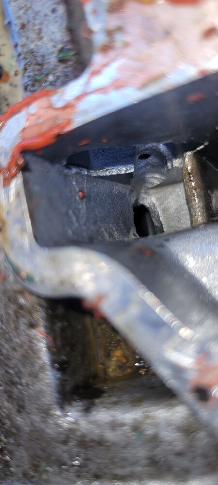

Greasy125, turns out the cylinder jug was cracked on the base side. Also there is some odd modifications to the case, specifically where the bottom timing chain slide goes into the case. Just left of the slide but south of the piston is this pinhole in the case, im wonder how ït got there, and if it could be allowing coolant into the case with the oil. Head gasket was bad

ohh... somebody was in there with chicanery! see the orange gasket sealant? that's not supposed to be there!
more pics please!
