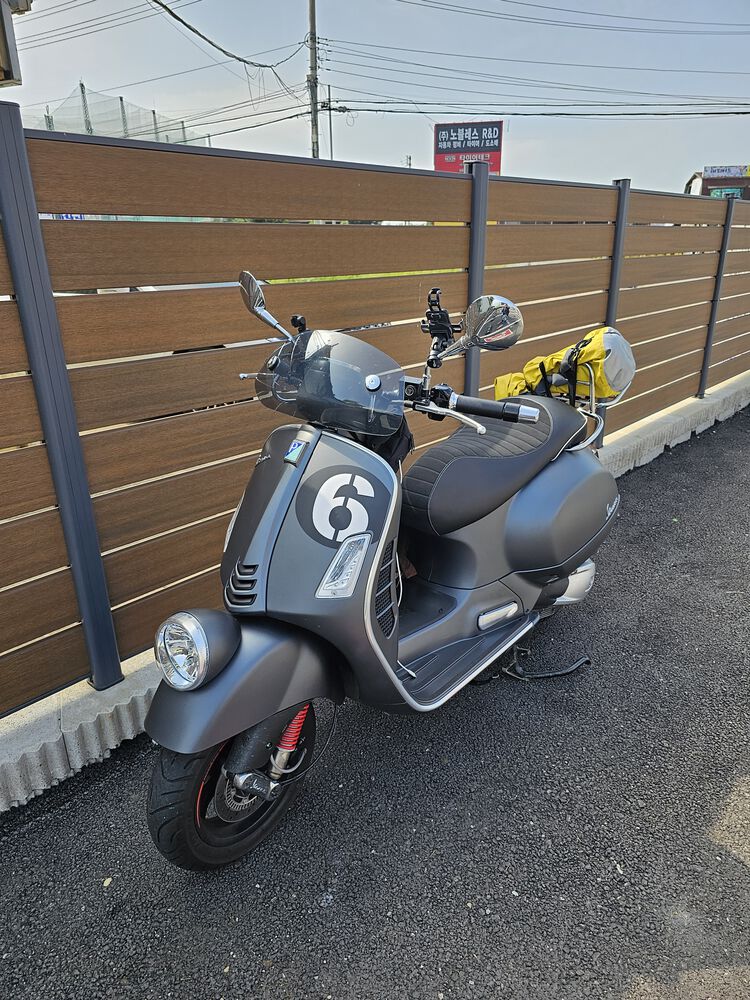

So as my speed goes up the error become by up to 9 km/h (I am an expat in Korea) it starts at around 4 then at around where the speedo indicates 100 km/h it is actually 91.
I know there are discs that can be replaced to make this more accurate with the manual gauge on the Sei Giorni II, but is this a warranty issue?
