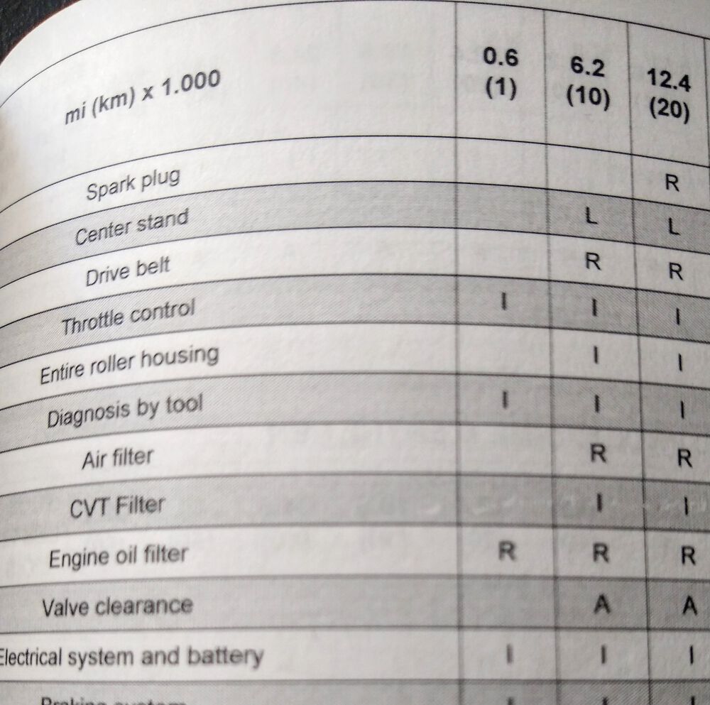

Owner's manual for the 2020 GTS300 HPE shows the valve clearance check interval to be 6.2 thousand miles, or 10,000 kilometers.
I think I read someplace (probably here) that earlier GTS300's had longer intervals for this service.
