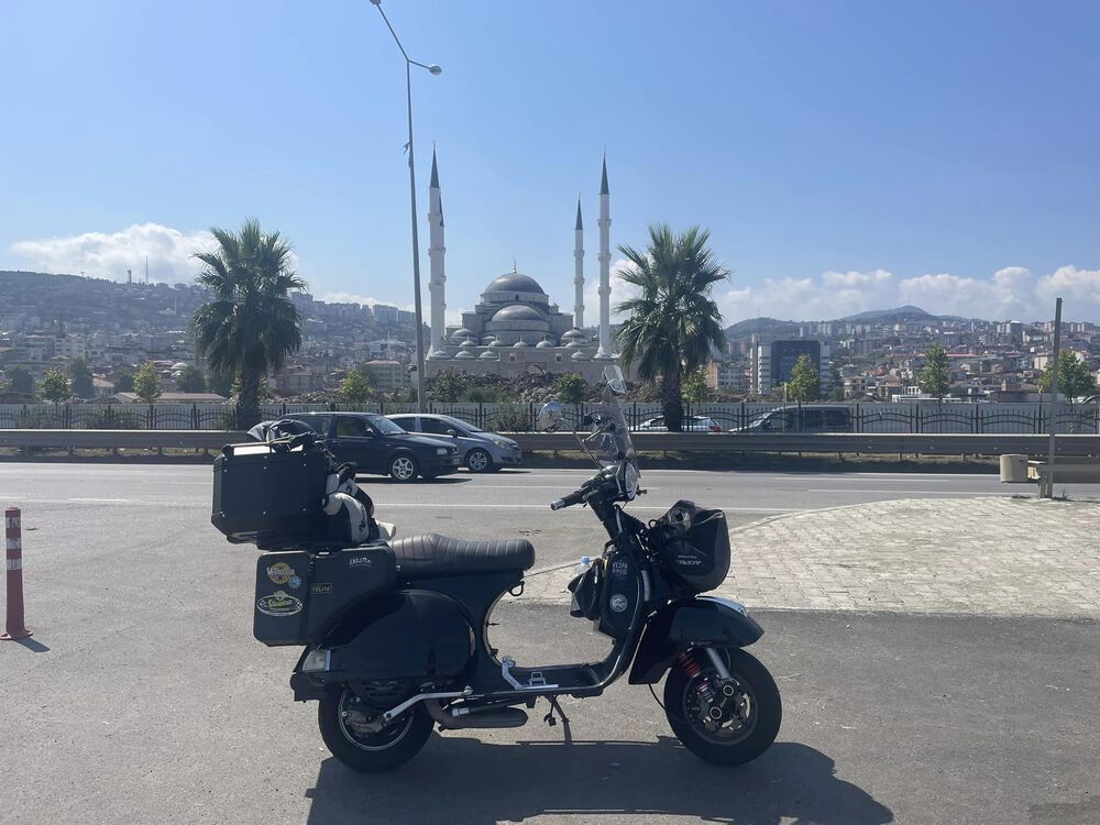

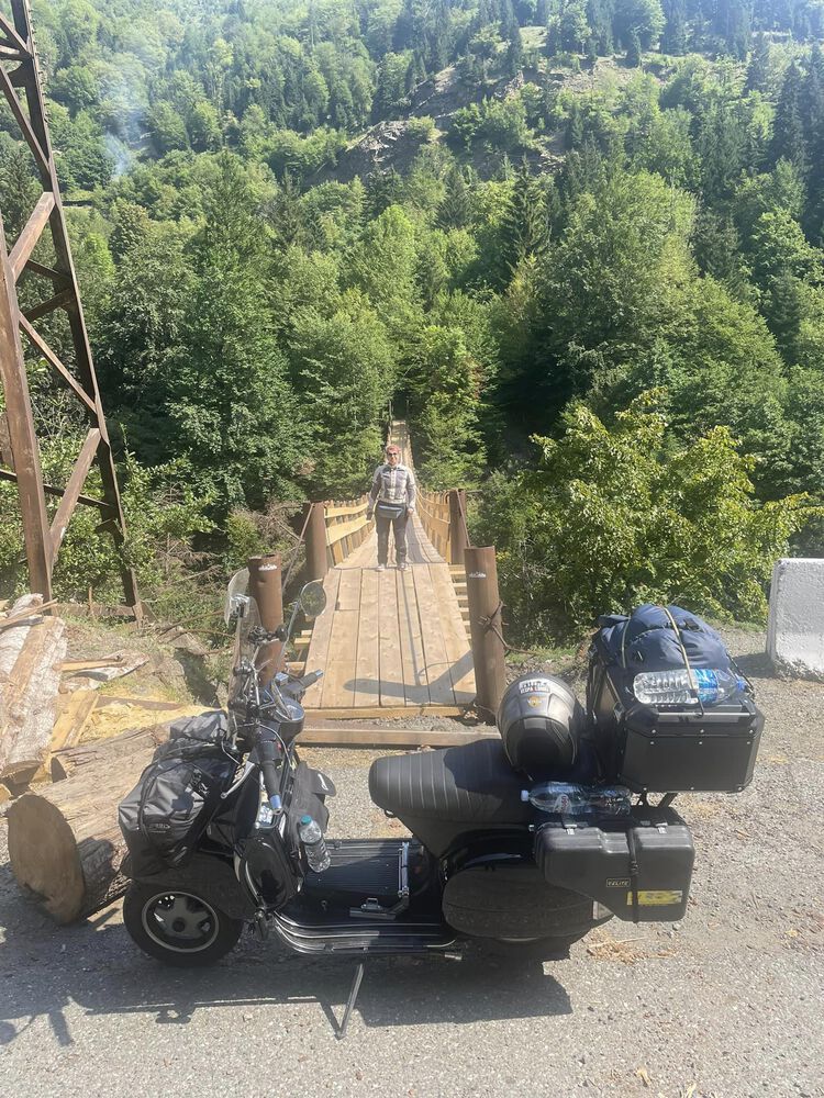

My friend Kostas (and parts supplier) is a long distance champ. Each year he visits different countries along with his wife. This year they traveled to Georgia and Turkey. A total of 4700Kms in 17 days. He runs a Malossi Sport on V-One cases, SIP 60 crank (new wedge type), a SIP Road 3 and a SI26 with the autolube connected. I think he's still on stock gearing. He used to run on 11" rims but whatever tire he tested disintegrated after 2k Kms. This year he went back to the proven K47 on 10" rims...
He's riding constantly at 100Km/h - 115Km/s...
He never had engine failures (only tires when he was on the 11" rims and two rear shocks)...
And his workhorse...

Thought you might be interested in my mileage (kilometreage if we're being technically correct!) last weekend. A number of us did a two-day ride based in a country town, meant to be 800km but I sheared a clutch key at about 500. Anyway it averaged out at 160km per tank (worked out on 7.5L per tank). Most of the time we were doing between 85-110km/h. I was fairly happy with that.
VR One cases, Malossi reed intake, PHBH 30 and Polini box exhaust.
That sounds like a good ride and pretty good gas mileage. Do you consider the woodruff shearing as a one off or are you thinking it's a weak point given the power and spin-up that your motor delivers? Do you think the SIP/BFA geared style crank and clutch are worth the extra spend?
@ginch avatar
Posts: 10365
@ginch avatar
Posts: 10365
I think the culprit was the condition of the roads, believe it or not! There were patches on patches and pothole after pothole. We were going uphill into a strong headwind. Craig crouched down and so did I... of course as you crouch down you tend to pull on the throttle and, usually less noticeable, the gear change. This time I suddenly found myself in third instead of 4th, at around 100km/h. That's where I think I did the damage. About 10 or 15 mins later it started to slip the clutch and I knew something was wrong. PS a sheared key in an Uncle Tom crank is much harder to dig out than the normal kind, x 10.
