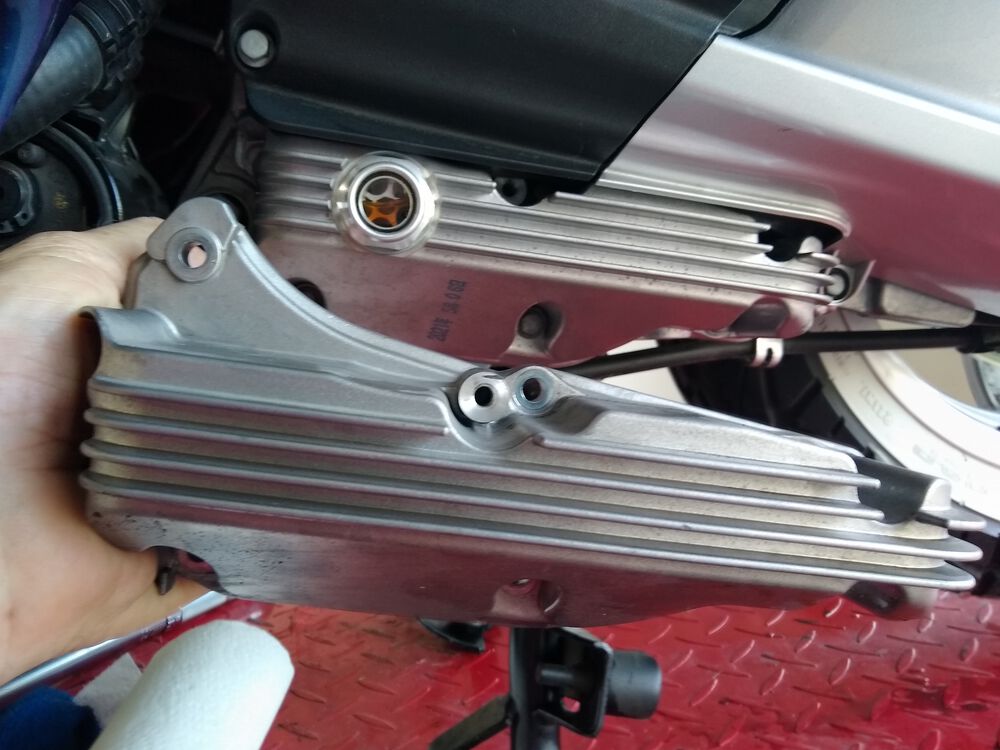

I was concerned about the possible oil consumption I had read that the 300 HPE's were prone to doing, especially when highway-ridden a lot like mine is.
To help with easy and often oil level checks, I opted to install the oil sight glass engine cover on my GTS to give me one less excuse to allow my bike's oil level to drop below spec.
It's almost certainly, IMO, one of the best and most sensible mods to make on this machine, and I know, yes, it should be standard equipment on these scooters, but it isn't.
At least it's not particularly expensive nor very difficult to install.
