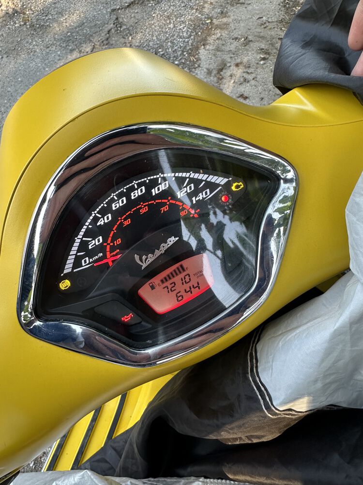

Gave my scooter a good wash yesterday and went for a quick ride after and all was fine. Started it up again later and was running very sluggishly, next to no throttle response and eventually cut out. Speedo was flickering around whilst idling too. Would turn over when starting but now left it overnight and won't even turn over. Dashboard lights now showing this (see attached - and they weren't showing this yesterday).
Surely must be electrical. Thought it just needed to dry out. Have I somehow killed the thing?!

Check the battery and blow out all the connectors and apply dielectric grease. Hope you didn't power wash it.

That's why I said to blow out the connectors. If you did you're probably going to have to do the headset as well as the rest of the bike. The bike is water resistant not water proof.

I had a 2009 LX150 that I aggressively washed one day and afterwards it refused to start. I had the dreaded blinking dash light and I thought that I somehow managed to ruin the thing.
Turned out that there was too much water in and around the key slot that fouled the wire antenna that the ignition uses to recognize the coded key. I left the bike out in direct sunlight and it all dried out and everything worked perfect once again. Lesson learned.

Interesting. Going to grab my master key in case that immo light is genuine and I need to re-pair my key. But will certainly have a look round the antenna itself for water. Thanks
ahh ... aren't those normal on a prima when the engine is not running?
Edit: Ignore this, i just noticed the immobiliser light. But rest are normal
