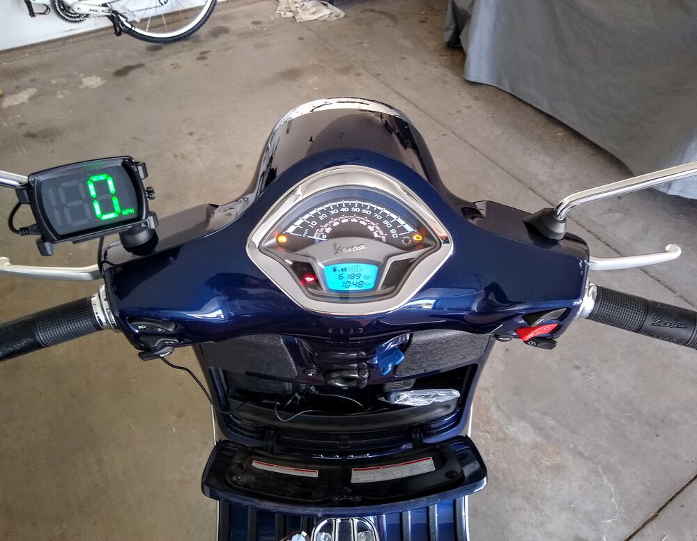

When I ordered my 6000 mile service kit (really DO need that new belt, ya know) from Scooterwest last week, I also had them send one of these nice mirror stem phone mounts with the idea that I would use it for that cheapo $15 digital GPS speedometer I bought last month, not that having a more accurate speedometer is a huge priority, but it would be nice to know what my speed actually is every now and then.
When it first arrived, I tried out the cheapo $15 GPS speedo in our Ford F-150, which as far as I can determine, is no more than 1 mph 'off' at normal highway speeds.
The $15 cheapo GPS speedo reads about 1.0-1.5 mph higher than the Ford's speedo, and 1.5-2.0 mph higher than my phone's GPS speedometer, so It's reasonable to say that, at it's worst, it's 2.0 mph higher than 'actual' at 70-75 mph.
In a perfect world, I would prefer zero error, of course, but 1.5-2.0 mph 'optimistic' isn't too bad, when considering that the vehicle's factory speedometer is 'off' 5.0 to 7.0 mph at the same actual speed.
The $15 digital speedometer feels like a cheap piece of crap, quite toy like, with a casing of brittle black plastic, and with it's weight that feels about the same as an unsalted soda cracker, it doesn't impress one as a particularly durable thing....but the damn thing works, for how long is anybody's guess, but it works...and, you know, $15? What's not to like?
The mirror stem phone mount is a quality item, mounts to the stem easily and seems secure. I had been trying to figure out an acceptable way to mount the cheapo GPS speedometer without resorting to gluing, adhesive mount Velcro, or anything that would involve applying anything to any painted surface of the bike. The mirror mount was $40, but as a well-designed and well-made problem-solver for my use, it was worth it. Altogether, a quite tidy solution for mounting stuff to my GTS, though I still need to figure out a neat power cord route from the 'cubby hole' to the unit.
For the cheapo speedometer, I will still need to modify it a little so that the phone mount can have a more secure grip on the speedos smooth, kind of oddly shaped case, but it shouldn't be a big problem.
Of course, I could just stick my phone into the holder and use It's GPS speedometer, but I'm not all that keen on having a phone staring at me all the time when I ride, and it's relatively large and heavy...and then there's the ever-present possibility that someone will call me, and when I'm riding any sort of motorbike, I'm in my own little world and 'off limits'.
I hope you have better luck with the mirror stem phone mount than I did.
I couldn't keep my mirrors tightened down with a phone mounted. I'm not sure if it was the extra weight causing vibrations or if it was wind resistance.
@jbacklund avatar
Posts: 2449
@jbacklund avatar
Posts: 2449
I probably won't use it to hold a phone very much, mostly that small and much lighter cheapo GPS speedo, which isn't nearly the barn door for wind resistance the phone would be.
If I mount the holder as close to the threaded end as possible, the wind would have limited leverage to loosen the mirror.
I'll just have to see how it goes though. Might work, might not.

I just subtract 5mph from indicated speed to get "close enough" around town.

Other posters are correct in pointing out that even GPS isn't 100% accurate for speeds. They are best in lateral position. Vertical position is not as good. And since we are riding in a 3-D world, the calculations are always a bit off. It's quite a bit of engineering to get positions of less 3m of accuracy, from a source in space! But to do it while on the move, that is even more difficult. There are GPS systems (think Trimble) that are accurate down to cm level, but I doubt they could maintain that level of accuracy while moving at 50 mph.
One way to test is to use the roadside radar guns that say "Your Speed Is: XX". They aren't exactly 100% accurate either, but they'll give you a good idea.
My iPhone 13 told me that when I am going an indicated 50 mph (another issue is parallax error with the analog speedometer), I am really only going 48 mph. I'm happy with this. 4% error at that speed is really good. My car is about that much off too. If it is going to be wrong, I'd rather the speedometer on the vehicle be a little optimistic. That might get you out of getting a ticket. I know it saved me a time or two in my car!
Oh, by the way, when your tires are at different pressures, the accuracy is affected. And if you get different tires, different brand or model tires, that'll affect it. And of course, if you choose different size tires, that will affect it. The manufacturers of motor vehicles are only required to provide a speedometer. There may be an ordinance requiring some % of accuracy, but maybe not.
