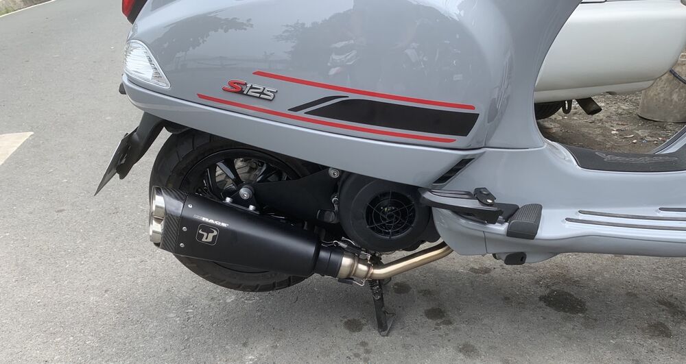

This is what I'm going to install, I hope it will just be a small adjustment needed incase it is not a plug n'play kit for my scoot.

Cool looks like Ixil

Thanks, it is ixil full exhaust. Is it iget model, the picture you showed?

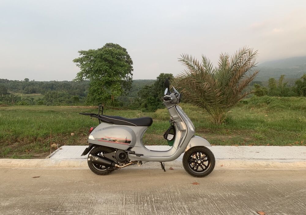

Installation was a success. Sprint 150, Primavera 150 and S125 iget 3V have exactly the same mount and size of compatible full exhaust.

Also, nice job monkey S125!

Thanks adri!
