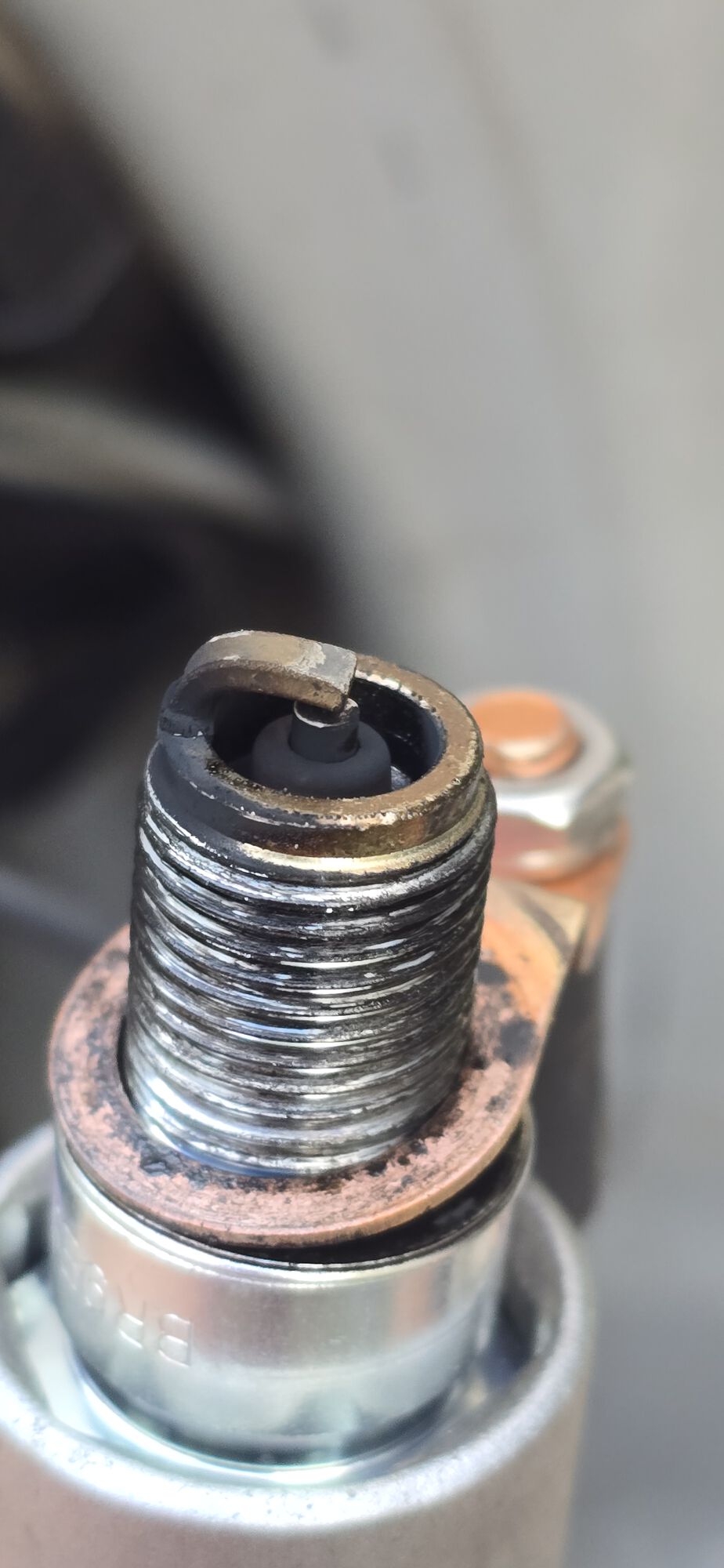

Thank you guys for information about your experiences with carb tuning. Unfortunately we have different setups so your solutions cannot be directly paste - copied into mine.
Looking at my spark plug I see that I'm running way too rich. Probaly on idle side (main side is leaner that suggested everywhere - 160/BE3/122). Unfortunately leaning idle even with adjusting the mixture screw do not have satisfactory effect on scoot behaviour during ride. On leaner idle jets there's no power, higher revs are very hard to be reached and richer main jet setup (i.e. 160/BE4/125) do not help to cover the idle leanless.
In summary when I'm too rich on idle side and to lean on main side the engine power response is the best for now (but still below expectations). And this is my main headache. Where did I made a mistake?
On these carbs, if the main stack is too lean, the pilot stack, once away from idle (progression), will also be too lean, even if the pilot jet is huge it will not compensate.
Everybody else has an AC140 fitted on the main stack. I suggest you try the same.

I've kept with 160 because undrilled filter. Just right now I installed new spark plug BR9ES (before was B8ES) and changed idle to 160/58, 2,5 turns out and also atomizer to 140. The result? In the low to middle range of revs starts good then a lot of sputtering and I could feel when main is becoming dominant. When this happens the power and revs increase very easily and then I can feel the power of this setup. It was 20 km ride, temp reached 154 C (320F). So I think the idle to be sorted. Spark looks as on the photo
