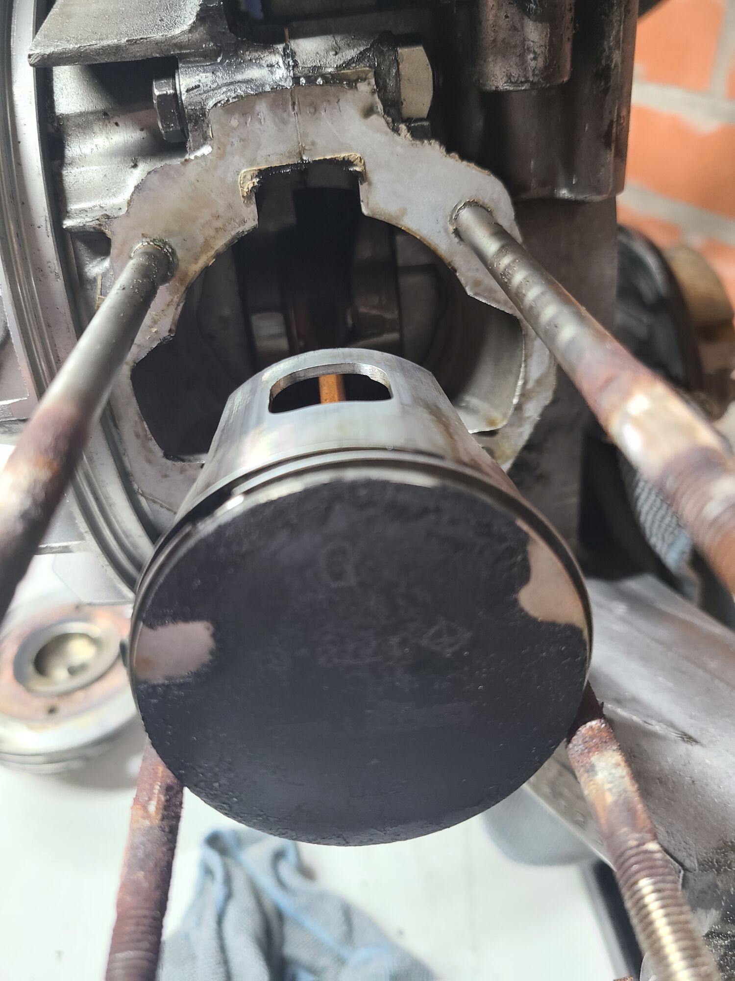

I've got a 2T LML 125 (aka Stella) which I use when I'm staying at my second home. It doesn't get much attention as I don't have the facilities over there to perform maintenance, but now it seems to be leaking more oil than usual so I'm going to haul it home in a few weeks and give it a good going-over.
While I've got it in bits I was thinking it might be time to make some "improvements". The current setup is this:
BGM 177 kit
57mm crank (not the original LML, Mazzy I think)
SIP Road 2 exhaust
Spaco SI 24 carb
Cosa clutch (can't remember the gearing, but it's low-geared which I need EDIT: clutch is 68/21)
My riding over there is exclusively 2-up and on twisty, hilly mountain roads mostly around 30mph max. The fastest I ever go is maybe 50 or 55mph, and then for only a very short time. Even with the low gearing, I occasionally need to select first gear on very steep hills.
So with this kind of riding in mind, I was thinking of getting the following to go with the existing BGM 177 kit:

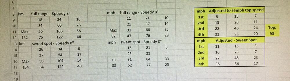

Spend ya moola on GEARING.
Play with the calculator, bring the gears closer together, specially 2-3-4.
As you have no need for 70mph+ then design it so 60mph is max revs/speed, so sweet spot in 4th is 42-55...
Here's a gearing setup, well worth a consideration before replacing good performance parts.
If you do go ahead and replace things that are still good, then post those bits to EBeth
Here's a gearing setup, well worth a consideration before replacing good performance parts. If you do go ahead and replace things that are still good, then post those bits to EBeth

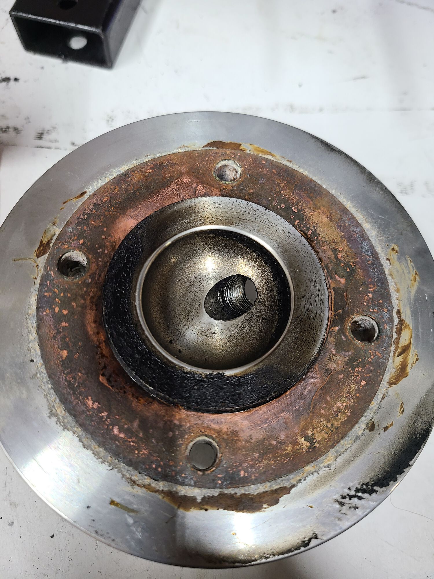

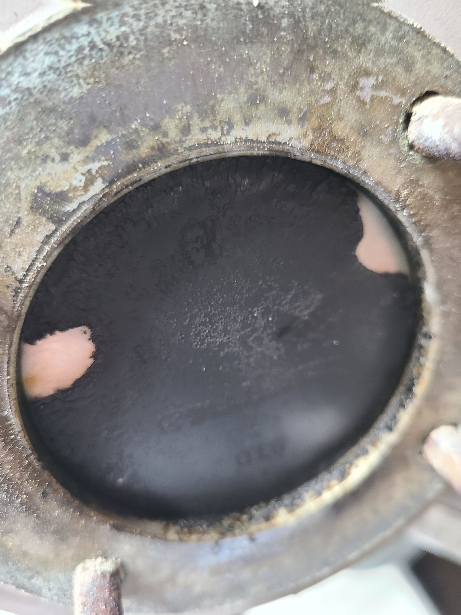

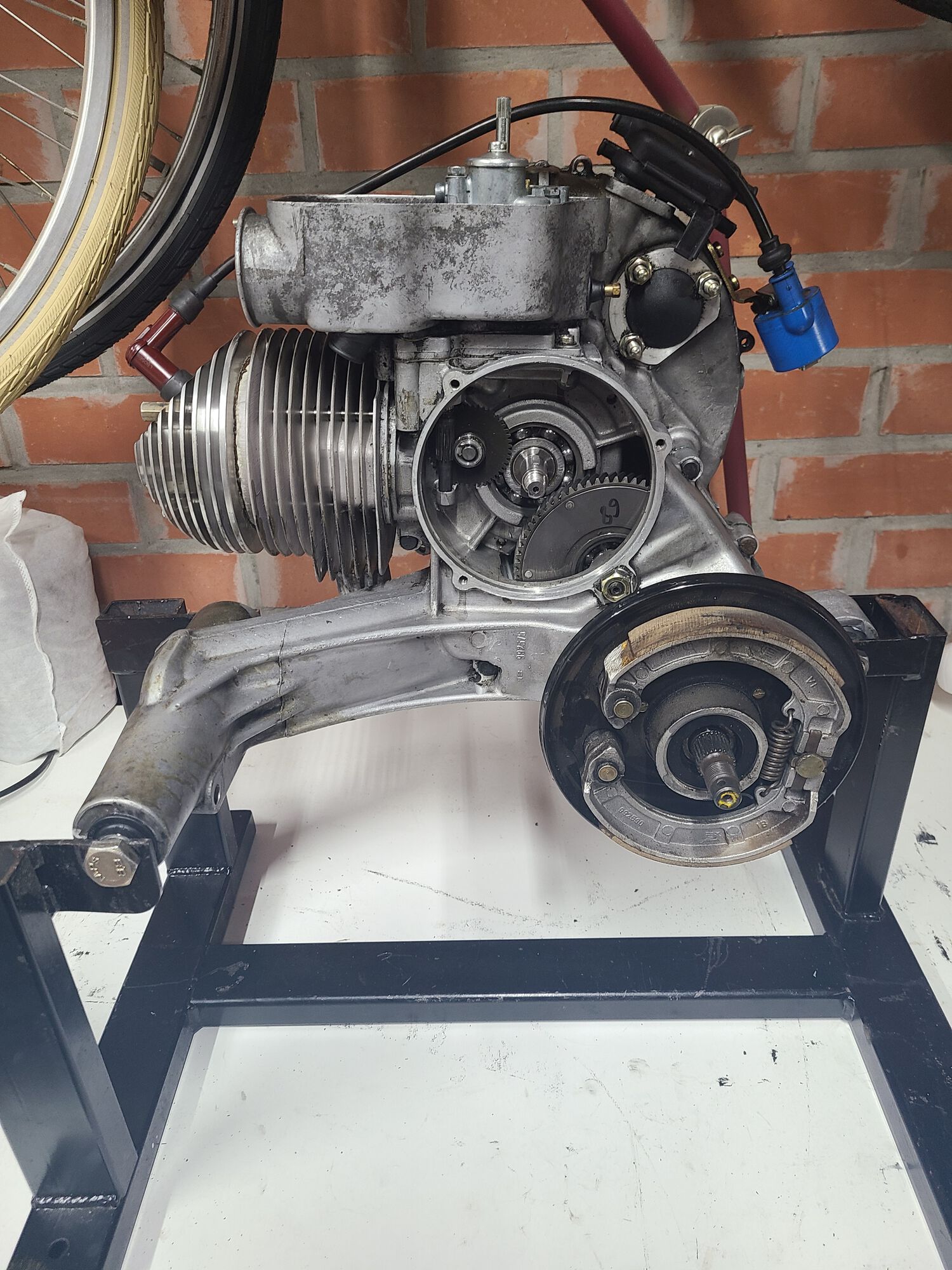

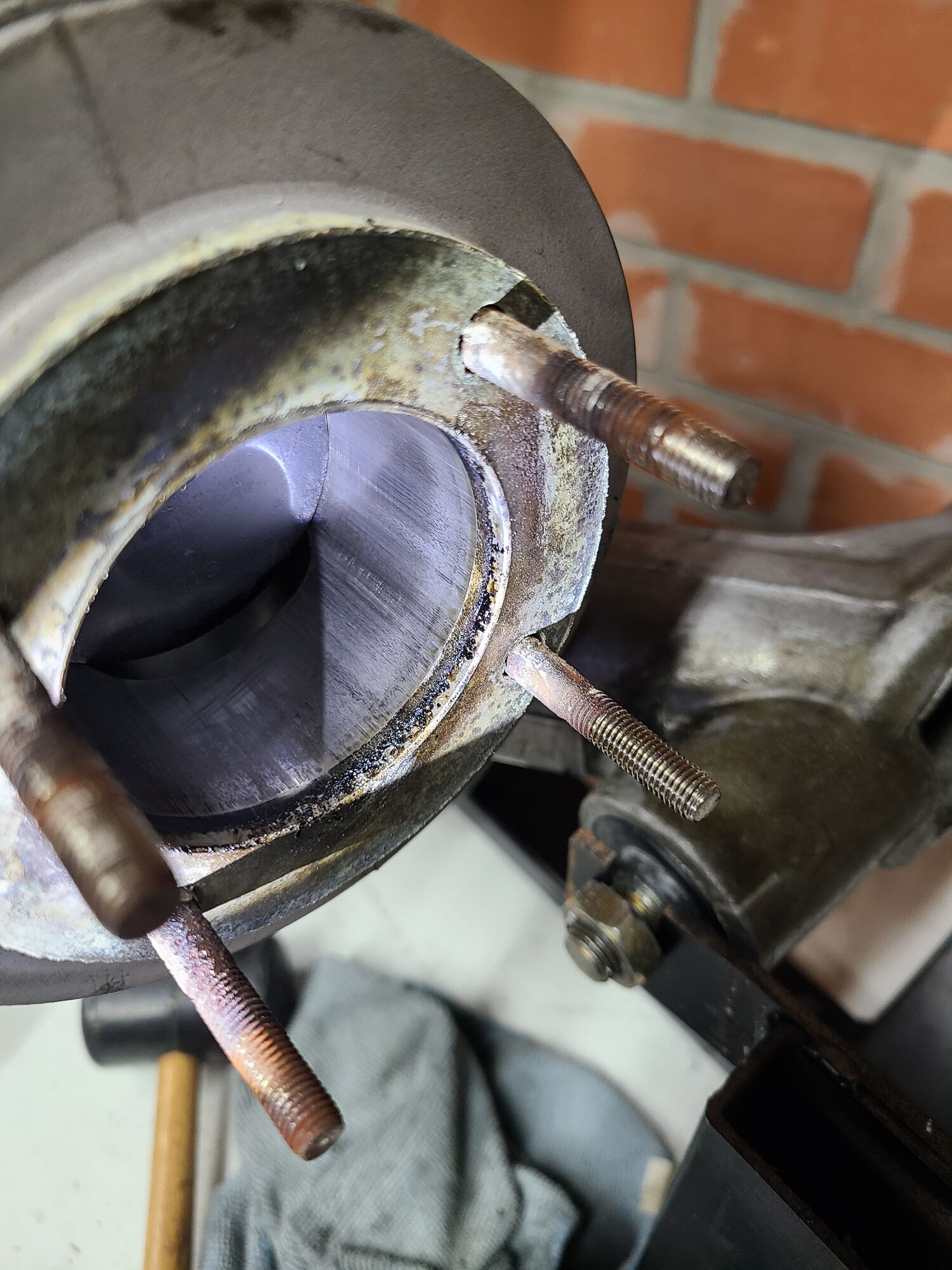

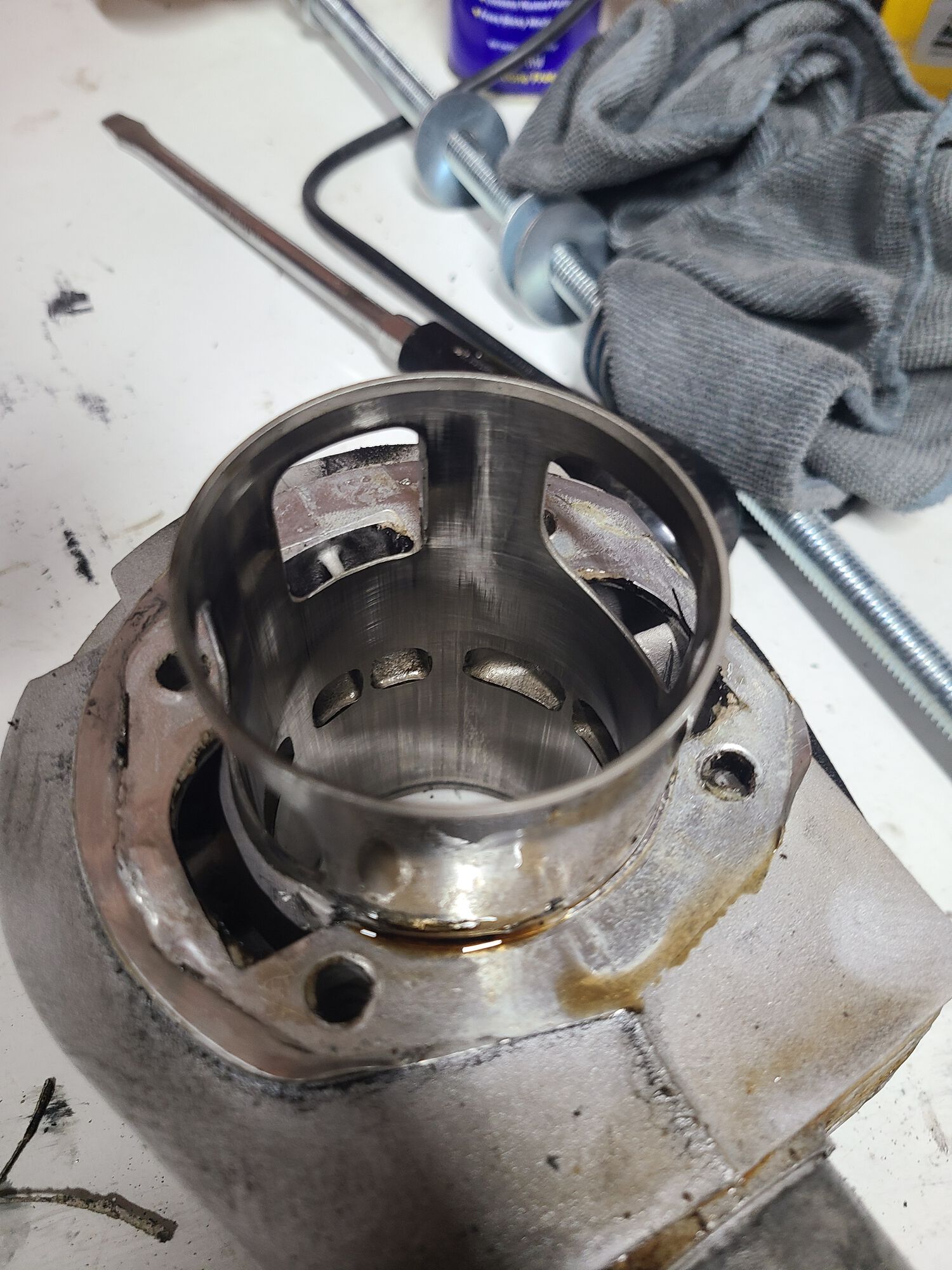

Finally got the engine out of the scooter over the weekend and took the opportunity to replace the mounts (see separate thread if interested - not a job I want to repeat in a hurry). Now I've got the engine on the bench I'll start stripping it down and rebuilding with the longer crank and a couple of other goodies I couldn't resist. Pics because, well, we like pics ...
The bench will not stay that tidy for long
BGM 177 head
BGM 177 head
Looking down the barrel ...
Grimy piston crown
Grimy piston crown
The money shot
The money shot
Barrel seems OK (no scoring that you can feel)
@108 avatar
V range 50s
Posts: 2413
@108 avatar
V range 50s
Posts: 2413
Running rich it seems from the piston.
Any idea how many kms the piston has done since it was clean?
Did you measure your squish when it was built?
The cylinder walls ring and piston marks and your copper head gasket suggest the squish was bigger than 1.3-1.6mm.
