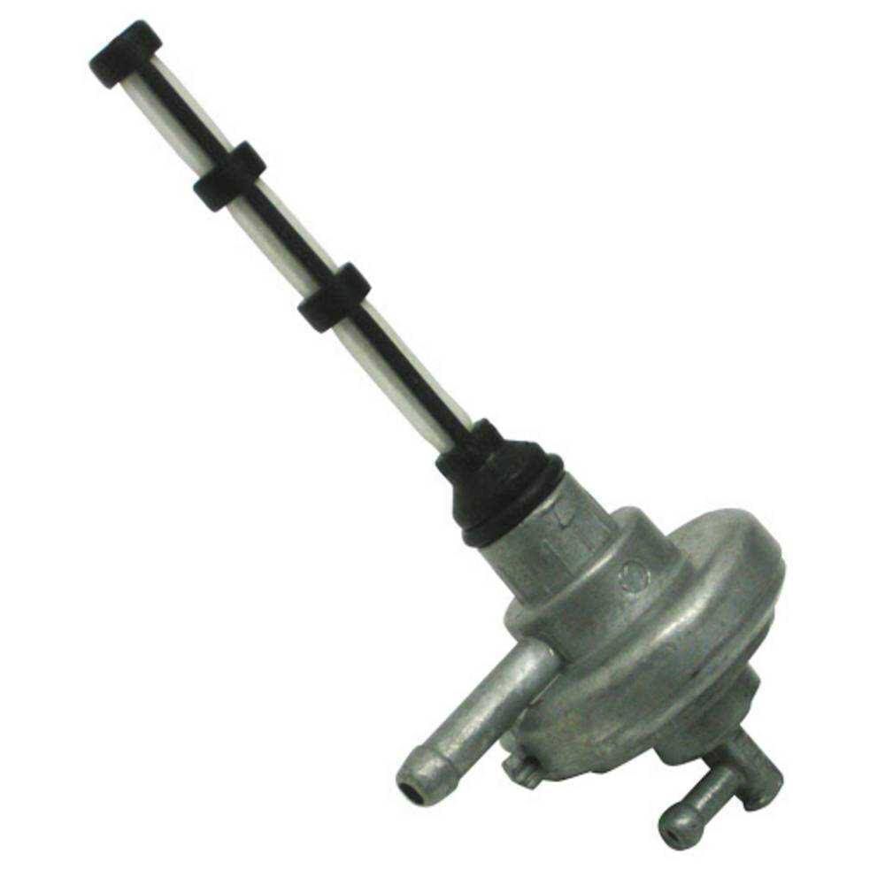

My lx50 2t started flooding itself on startup and the fuel tap is leaking.
My vespa uses a fuel tap with 2 poles, top for fuel, bottom for air but when looking online for a new part all I'm seeing is this one with what looks like only a fuel line on top and a black ring on the bottom like this
https://www.sip-scootershop.com/en/product/fuel-tap-piaggio_PI575321
What one is right for my model, should I just get one like what I have because I know where the air line goes or not?
I'd also like to change my fuel, air and 2T oil pipes so what size and diameter should I get.
Thanks

That's the tap thats in my bike
Posts: 45144
Posts: 45144
Lower down on that page is the one you want:
https://www.sip-scootershop.com/en/product/fuel-tap-rms_14455100
I think the one you're looking at is a manual tap.

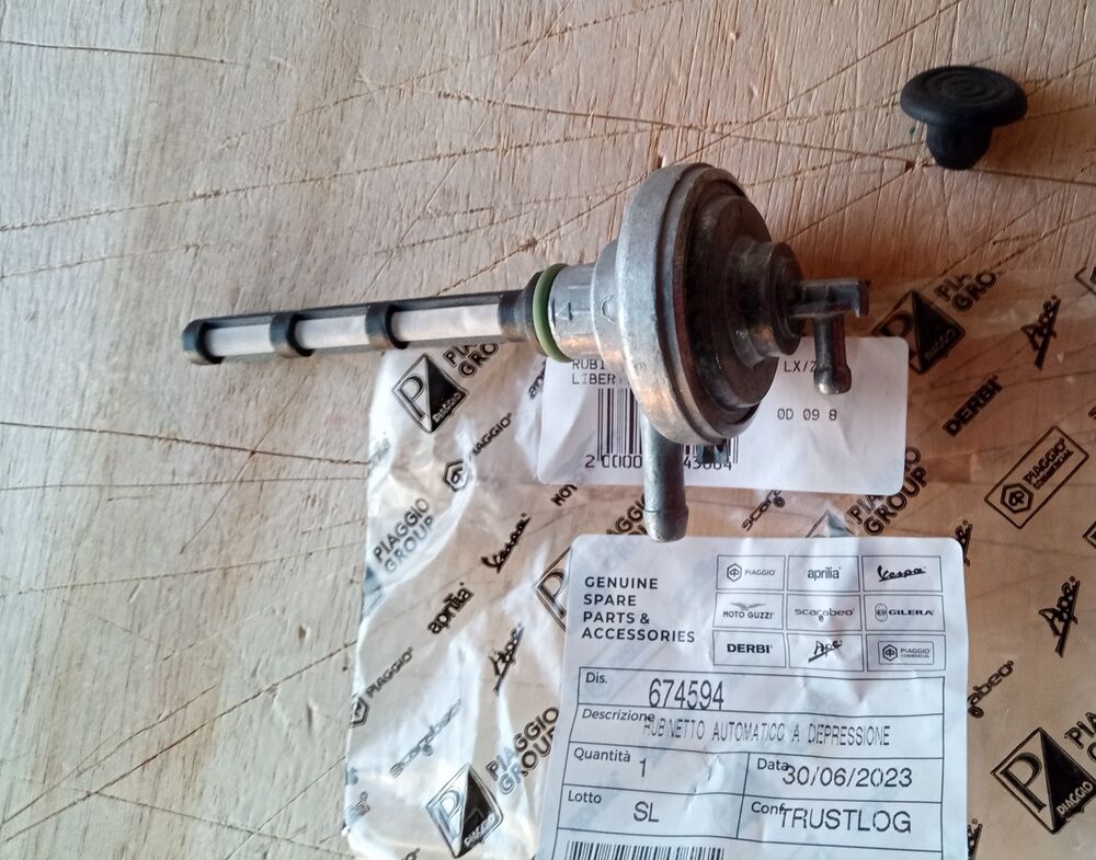

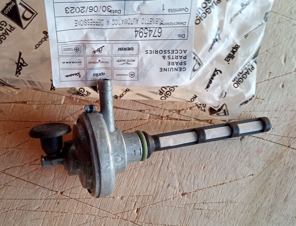

Posts: 9343
Location: Main Street, Watts
Posts: 9343
The little black thing comes off and you install the vacuum line.
Before
Before
After
After
