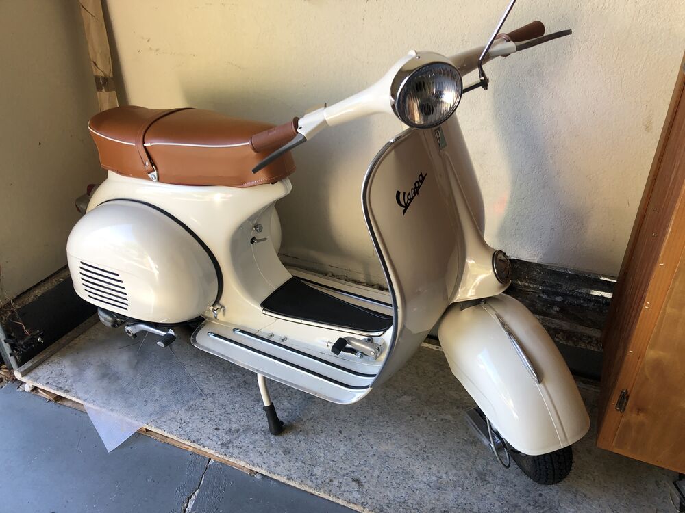

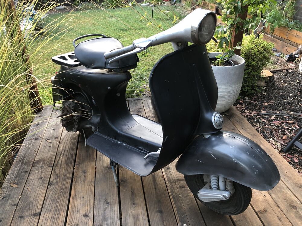

I've included my before and after photos. Frustrating at times but I had the biggest smile when I took my first ride! I'll call out that the scooter must have been involved in an accident since I had to replace the fork and (painfully) cut the front mudguard since it was rubbing the frame.

Before
Before
After
After

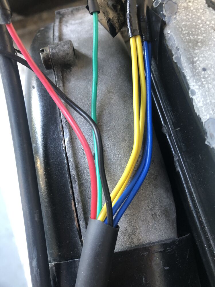

VBB wiring harness
VBB wiring harness

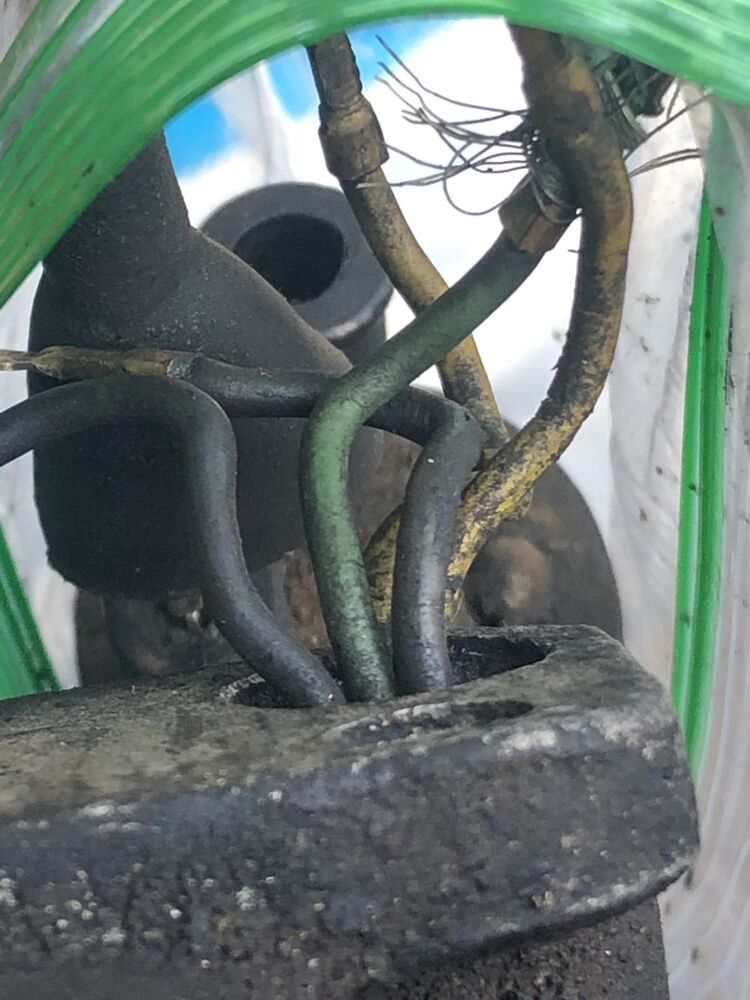

Wires from stator (double yellow, green, black and purple)

You need a VBB/Sprint stator.
I would give SM a call and pick that part up. they can walk you through it.

With a double yellow you could go this way:
Convert your 70's US Vespa to No Battery 12V AC
But there will need to be other modifications to the harness if it is a balanced ac bike (brake switch, maybe more)
