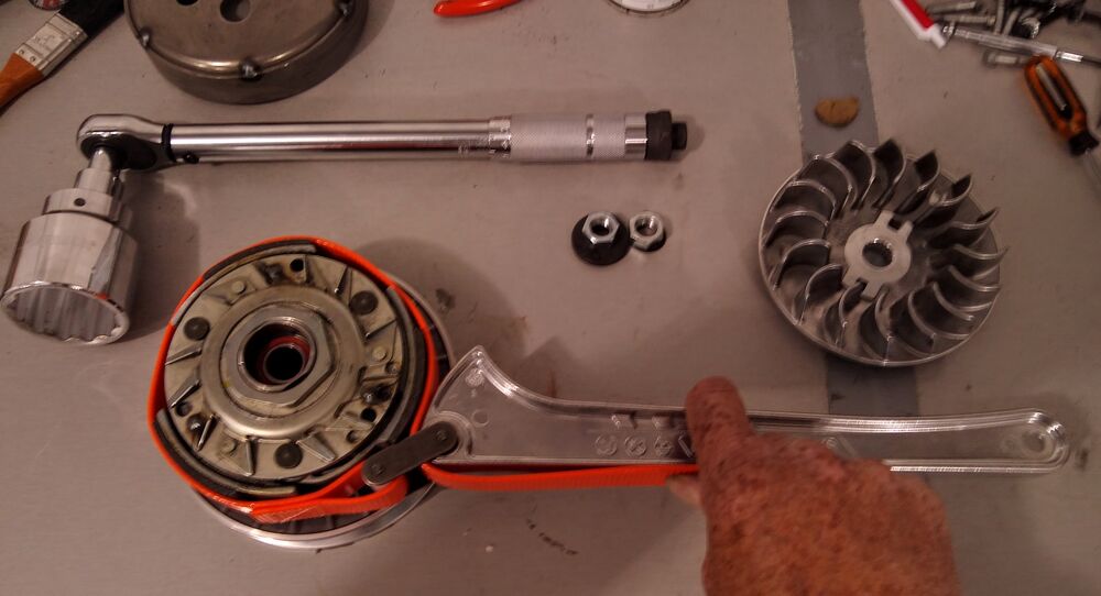

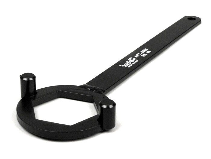

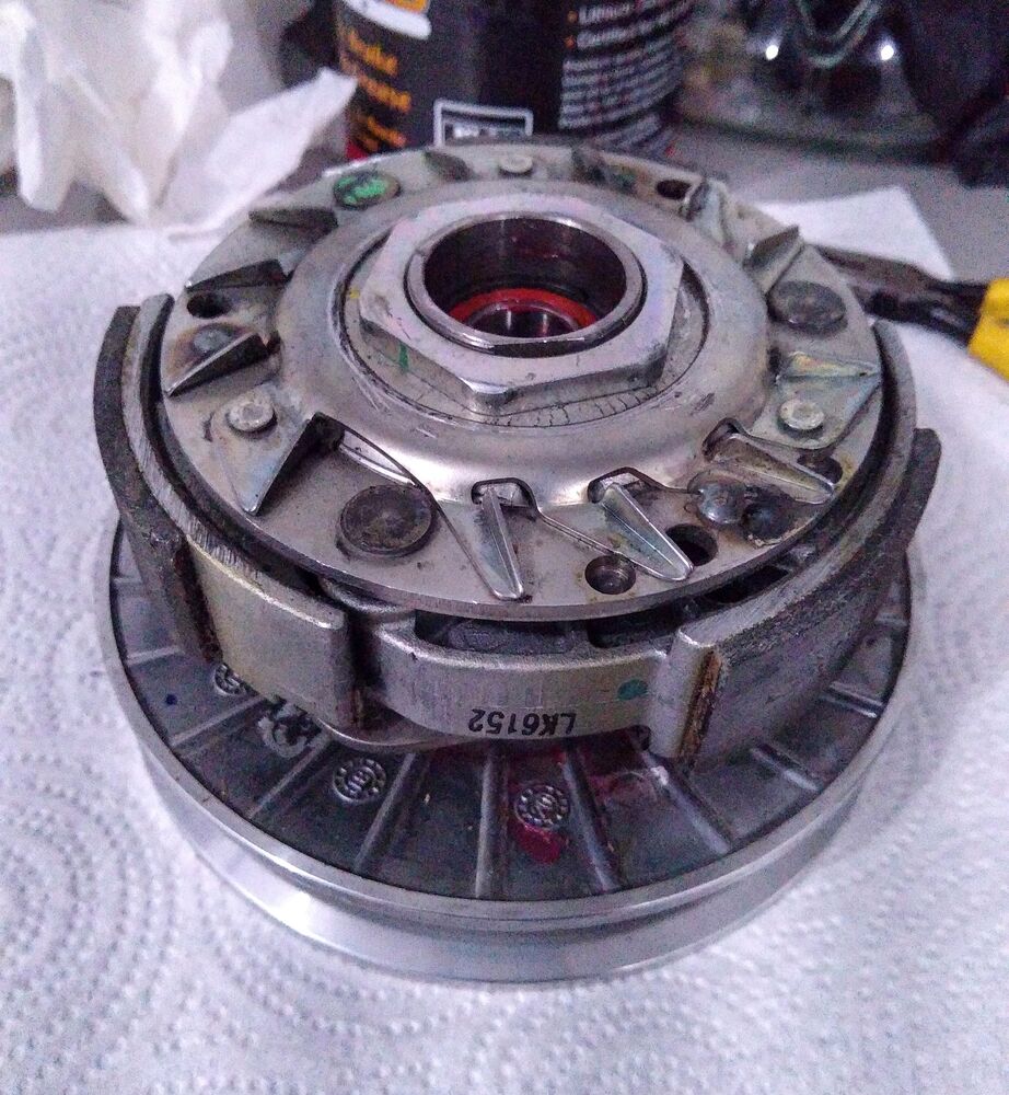

Well, the only thing keeping me from getting the transmission back together and riding the thing around now, is getting that clutch nut torqued back to 60 pounds, which has become the main, and only, remaining glitch in being able to finish this up.
No matter what I do, the clutch assembly will start to spin as the torque wrench is applied to the nut at the higher numbers, though being a click type of wrench, I don't know how close it is getting to 60 before things go awry.
I don't dare just get the nut as tight as I can and call it good enough. I want it to be spec'd where it's supposed to be.
My impact wrench is great for removing the nut, but it's way too powerful to be used putting it back on, as it can hammer things at 250 pounds of torque, and as far as I know, there's no way to adjust it down.
I'll update the situation if I can resolve this.

A strap wrench might prove useful, and not very expensive.

I'd give it a couple seconds blap with the impact.
Just watch how much it turns the nut.
If it goes ~10-20 degrees you're fine.
If it spins around, well, that was a bad idea.
I had considered that, and I'm on my way to the hardware store now to see if I can find a stickier rubber mat to maybe help hold the clutch down enough to get the torque I need on it.
I'm taking the clutch assembly with me to the store to help the guys (girls?) there visualize what I'm trying to do with it.
I'll check out a strap wrench while there too.

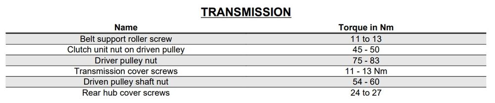

where are you pulling that 60 number from?
I was under the impression that it was lower than that-- 45~50, are you sure that you're not conflating parts or NM for lb/ft?
either way, red loctite.

Both the variator assembly nut and the clutch assembly nut should be torqued to 60 foot pounds according to Robot's video, which is about 45 Newton Meters.
I didn't use loctite on either nuts, but will definitely use it next time, however, both nuts are now on there with the correct 60 pounds of torque.
I got lucky in my trip to the hardware store this afternoon, and bought a rather large strap wrench that allowed Trixie to hold the clutch assembly secure enough to keep it from turning on the bench while I went all Neanderthal with my torque wrench and heard that coveted 'click' as 60 pounds was FINALLY reached.
That particular 'click' cost me $34 to get, but that strap wrench will almost certainly come in handy for any future GTS tranny teardowns.

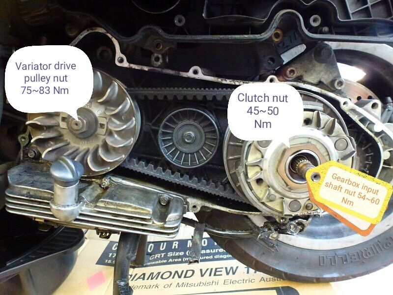

45nm = 33ftlbs <-- think you want this one
60ftlbs = 81nm
60ftlbs = 81nm
I wonder why Robot said 45nm equalled 60 lbs?
Oh, well, I put them at 60 pounds, and I know that's correct.
45 lb/ft is about 60 nm
Yes, but 60 lb/ft is not 45nm.
As Robot was about to torque the variator bolt at 60 lb/ft, he said (paraphrasing) "or 45 nm"...though while he was about to torque the clutch shaft nut afterward, he clarified that he may not have stated the nm number correctly for the variator nut.
This is what confused me about the correct torque values for these nuts for a bit.
I did torque both the variator and clutch assembly nuts at 60 lb/ft, and will torque the smaller clutch shaft nut at 45 lb/ft.

JBacklund wrote:
As Robot was about to torque the variator bolt at 60 lb/ft, he said (paraphrasing)or 45 nm...though while he was about to torque the clutch shaft nut afterward, he clarified that he may not have stated the nm number correctly for the variator nut.
which is why I gave you a snip from the manual

Well, it appears that I may have my Vespa back, and although they MAY prove to be premature, I will cheerfully accept congratulations on my (hopeful) victory over the unfortunate and untimely total discombobulation of my GTS's drive belt and my trials, tribulations, aggravations, and expense in correcting the matter.
Late this afternoon, I 'buttoned up' the drive case, lowered and then pushed my Vespa off of the lift table that's been it's home for just about the entire past month, started it's motor, and when I rotated the throttle, it smoothly and quietly engaged that new belt and was rolling out of our driveway and down the street.
As the clutch engaged, it seemed to do so smoother than it did before the belt gave out. I suppose all those new bits, rollers, perfect new belt on perfect pulleys should make a noticable improvement in things.
I rode it around our neighborhood for the better part of a mile, then a short stretch of the main road that passes behind our house at a speed of up to fifty mph, and it performed perfectly. For this short trial run, I tossed caution to the wind, and didn't wear a helmet or earplugs so that I could hear if anything weird was going on down there in centrifugal transmission voodoo-land, but it continued to operate silently and smoothly.
Tomorrow morning, I'll take another, longer shakedown ride and see how things go, but miracle of miracles, I may have fixed my scooter...thanks to all the help, advice, and encouragement from the MV peanut gallery and Robot's excellent service and repair videos.
