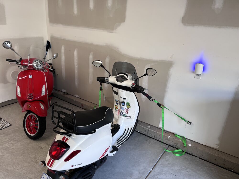

I'm thinking that I used to do my own maintenance so my plan is to make a work platform for the scoot as it will be easier to work on.
Plans are made and some reality is setting in. How am I going to get the scoot up the ramp and secure it to the platform?
Forging ahead I feel I'll make a simple wheel chock out of wood. Prototype 1 didn't work, back to Lowe's and a a placed a call to my buddy. He said just get some 3/8" eye bolts and screw it into the studs.

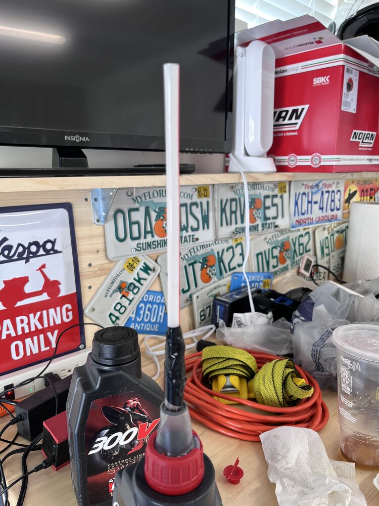

Okay. Got my scoot secured. Slide the oil catching pan under the scoot, NOPE. It hits on the pipe and I need to raise the rear tire. Screwed 2, 2x4's together and now I can access the oil drain plug and filter. Oil change is horrible as no funnel can fit the tiny holes for the engine and hub oil. Figured that out with redneck engineering.

Straw from McDonald's for the hub oil

Edit: Your straw idea for the oil is great! Will definitely keep that in mind if I need to top up my oil.
