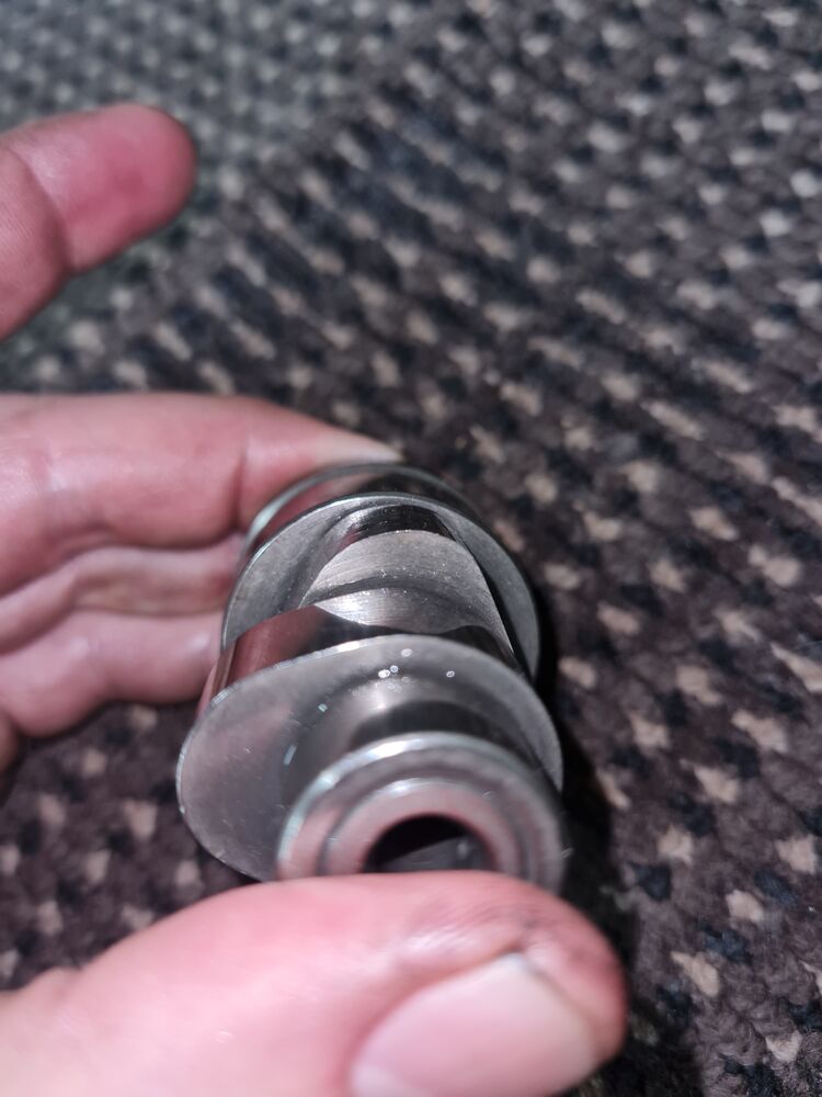

Hey All. So took the cam and rockers out I think they look acceptable?
However I suspect my timing chain needs changing, Is the adjustor in the image all the way out ? I am not sure how it works so dont want to open it Facepalm emoticon
Vespa GTS 300 SS
Posts: 5
Location: Norway
Vespa GTS 300 SS
Posts: 5
Location: Norway
I think the valve lifter looks questionable. I would have exchange the one in the picture. Measure how far the tensioner is out; I believes it should not be more than about 2 cm. Can't figure out that the register chain should make a knocking sound? Could it be the crankshaft?
Posts: 12937
Posts: 12937
Rockers look toast, cam is pretty dicey, IMO. I'd replace all of them.
I think tensioner position determines chain replacement? If it was all the way down, definitely. Unfortunately tends to slip when removed. Whatever you do, remember to retract it when reinstalling!

Thanks Guys so much.
My mechanic swears the second hand cam and rockers he replaced 30 kms ago where clean, and that the motor is eating cams and rockers...
He mentioned I should remove the head and check the oil gallery, which I have just done, Was really hoping it was blocked, but blew it out with air and it seems clean.
Looks like this is the only channel ?

Mine seemed to go the same way. Looked passable on inspection last fall, reinstalled and a couple hundred miles later started clattering. Runs fine atm but still a bit nervous.
@greasy125 avatar
Posts: 15122
@greasy125 avatar
Posts: 15122
yeah man, those rockers are toast.
I'd replace along with the cam.
it's unlikely the timing chain has stretched. the adjuster default position is fully extended due to the spring tensioner- so when you pull it off it goes full extension.

Agreed. Paying school fees here...
However a friend has these for free, might be worth a test ?
Check the alignment pic though looks weird ?
The part look very good. The alignment is a bit strange, but if the rockers feels thigt after adjustment; try it !
Posts: 12937
Posts: 12937
Doesn't look quite right to me, but you can always try an assembly to be sure.

Thanks Guys, Did some more research looks like it's a 250 cam and rockers, will be getting some fresh parts and be done with this thing 😂
