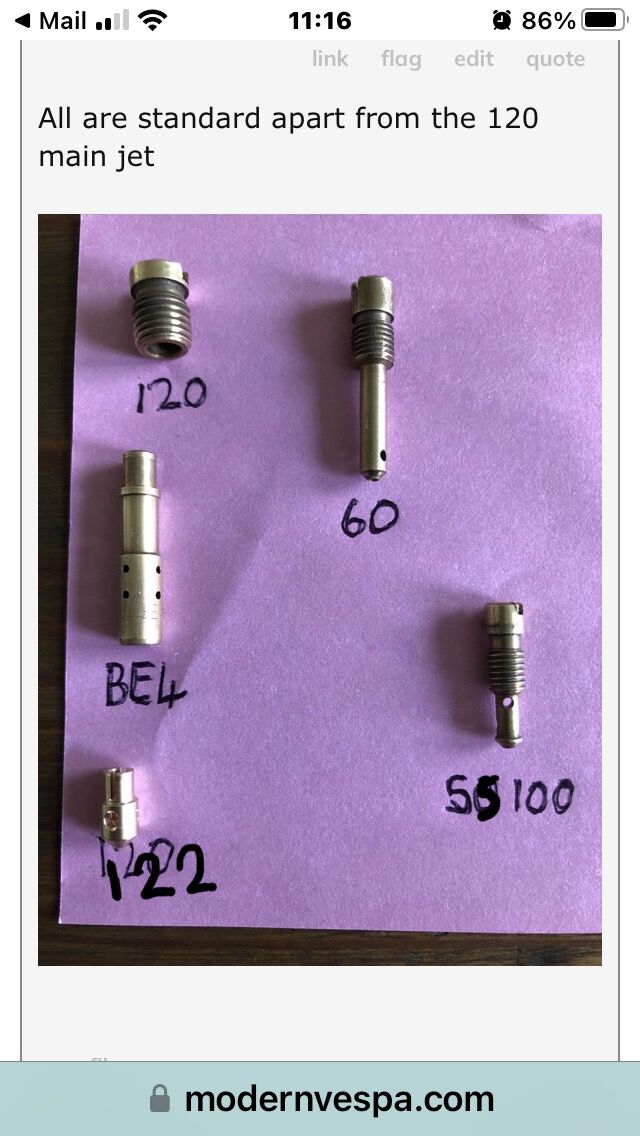

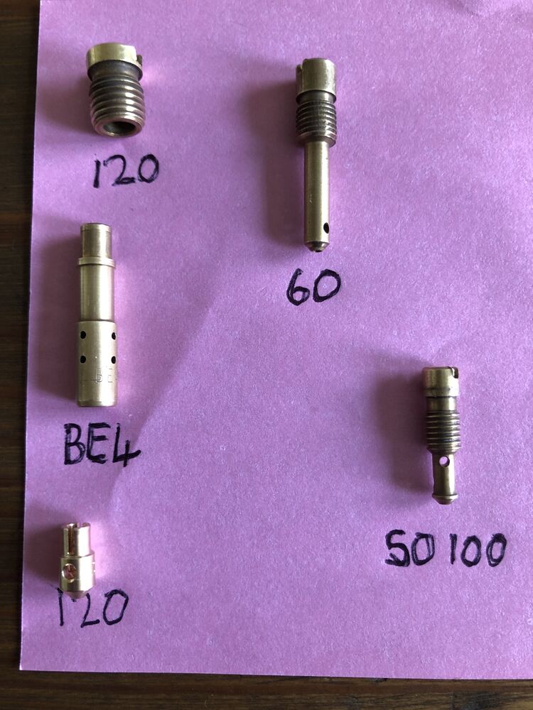

All are standard apart from the 120 main jet

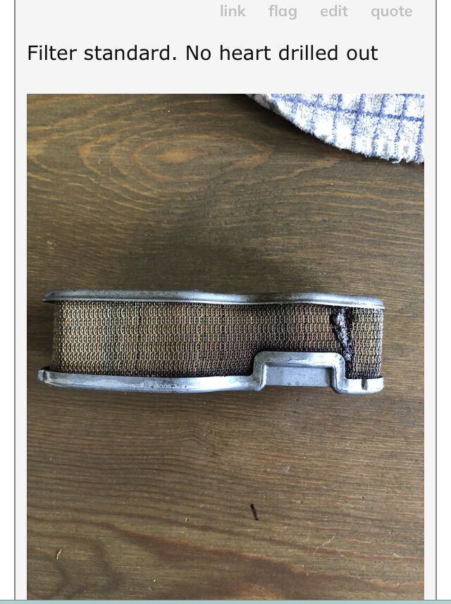

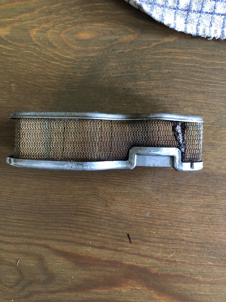

Filter standard. No heart drilled out

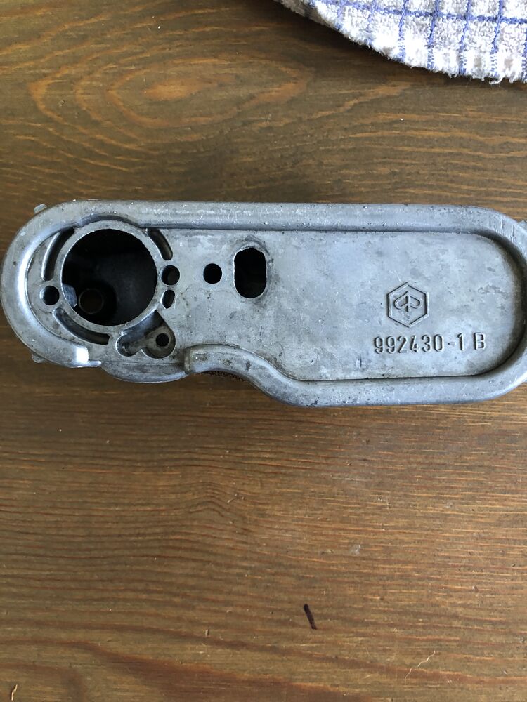

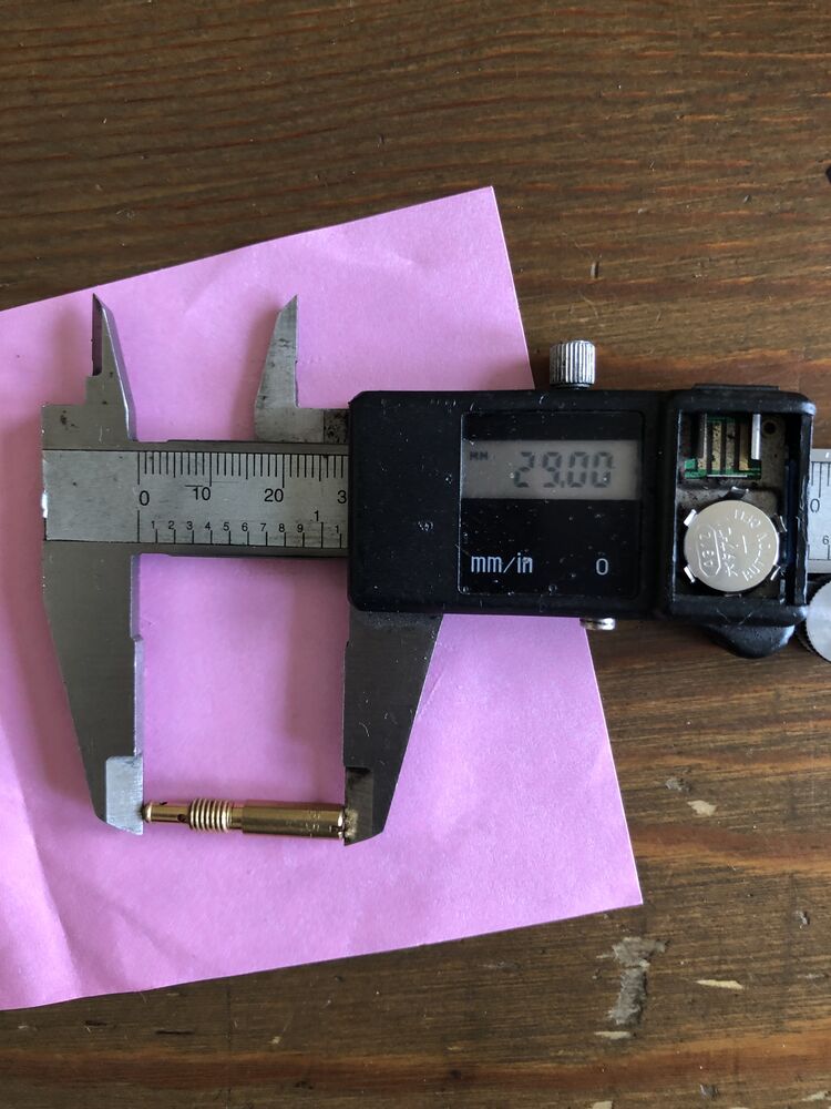

The little jet 50/100 needs to be a 55/100. Problem is they don't sell them anywhere that I know of.
If you buy one of these
https://beedspeed.com/products/carburettor-jet-dellorto-9892-long-idle-jet?variant=10568184856619
And cut 9 mm from the top and saw in a new screwdriver slot, it will work.
Edit: That filter is drilled. The un-drilled ones have no holes in the heart area.
I found one in my old bits but I will see if it's the same size later

Can see the 55 but not the 100. If it's a 55/160 it will be worse than the 50/100.
If it is a 55/100 then great 👍

it's a 55/100. I have cut it to the size you said and went out for a ride. I video it with better audio. I will upload it soon.

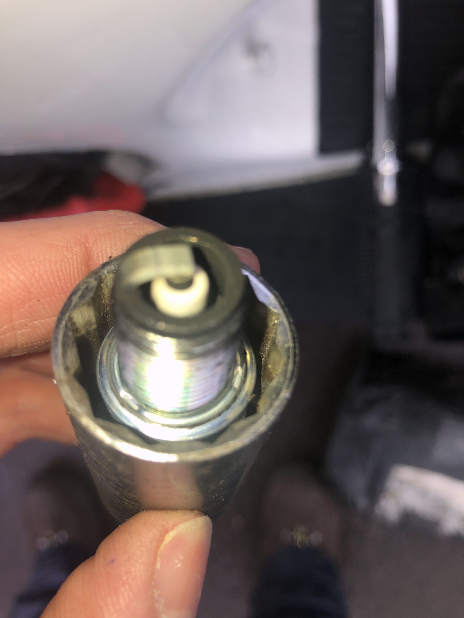

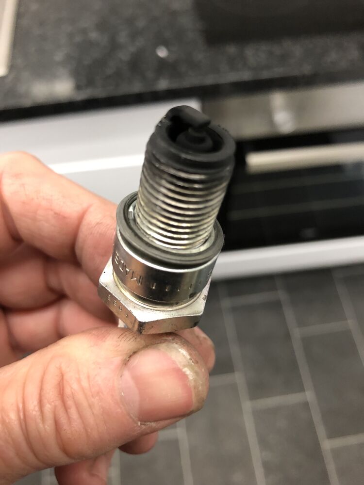

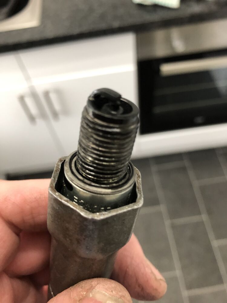

After putting the tank back it wouldnt start. I tested the spark plug and found it was no good. Thats two plugs ive used in the last two week.
I had another plug and put that in and it started so i went on a test run.
Main jet changed to a 122.
After the traffice light and not long after turning left I put it into full throttle in 2rd.
I did the same in the same places two times in the video.

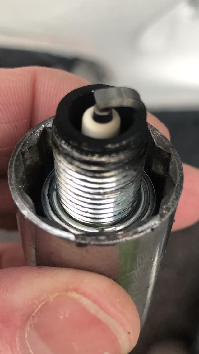

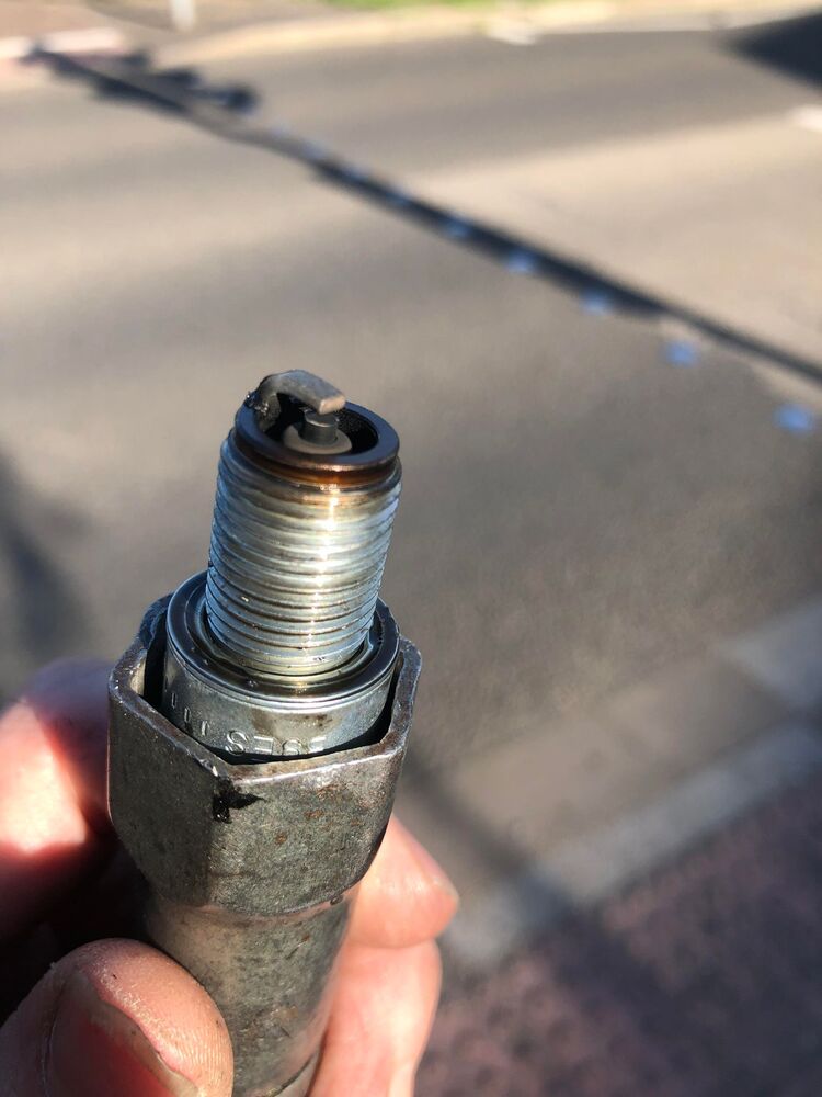

That's the colour of the plug after riding around town for 25 minutes. BR8ES. 122 main jet
Jet Eye Master
PX221 MHR heavily tuned, PX200 O tuned, PX181 M1XL tuned, PX166 tuned a bit and some motorbikes
Posts: 5113
Location: London UK
Jet Eye Master
Posts: 5113
Location: London UK
Its clearly too rich on 122mj but did you try 125mj? Which jet size makes it full splutter decides what to do next.

125 jet full throttle in 2rd.
I cut the vidoe down.
I hold up to figgers when i do it the first time full throttle in 2rd then i do it not long after when i turn left.
Sound is low. The lens with the mic muffer have broke so i have to use another one.
It ran crap with the 125 jet in it.
⚠️ Last edited by shepys on UTC; edited 1 time

Spark plug after the test ride with a 125 jet
Jet Eye Master
Posts: 5113
Location: London UK
Jet Eye Master
Posts: 5113
Location: London UK
Well that confirms it. Your mj should be 120 at the most. Try 118 and suddenly open the throttle full, as the power starts pulling. See how it feels. If it bogs (pauses before going) it might need bigger or a different atomiser.
