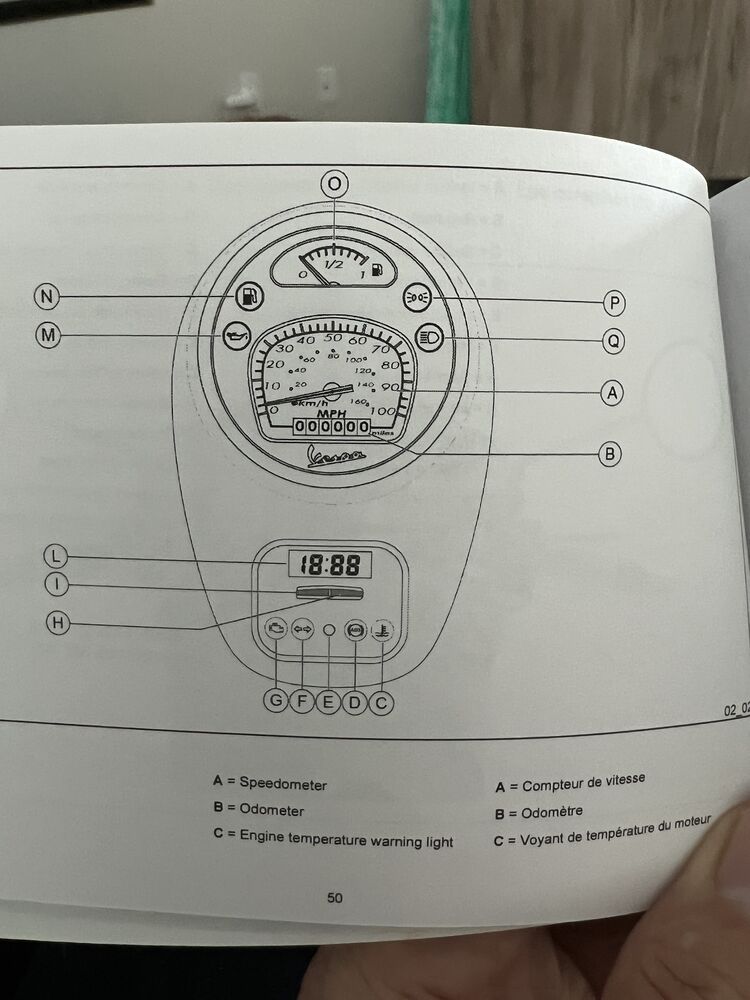

Light G is called Engine control warning light.
Yesterday, rode 75 miles to lunch with Vespa Ft Meyers club to Everglades City. Fun ride and good lunch. We fueled up and rode home on a 60-65 mph highway.
I noticed light G was on. It was on but dim. I see now just after starting it is bright.

One thing is strange: you say: "light G was on. It was on but dim".
A light should be bright on (like when you switch on the ignition upto a few seconds after starting the engine), or not on, but not dim. Dim could point to a problem in the electrical circuit somewhere. (you are sure it cannot have been a reflection of the sun on the dash?)
I think it is safe to drive the scooter, since the engine control warning light did not kept lit after starting the engine. Meaning whatever error there may have been it is no longer present now.

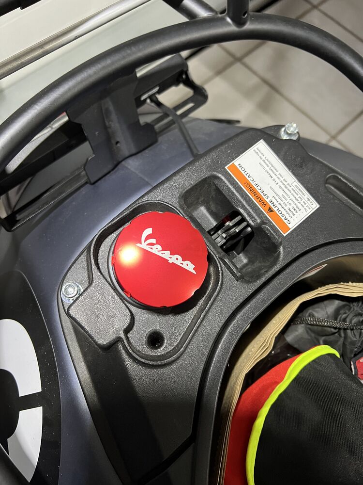

The light came on shortly after you fueled up. I bet you overfilled and clogged the EVAP system. This is very easy to do and if you are like me happens half of the time. If this is the case the light will go away in a few days once it dries out. If you put a code reader on it it will throw a code about the O2 sensor. It may run a little rough till the light goes out because the EVAP system also vents to the exhaust side of the motor before the O2 sensor. When the sensor see this it thinks the motor is running too rich (throws a O2 code)and tells the ECU to send less fuel causing the scooter to run rough. I seem to notice this happening much more often on the newer GTS than on the older. Just buy pass the system or remove the whole thing like I did. Doing this will also stop the mooing after a ride. Most likely the code was PO130
Very interesting. Hope to see the code today. If overfill means gas spills over top of filler pipe at the end of fueling, that stopped happening when I started using the threaded funnel from Scooter West. Prevents it every time. Scooter did not run rough. Light went out the next day. Hope to see the codes today 10/11. Thanks!
https://www.scooterwest.com/fuel-funnel-all-modern-vespa-most-piaggio.html
Mine only ran rough once and that was it for me I did the removal. I think I will put that funnel on my wish list and get it on my next order. Thanks

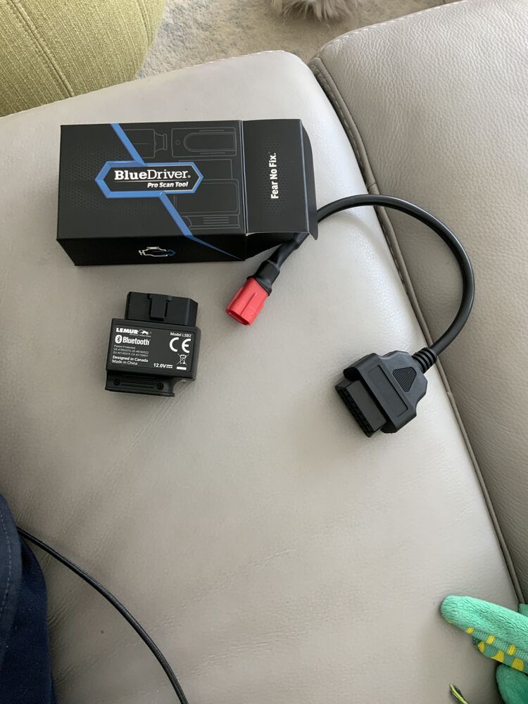

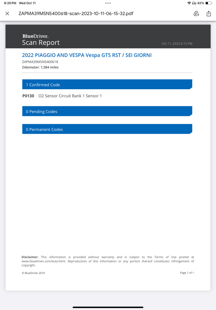

So Vespa Brian wins.
Just plugged in the BlueDriver sensor $85 Amazon and cable $9.95.
Got the report below. Very quick and easy. Free app on my IPhone.
Report below. Also works on my Audi but haven't tried it yet.
So now what? Check engine light no longer on. I'll call the dealer but I'm not too worried
Blue Driver OBD2 report

Your next step is bypass or remove EVAP system. You could also do nothing and know if it comes on soon after an overfill you are ok.
I am actually close to you this weekend in Bradenton Beach for the Tampa 2 Strokes scooter club rally at Tortuga Inn.
If you decide to remove or bypass Peter from the Sarasota club has done it before I think. He may be able to assist or make a trip up to Lakeland and I will do it with you.

I'm generally a proponent of removing the evap system. But at this point, with only one code having happened the one time, I'd just let it be and see if it happens again. It's not going to spontaneously explode or anything.
(Probably).

Called the dealer, Vespa Naples. Described o2 sensor and coolant top off. They said no worries. Monitor if code continues or coolant requires more top off. Over and out.
That's what I shall do. Thanks everybody.
OBD2 reader picture plus cable. Also worked on my Audi.
BlueDriver scan tool and adapter cable for Vespa

@billrush avatar
Vespa Primavera 50 (sold), 2021 Vespa Sprint 150 (sold), 2022 Sei Giorni 300ie
Posts: 838
Location: Naples Florida USA
@billrush avatar
Posts: 838
bluside wrote:
I also have trouble sometimes getting the cap to go back on straight. I haven't quite figured out why that is. It seems to be worse when the engine is hot.
I ordered a CNC gas Cap. 1. I like red. 2. It was $8.23. 3. I thought it might thread on better.
I have no idea why, but it does thread much better.
CNC Gas Cap from Alixpress.
