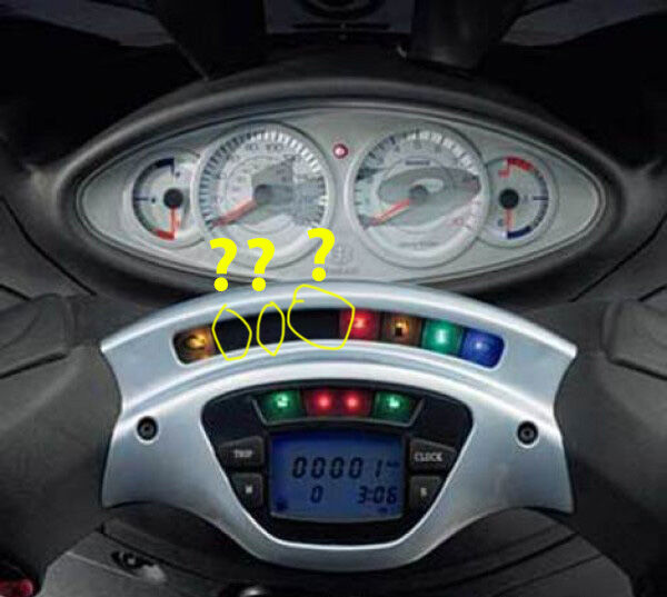

Hello there I am new to the blog.
I would like to ask you a question if I might!
My Piaggio x9 500 Will not flash the bulbs on the digital dashboard when I turn on the key, so I can check if all the leds are working.
The rest of the digital monitor checks fine.
Do you have any idea about that?
I have this problem for so many years.... I have visited many Piaggio dealers and nobody solved my problem.
I would appreciate if you could help me.
Thank you in advance.
Anthony

The three indicator lights you marked are (from left to right):
- Warning light electrohydraulic stand
- indicator light ABS (prepared)
- indicator light RUN-OFF stopped engine/side stand folded out
At least the middle one for ABS says "prepared" in the manual, which indicates that there is only one indicator light if ABS is installed (no ABS = no indicator light).

My injection warning light also is not working! How do I fix that? Do you happen to know?
I didn't find anything in the workshop manual in a hurry, but have a look for yourself: https://motowiki.by/_media/%D1%81%D0%BA%D1%83%D1%82%D0%B5%D1%80%D1%8B:piaggio:x9_500:x9_500_evo_workshop_manual.pdf
At least you will find information on how to disassemble the dashboard and/or board computer.
Apparently, the board computer can be disassembled after removal (see https://www.ebay.co.uk/itm/165130673913). Maybe only the bulbs are defective?
