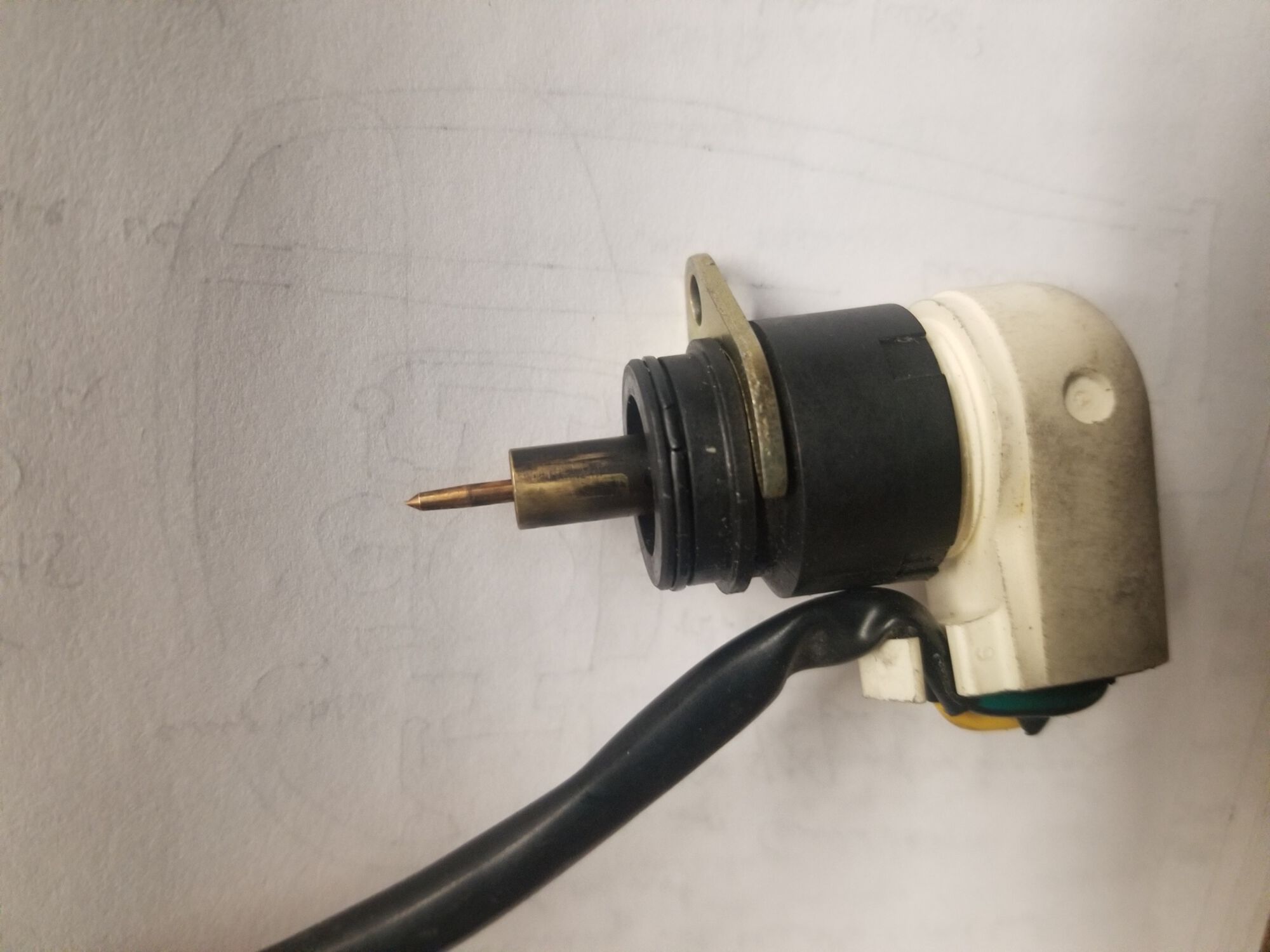

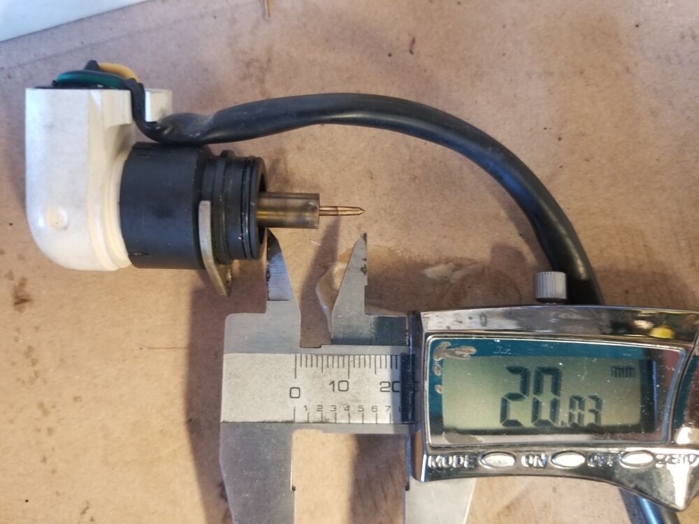

Hello! I removed the auto-choke from my Keihin KT carb. Is this what it normally looks like? The needle and cylinder are protruding from the barrel by 20 mm. When I plugged it into 12V, the cylinder extend so that the needle protrudes by about 24mm after 5 min.
I am debugging a problem where my 2006 LX150 will start and run for about 30 seconds, slowly losing RPMs, and then stall. It will stall immediately if I give it any throttle. It won't start again. After several hours, I've tried to start it again and it does the same thing. It is seemingly the identical issue to this thread: Help - LX 150 Carb Clean (Keihin CVK). Anyway, i could imagine such a problem being caused by a choke that is always engaged, meaning it always creates an over-rich fuel mixture. That would help it start, but would eventually make the mixture too rich to combust, perhaps flooding the engine, and making it hard to start until the mixture leaked out. Thus, it makes me wonder if my autochoke somehow always engaged. Haynes unhelpfully gives a spec of "10mm," whereas other carbs have an Initial and Final spec.
I understand that when the needle is retracted, it runs rich. When extended, it blocks an auxiliary fuel passage and results in a leaner mixture.

it works, so I wouldn't be terribly concerned about it.
what else has been done to the carb?
was it running fine and suddenly this problem came on? need a little more info to go on.

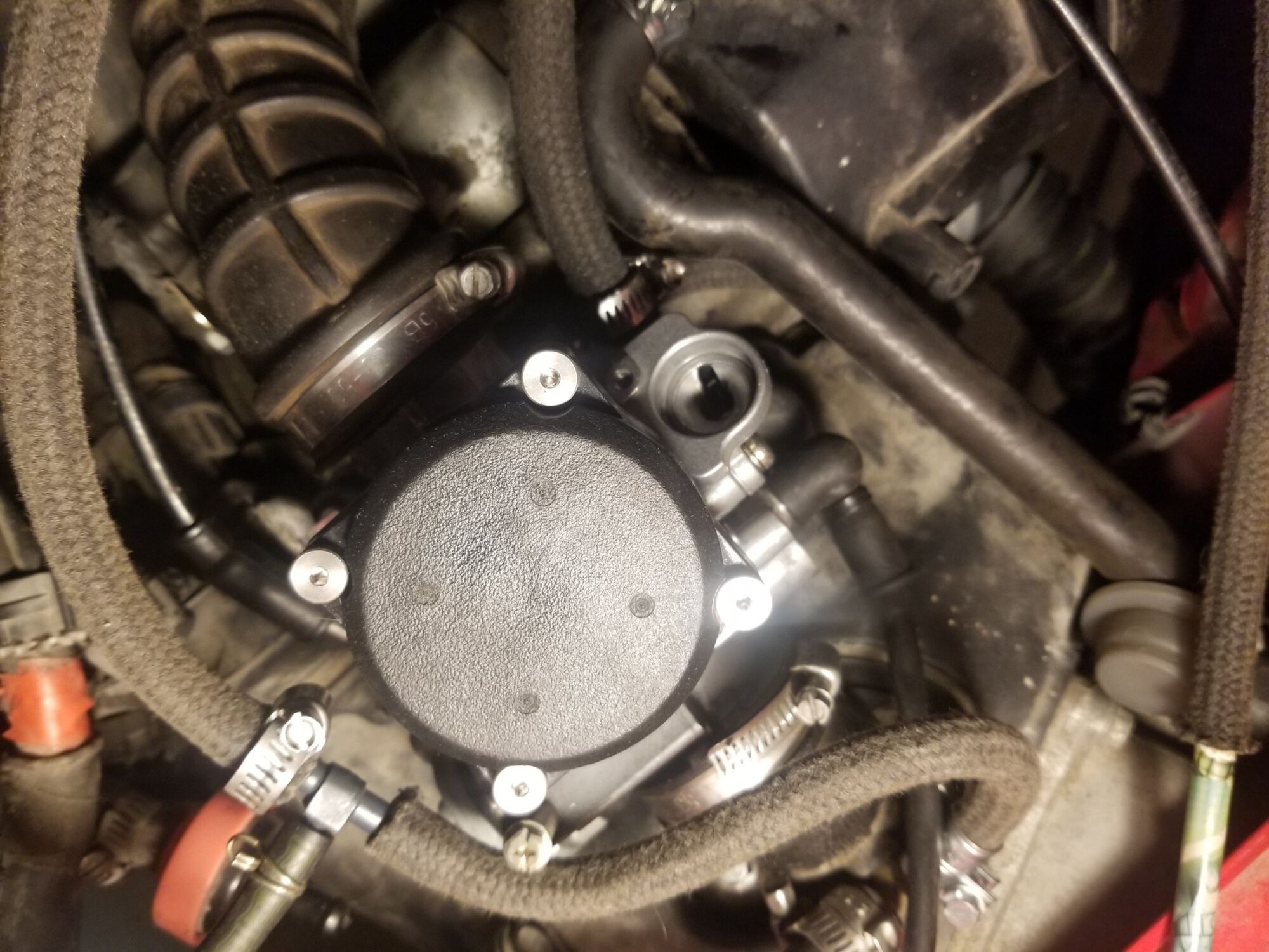

I've been continuing to wrestle with "this problem" (hard start, won't idle, throttle needs to be more open than it should to keep running, exactly symptoms described in ET/GT/LX: Hard Starting, Rough Idle, or Stalling in my 2006 LX150 for the last six weeks. In my case, what cured it is removing the auto-choke and covering the hole with my finger. With this, it starts well and idles smoothly.

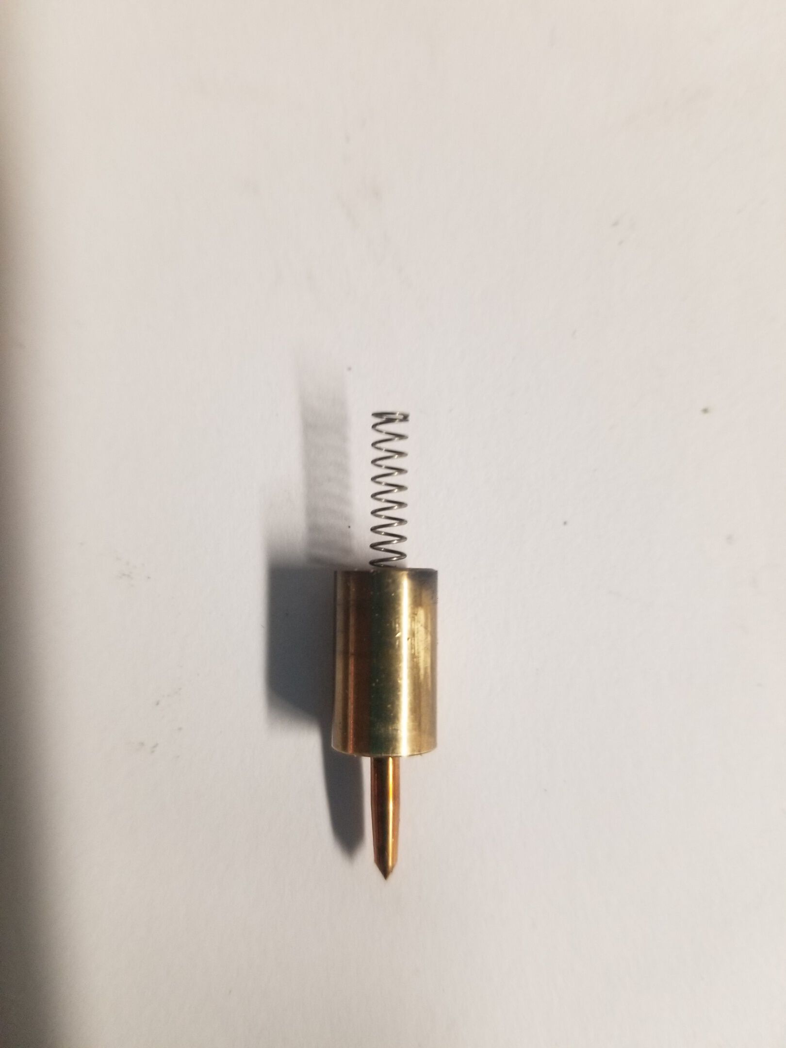

Obviously, that's not how it is supposed to be. It seems likely that there is some other thing wrong, and removing the choke compensates for it. I believe with the choke removed, that will make the mixture richer (since the choke's needle extends to block a fuel path). That might imply that the mixture is way too lean to start with. Am I thinking about that correctly?
I removed the needle from the choke assembly, and I can just plug the assembly back in and so far everything seems fine. That seems a bit too good to be true, and now I feel I'm really close to resolving this for real.
With choke removed - won't start, doesn't run.
Covering choke assembly socket - it starts and runs well. If I remove my finger, it stalls immediately.

Choke assembly. There was black crud on the brass cylinder. I cleaned that later, and it ran better, but still needed throttle blips to avoid stalling every few seconds.
Needle removed from choke assembly. When the choke is installed without this, it starts and runs well. It's just like having my finger covering the hole.

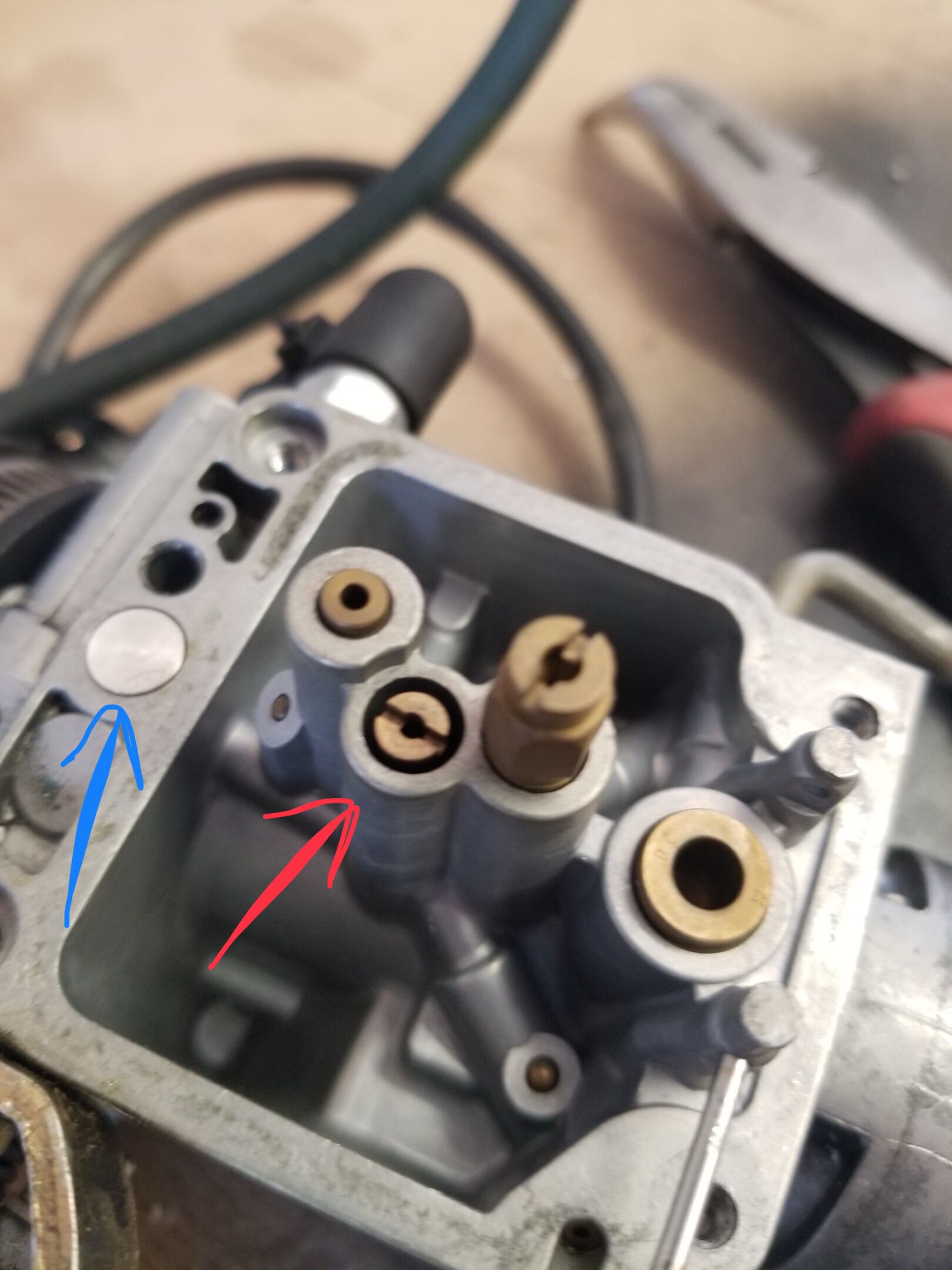

Grumpy, thanks. I did clean the carb, soaking it in a vat of Chem-Dip carb cleaner for the recommended 30 min, then blew out channels with compressed air. Nothing really seemed clogged up or visibly gunky, but hard to tell.
Which is the low speed circuit? I'm guessing it is the one flush in its socket, second brass insert from the left.

The red arrow points to your slow speed circuit jet.
The blue arrow points to your idle mixture screw. The EPA doesn't like us to adjust these so they put a plug over it. You can drill out the plug and access the idle mixture screw. Don't just remove it. First gently screw it in (clockwise) until it touches the seat. Don't crank it tight against the seat be gentle. As you are doing this, count how many turns it goes before it touches the seat. Then when you reinstall it, you can set it back to exactly the same position. Remove the idle mixture screw and give that area a good clean with spray carb cleaner. You might get better performance by setting the screw back to where it was from the factory and the opening it (anti-clockwise) a bit. Small adjustments. Maybe 1/4 turn, then see how it idles, repeat until it idles well. Don't go more that a turn or so or you'll be idling too rich.

Yes, don't drill out that plug! Sorry to miss lead you. All the Keihin carbs I've worked on had this plug covering the idle mixture. But on your carb the idle mixture comes in from the side.

the choke plunger looks awful, but it should clean up fine. check that the bore of the choke pull off assembly is not gummed up or scored preventing the movement of the plunger. clean it with a q-tip if need be.
did you have the choke pull off off of the carb or just the choke itself?
