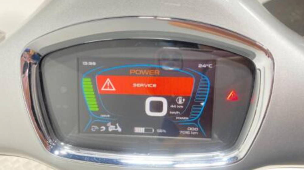

At first glance I couldn't understand how a 2020 scooter could be listed as a "spares or repair project" (unless the current owner really rode with no fear of reduced resale values):
https://www.ebay.co.uk/itm/134763374471
Then I read the description and saw the photo of the display in the listing:
"The scooter is being sold on a spares or repair basis due to the fact the scooter sometimes throws a service urgently code from time to time. We have just had the secondary battery replaced at a piaggio dealer but it is still showing up. The garage was a little stumped and unsure what the issue is."

I know when I had mine serviced at the dealer, that the servicing was mostly computer updates that they themselves have to apply to the bike. I wonder if this is a "bug" that has been cured in a newer software release.
Also curious as to what they consider the "secondary battery".
When my 12v battery went under the floor, I had a lot of strange symptoms, error warnings, swapping the language to Italian etc.
The 12v battery only charges up when in "Ready" mode, or when the traction battery is less than 100%. I think some people park the Elettrica up for the winter and assume the 12v is being maintained by the traction battery, when it isn't.
My mechanic told me that if I wasn't using the Elettrica for a bit, to activate it and leave it in "Ready" mode for 10-20 minutes every few weeks to keep the 12v battery in a good condition.
