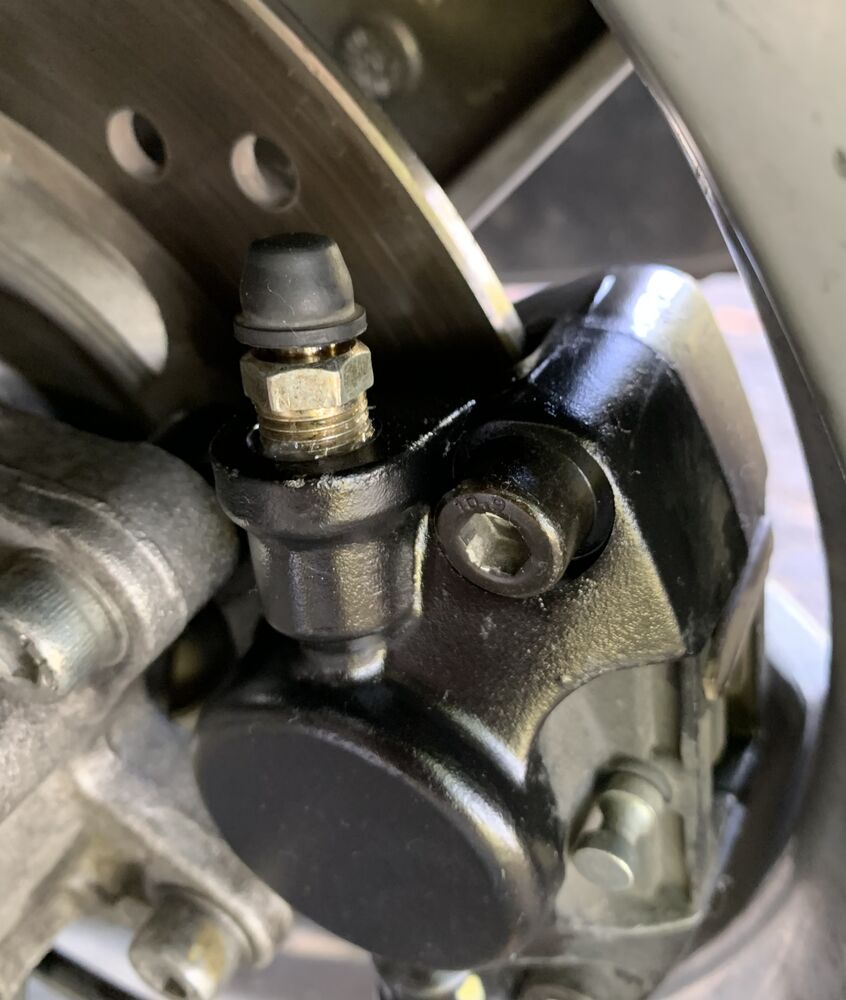

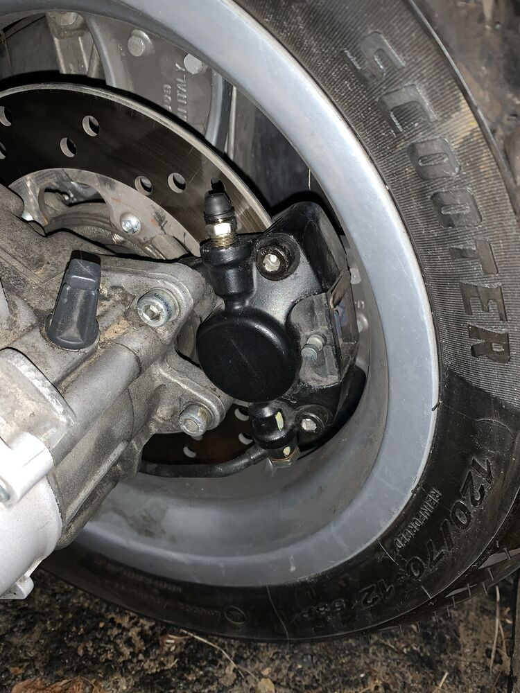

greasy125 wrote:
this is my guess as well.
a bad bleeder or stripped caliper. my money is on the caliper from the description. a few photos would help tremendously.
Ask and ye shall receive…are these what you needed?

fergy wrote:
I may be wrong here but you say that your sequence is: open valve, then you squeeze lever. Shouldn't you be pumping/squeezing the brake lever, holding it in and then opening the bleeder till it bottoms out while fluid runs into your bottle , keep it bottomed then close the bleeder. Once closed release the brake and repeat the pump, open, hold and close sequence?
Good catch. I read his post twice and still totally missed that.
1) Squeeze lever, squeeze lever, squeeze lever... HOLD IT SQUEEZED.
2) Open valve, fluid comes out, close valve, release lever.
3) Check fluid level in reservoir, top up if necessary, begin again.

SteelBytes wrote:
saw in another thread about using teflon tape on the nipples ...
I wondered if I could wrap the threads. I wasn't sure if it would disintegrate. I will go ahead and try it to tighten up the threads.

Wrap up.
The tips were all really helpful, most of all, I think, to pump the brakes. I sent another 120cc of fluid through and the rear brake is much better, I think there is still air, but it has been reliability functional.
I will go another round this coming weekend, to see if I can get them firmer. Brake fluid bottle #4 from the auto parts store was enormous so I have plenty of fluid to do this (hopefully) final round.
Thank you for all the help!
