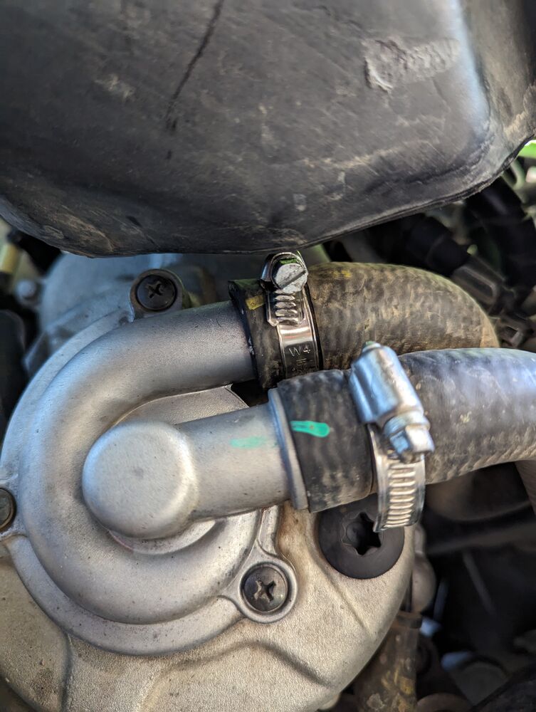

I'd carefully cleaned this yesterday evening and checked today and ...
Looking at this do you reckon I could just take the single use clamp off and replace it (maybe without removing the hose) and that'd fix it or do you reckon the hose itself is somehow becoming dodgy?

I'd 100% suspect the clamp before the hose.
R&R with a more suitable clamp. if you've got lithe little pickpocket fingers and patience you can totally do it in situ.

thanks, that's what I was thinking

notes after doing it:
removed side skirt,
used a 16-27mm ss clamp (without the holes),
get the new clamp on the hose first,
put a pan under because it will drip quickly,
remove old with a screwdriver,
slide new and tighten,
wipe up.
now to wait and few hours and then
check for drips,
probably will bleed,
check coolant level,
ride,
repeat these steps.

update:
decided it was too near the fuel tank so rotated it back. (note the previous photo was misleading as it appears to be touching but it wasn't)
from above
from above
