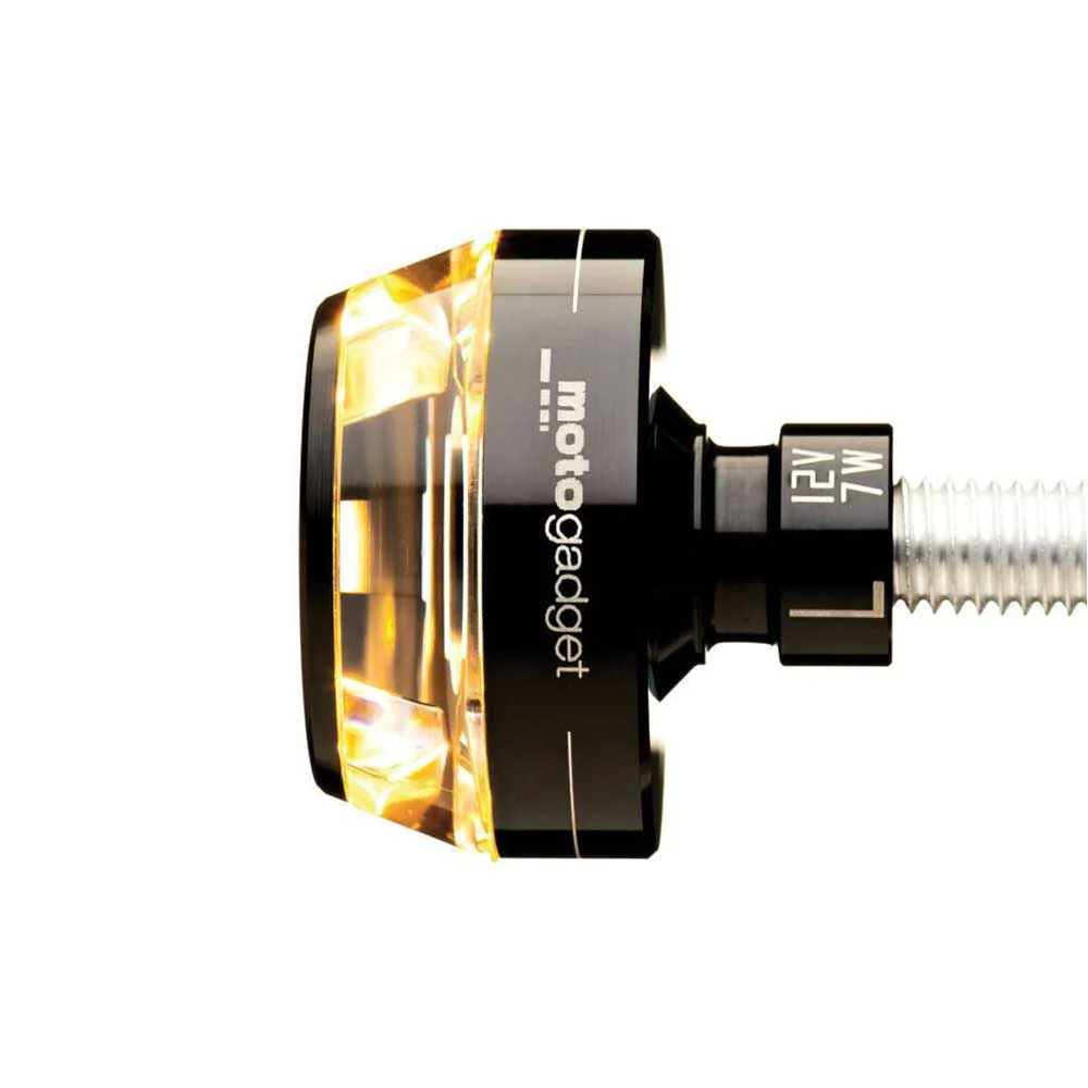

So just finishing off a project to which I added a new loom and a standard px200 engine with no battery, I got the loom from SIP with provisions for bar end indicators. i chose to use the motogadget barend ones which are pretty stealthy, trouble is they don't flash... I'm sure it's got something to do with them being LED but not sure what I need to do to resolve the issue, can anyone shed any light on this please!!

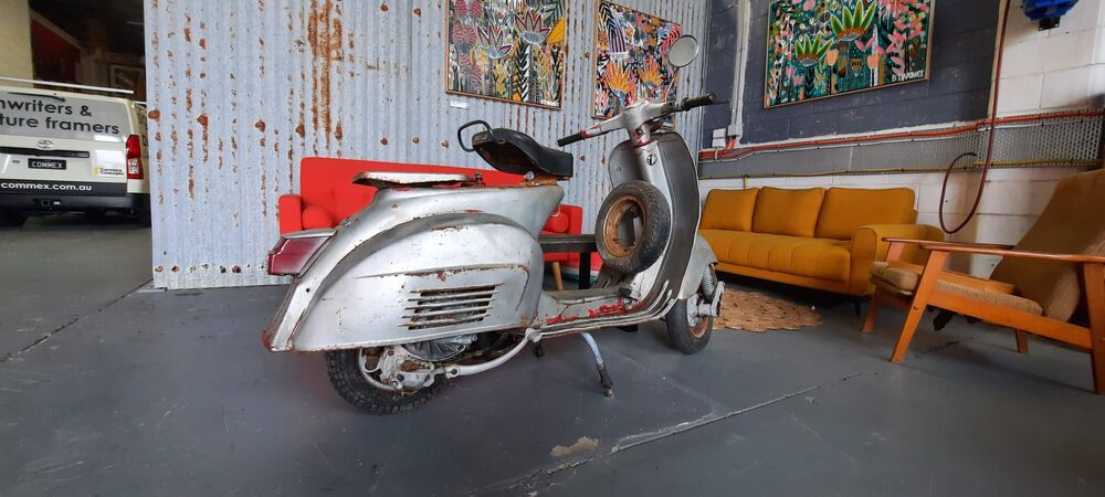

Rough looking 1975 vespa 150 super as I got it

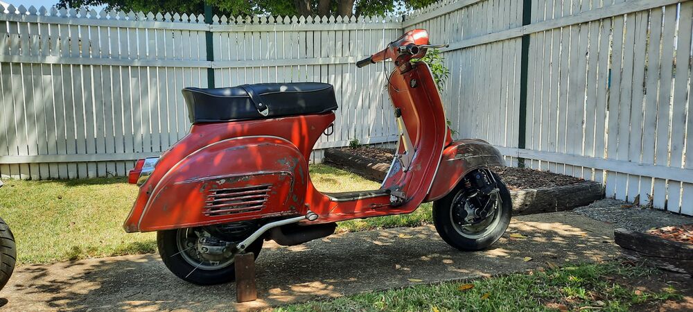

Here she is nearly all done, just a few things to button up
Motogadget M-Blaze Disc indicators

You most likely need to wire it up for DC power to the indicators.
So you'll need a reg/rec and a DC flasher relay.
I don't think it has anything to do with the LED. The newer version have a built in resistor, so works out of the box with DC power.
