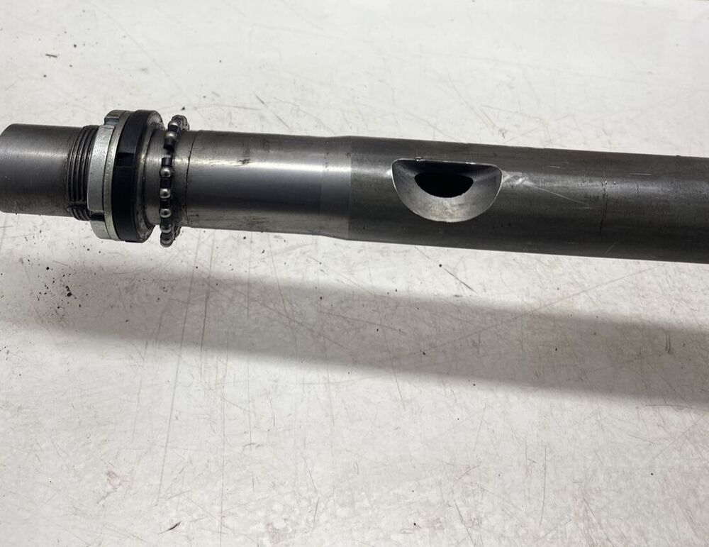

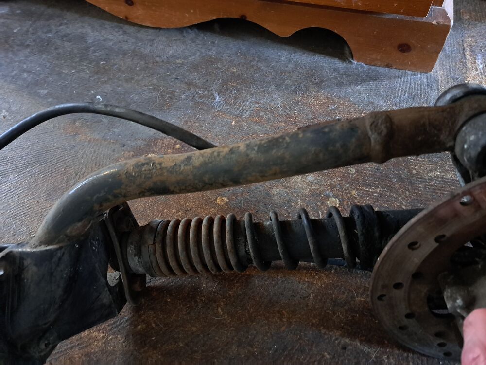

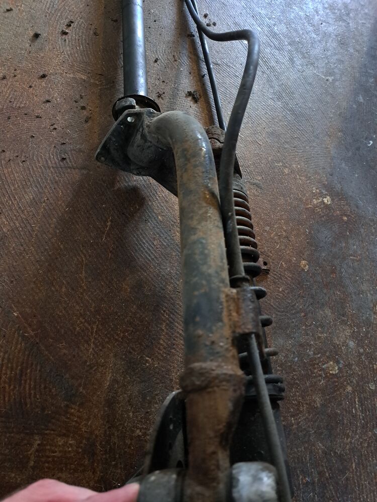

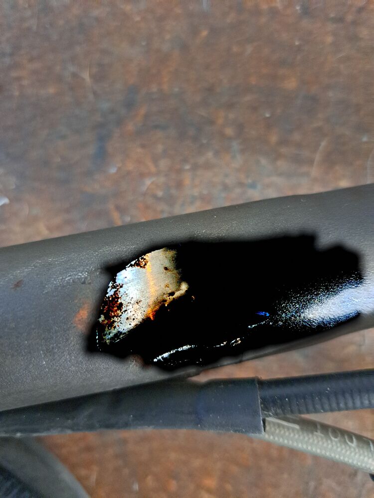

Hi looking at these they seem bent..or is it me ....
Also should there be hole near lock bit

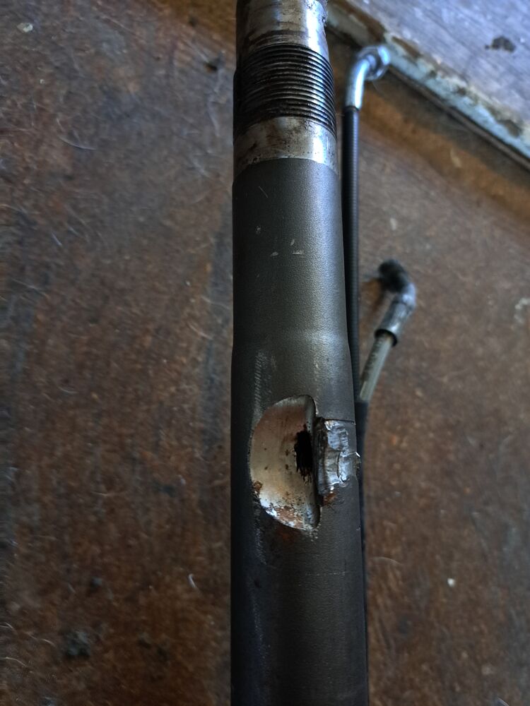

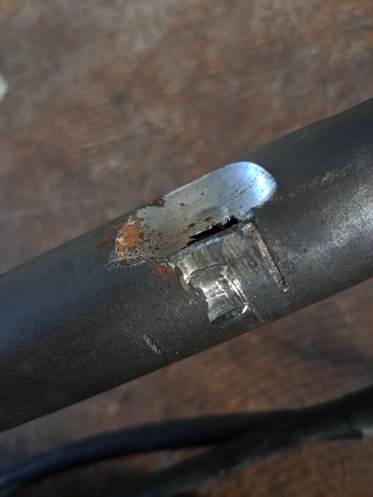

This bit

Looks like a steering lock notch that got thoroughly abused.

I assume someone has tried to steal it..is the hole normal

The steering lock never worked when purchased..just thought it needed tweaking..
Posts: 39179
Posts: 39179
Ideally, no -- there should not be a hole there. But it looks to me like the factory over-machined it a bit, or the wall tolerance was just a bit too tight.

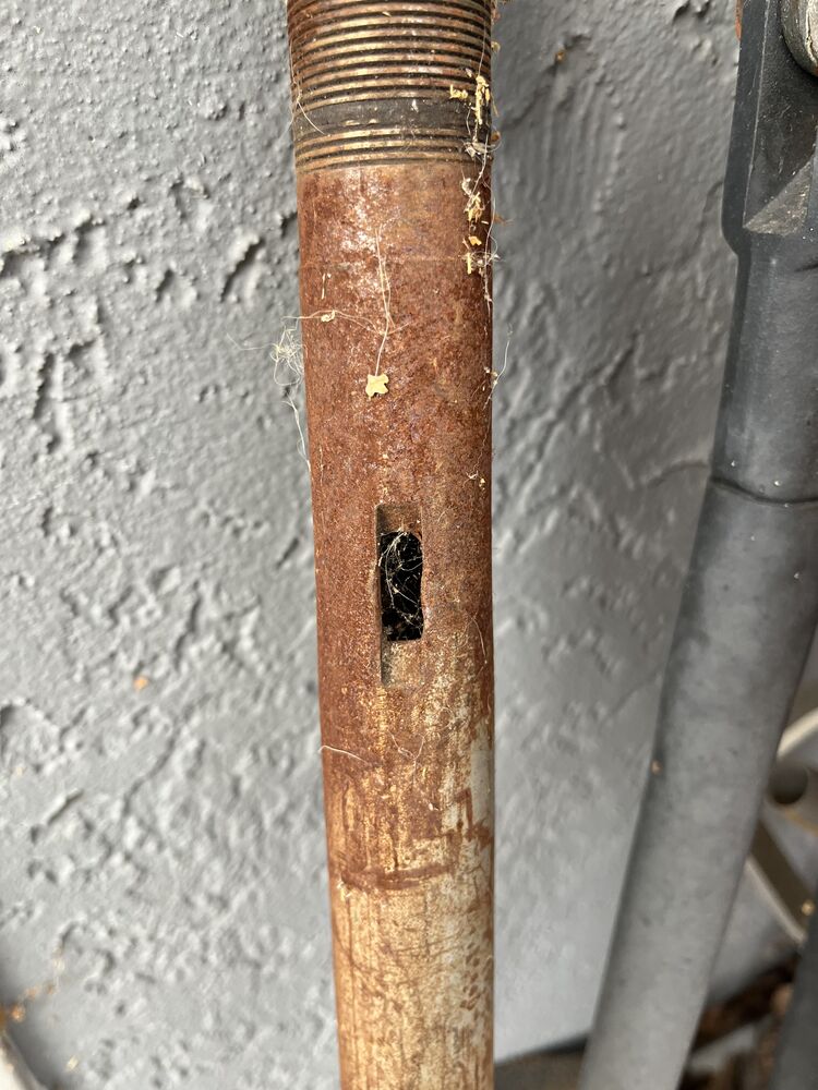

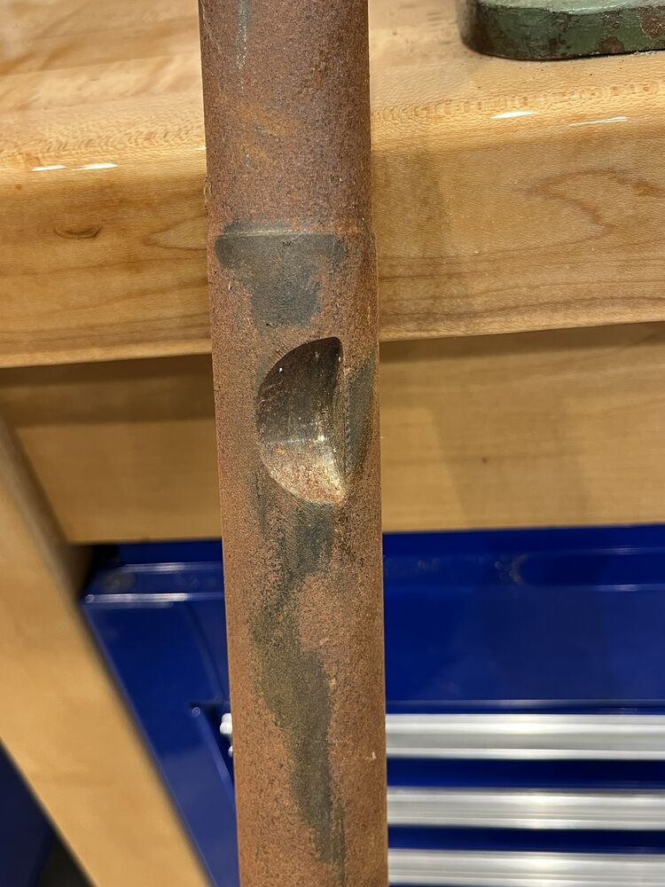

The first photo is a GTS steering column. The second photo is a vintage steering column, where the slot is actually machined all the way through the outer wall.

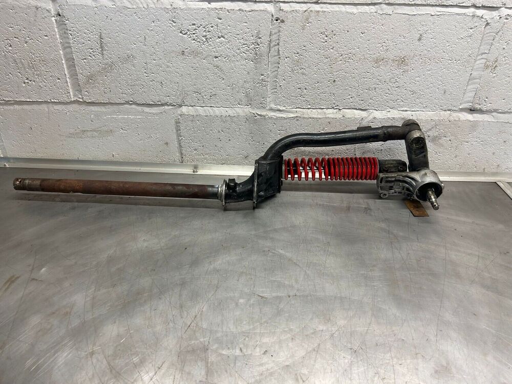

Brilliant thanks jess..I will take my grinder to the rough bits too smooth out and stick a weld in the hole..do they look bent though or is that the shape..

It is notoriously difficult to tell (visually) if a Vespa steering column is bent. There are some deliberate factory bends, which makes an eyeball assessment near impossible.
You really have to stick it in a bike and see if it behaves.

So not bent just Italian shite

Maybe, would be best if you can compare side by side to another one.

Dek, I've three lots of forks, all GTS/GTV (one is new), all have the contour, all have the D shape machine cut out one is through creating a small hole, normal.

So there not bent buggsy ..that's there normal shape..

Yes mate, that shallow contour is normal as for the lock socket you could build that up with weld then grind back.

Lock socket.
