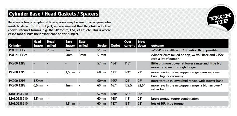

Yes, the ignition timing will change, very slightly. If looking at stock setting of 22 degrees BTDC for a Sprint with a 57mm crank, The distance of the piston BTDC will be 2.62mm. With a 60mm crank, this changes to 2.79mm at 22 degrees. Therefore, to get the original firing distance of the piston from TDC of 2.62mm, the timing needs to change to 21.3 degrees BTDC. I used this calculator.
Port timings will change also and these will have a larger effect on the 'personality' of the motor. You can alter the port timings by raising, or lowering the cylinder with packers/spacer gaskets to get more torque for low end, or a higher revving motor and more top end power, or even something in between.

Seems that advice used to be to put a 1.5 mm spacer under the barrel to make up for the difference between a 57 and 60mm crank.
But measuring and setting up port timings turns out to not be all that difficult and there are lots of people who can guide you through it. The 60mm crank usually crank gives you more wiggle room to set the timings using shims or spacers without the need for machining stuff.
