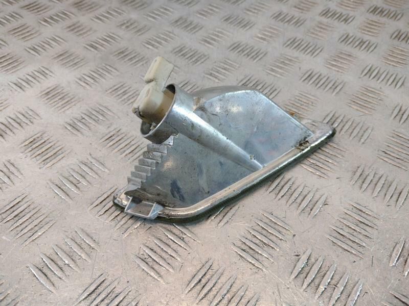

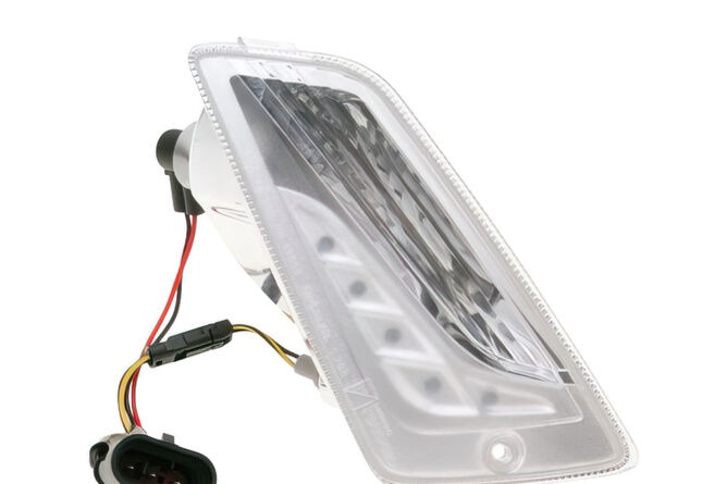

Okay maybe I didn't make myself clear. Would any year single bulb Front indicator fitting from a GTS GT GTV fit in my 2017 GTS 300. I will redo wiring.
I just want to make sure it fits in the slot on the scoot. I want the single bulb option because the switchbacks pictured have a more powerful LED DRL than the OEM light fitting.

Single bulb light fitting
OEM light fitting
OEM light fitting

There's no longevity benefit from using LED indicators - they are on for such a small time overall. However, their sudden turn ON/OFF characteristic makes them more immediately noticeable, so worth doing for that alone.

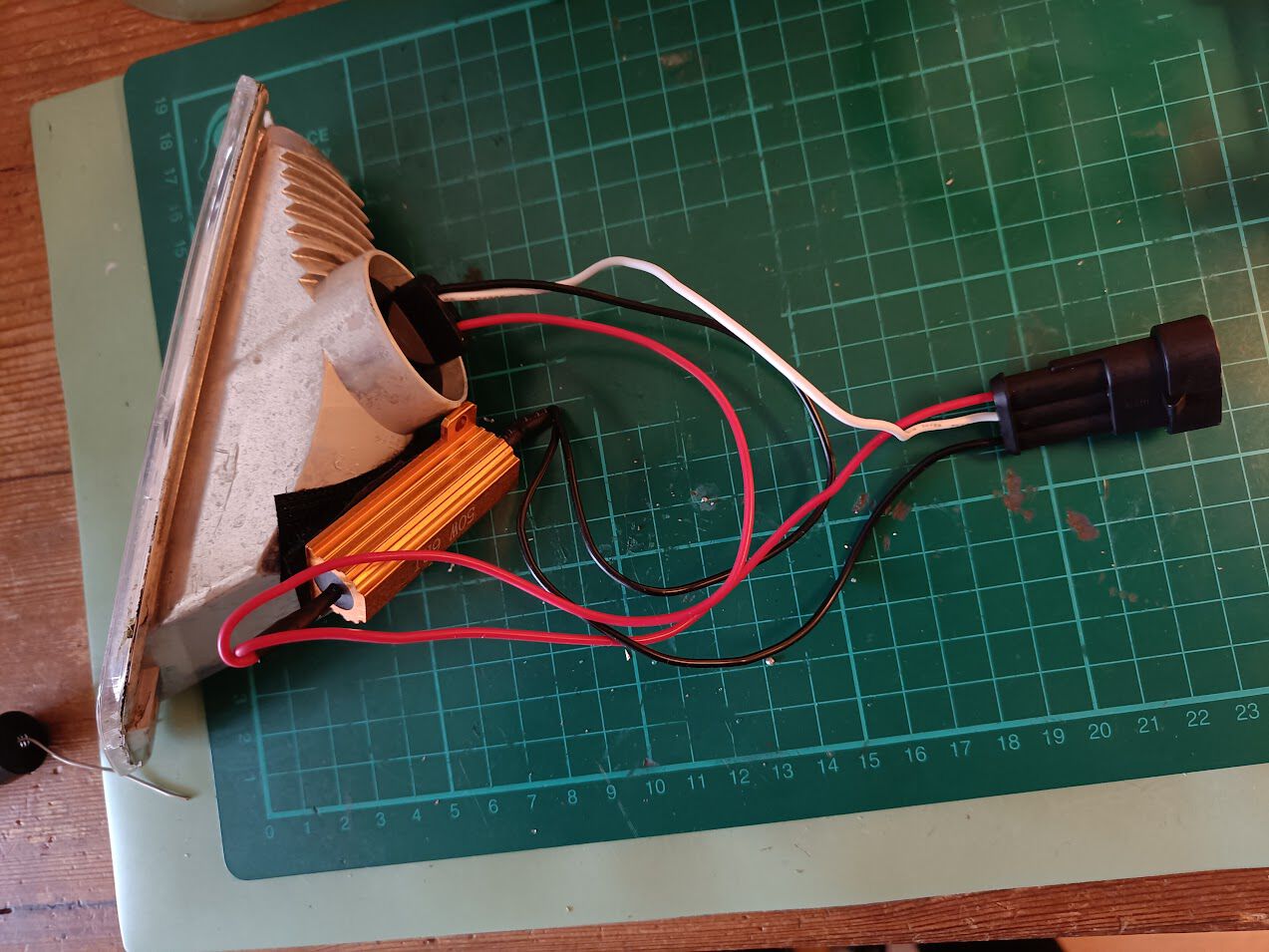

Hi, I got this recently from AliExpress, unfortunately the rubber mounting bulb inside the indicator casing was to small, the bulb was too loose Facepalm emoticon
External inline image provided by member with no explanatory text External inline image provided by member with no explanatory text
So i cut gently the rubber out and fitted the LED bulb inside the gray connector, like on the photos below. I did remove the resistors as well, did not need them with my 2007 LX.
External inline image provided by member with no explanatory textExternal inline image provided by member with no explanatory text

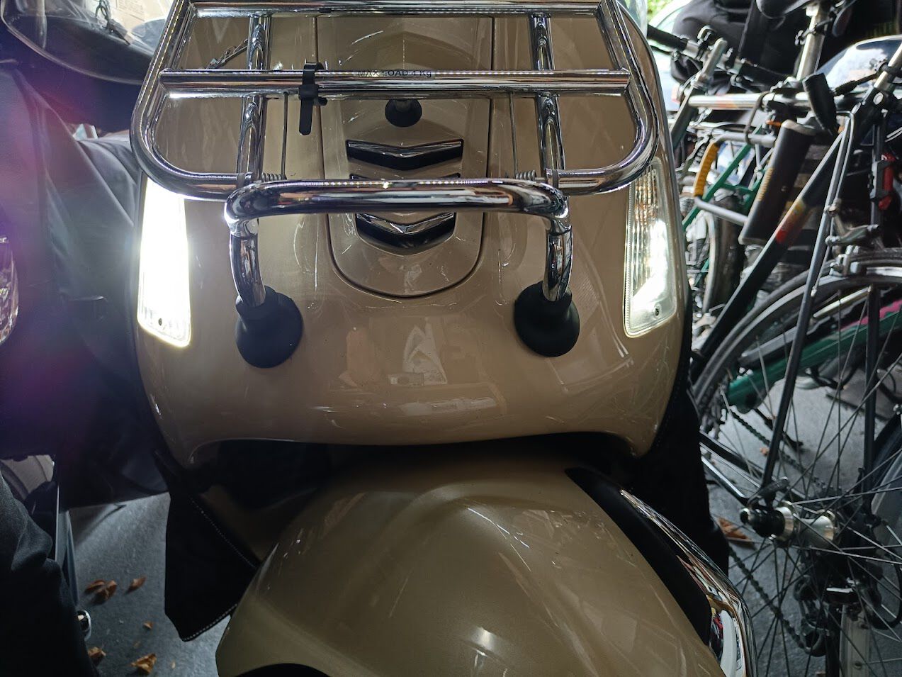

UPDATE: Yes interchangeable....
I bought these single bulb fitting indicators for a GTS
Then fitted these Switchback DRL's
I bought some original 3 way connectors I posted about here.
Indicator connectors plugs 3 way for GTS 300 ABS
The result is a much brighter light LED than stock.
Single bulb indicators
Switchbacks
Switchbacks
DRL
DRL
DRL Switchback on left
