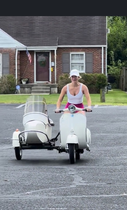

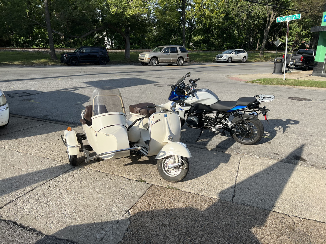

Some of you all may have seen my post about the $5 Vespa I picked up earlier this summer. Well, it has been a memorable few months. My kids absolutely love it and ride it all over town. Every time it goes out people smile and wave. And so far it has been totally dependable...pretty darn good for having sat 5 years and only a carb clean to get it going again.
So here lies my minor dilemma. I want to go through every nut and bolt on it over the winter, complete tear down and rebuild. That's just what I do when I get an older machine. So the paint is a bit dodgy and comes off in pieces now and then. Do I strip it and start from fresh or keep the patina as is? I'm a serial buyer and seller of motorcycles but my kids say this will never leave the family, so keep that in mind.
And I'm still not exactly sure what I've got. The owner before me had it shipped from India, I know that much. The title say VBB150 but the DMV in Kentucky didn't have a clue what it was when registered. From my minor research, shouldn't it be a VBC? The VIN is V462I2T60500 if that helps.
I've got a garage full of motorcycles but everybody has the most fun with this.

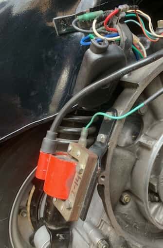

My scooter is also an Indian Vespa. Bajaj was a licensed Vespa factory up until they weren't, and then they started selling the same scoots under the name Bajaj. Your VIN checks out as a 1967 Vespa 150 according to this website:
http://indianscooterownersclub.com/cgi-bin/vespa_chassis_dating.pl
If yours has a round rear fender instead of a squared-off one, I'd guess that your body is (or was originally intended to be) identical to a VBA body. What I've found is that the parts are off brand. The carb is probably Spaco, and the cylinder head probably has RAMP stamped on it (if you take it off), the clutch cover has an R on it instead of the P in a shield. It all works.
I just ride mine, it's fine.
A note: I had to replace the coil's dubious mounting bracket because it was brittle and broke. I expect the clutch arm is made from the same metal as the coil mounting bracket, but it seems to be holding under greater stress, so it's still on the bike. If your coil bracket looks like the attached, consider fashioning a new bracket. FWIW, I had to replace that coil as well.
lousy coil mounting bracket
