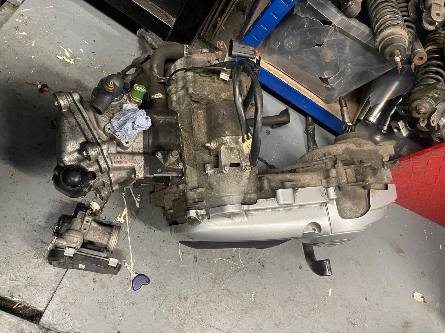

Hi, I have a 2012 GTS 125 super IE, only 9500 miles but unfortunately the big end went in it this week.
I love the bike and I am thinking of obtaining a second hand engine for it.
A few questions;
How do I know what model of engine to look for? Mine was registered in March 2012, I'm aware a new design of engine was fitted sometime in 2012.
Will the key work with a new engine or will it need reprogramming?
Is it a job that someone with average mechanical skills can do?
Thank you
David

Just use your old throttle body, that will remain programmed to your current keys.

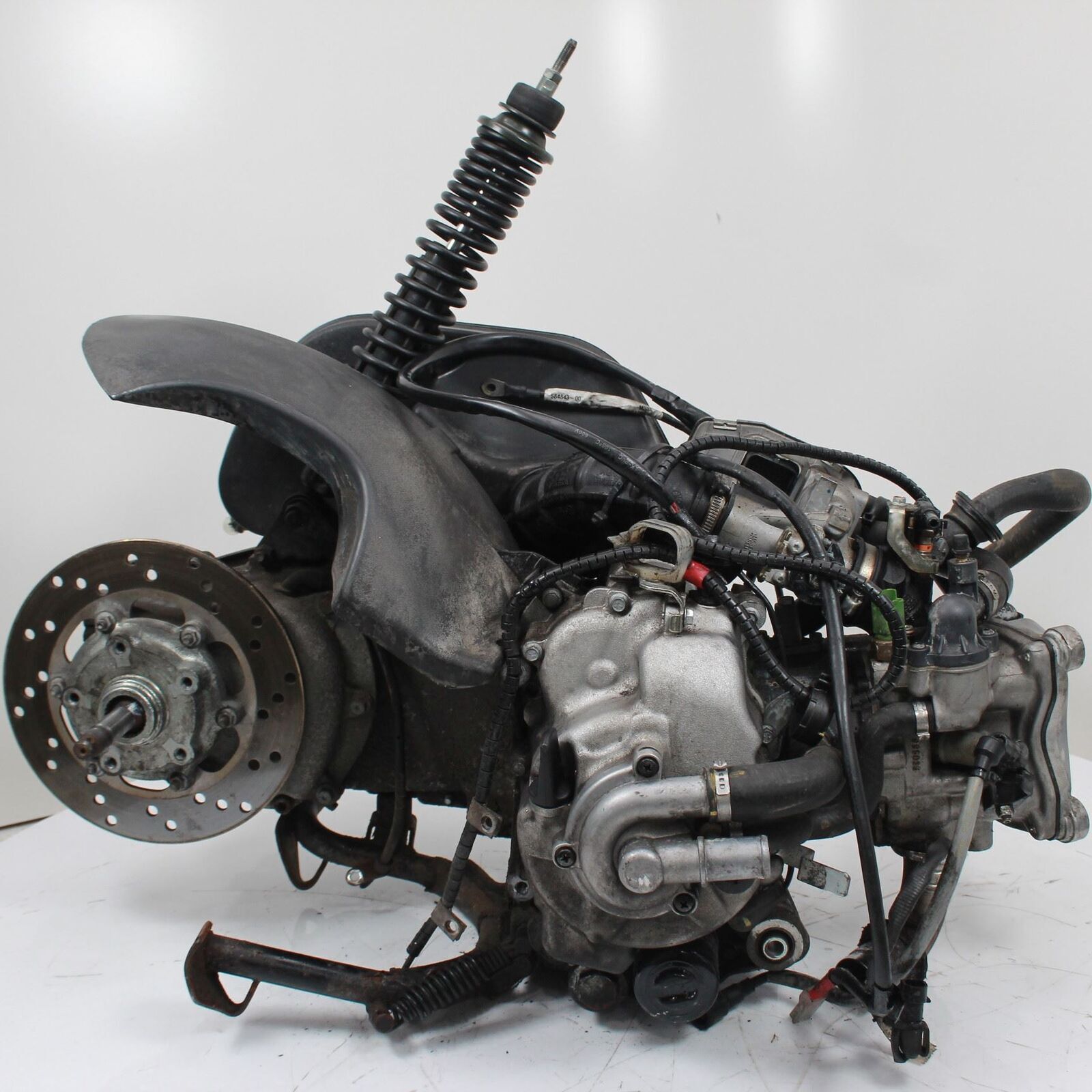

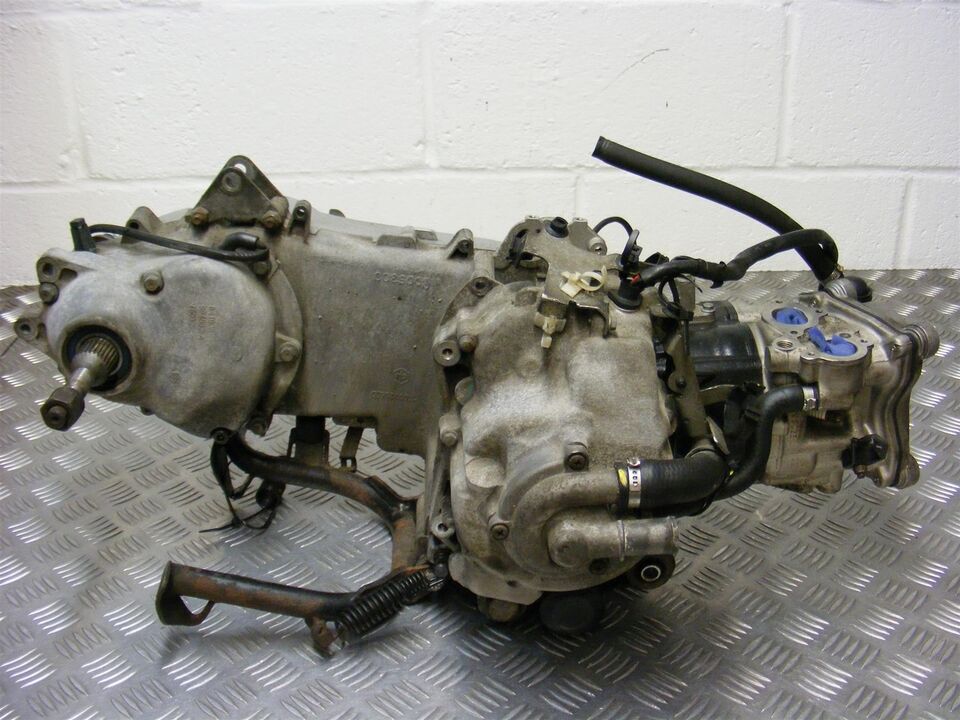

So I ordered the engine from eBay, turns out even though its for a 2012 GTS its not the same as the one I have! Mine is different on the right hand side, which is where the dip stick is for the oil. I can't find any similar second hand engine
right side of engine

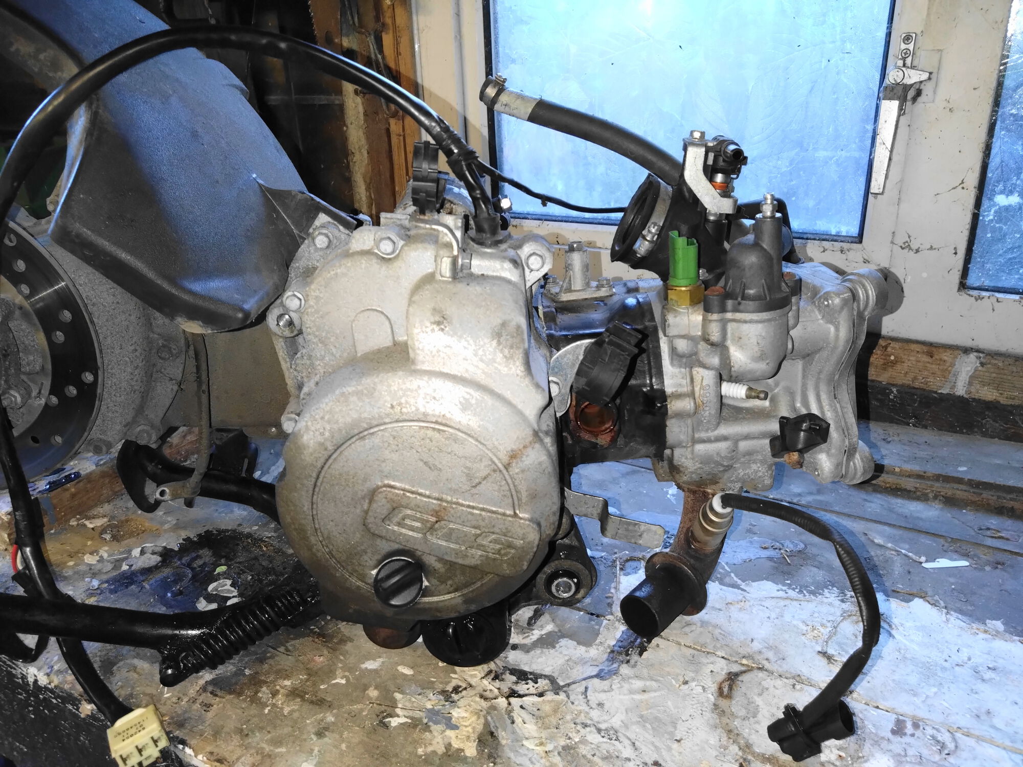

The one I received looks like this on the right.
So it appears that I have a very rare 125cc engine. Every other engine on eBay looks the same on the right hand side

That's a leader engine mate, the most common and a few on eBay, then they changed I think 2012 or 2014 cant remember what year, also if you're getting off ebay make sure it has a warranty and get it fitted before the eBay money back guarantee runs out😉👍

Are you saying the leader engine is the top photo, the one I took out of my bike?

No the leader engine is the bottom photograph, the common engine and will fit in your frame, the top photograph I take is the old engine, if so was it injection or carburation.

The top photo doesn't look like a gts engine but the bottom one does..

Does the engine number bottom photo start with M315 you can find this R/O final drive.

The top engine is a GTS IE engine that superseded the leader, this is why I asked is it injection or carburation, so the cross over must have been 2012 if that's what your scoot is

Hell Dek you been on the piss the top engine is a GTS IE, says GTS on the crank side ROFL emoticon it superseded the leader

Not pissed permanently stoned lol..I can't see what's written on engine case can't zoom in..is the gts ie different to a standard gts ??

The case says ECS - Electronic Cooling System - a new engine for the GTS125 starting around 2009.
https://manuals.wotmeworry.org.uk/Vespa/GTS125/GTS125ie%20Super%20Workshop%20Manual.pdf

Yeah your right got it to zoom in cheers

Hi mate, been and asked a mate whos done engine transplants in GTS/GTVs it wont work, it should fit but wont couple up, sorry.

Thank you for all your comments, still not certain which particular engine I have, its not this one;

its different on the right hand side (page 187 of manual)
Don't know as this is one advertised on eBay, the one I took out of bike starts with M455.

You're old engine on the right is pump enclosure were this pump is external both IE.

Just looked back at your original question to keep your original keys and barrel you will have to keep the original throttle body.

There's a picture on page 47 showing the ECS casing and the oil dipstick on the right hand side. I'm just going by the photos though, I've no first hand knowledge about the engine types.

It appears the seal went on the oil filter when I was doing 60mph, oil light came on stopped bike straight away, to find oil sprayed all underneath bike. Wheeled 2 miles to a repair shop. left it to be looked at, he changed oil new filter. When engine started knocking noise and very little power.
