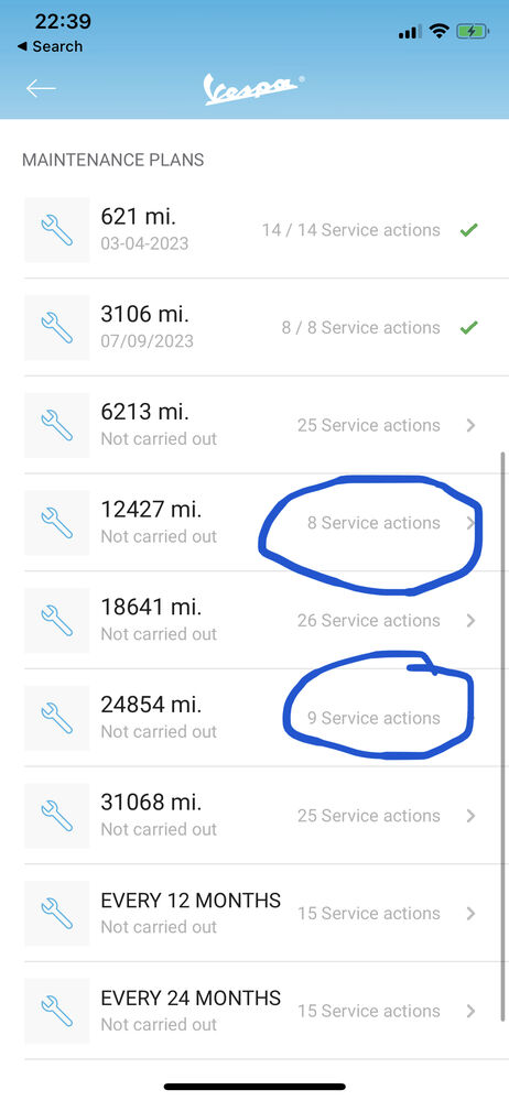

I think it's now been extended? This is my maintenance table for this 2022 Vespa Sprint Sport.
One you reach 6,000 miles, it swaps to a major / minor service interval.
The minor service is pretty basic, and it only shows a belt replacement on every major service. Guessing this is something new?

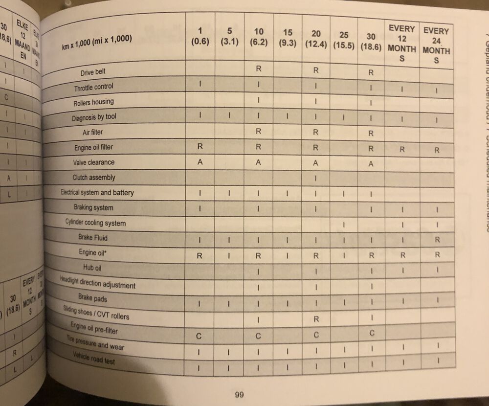

Actually… this might be a glitch on the Vespa App.
Just checked my printed manual and it shows minor and major services alternating every 3000 miles, not 6000.
So in this way, the belt would be changed every 6000 miles, not every 12,000.
The app doesn't show as many services.
