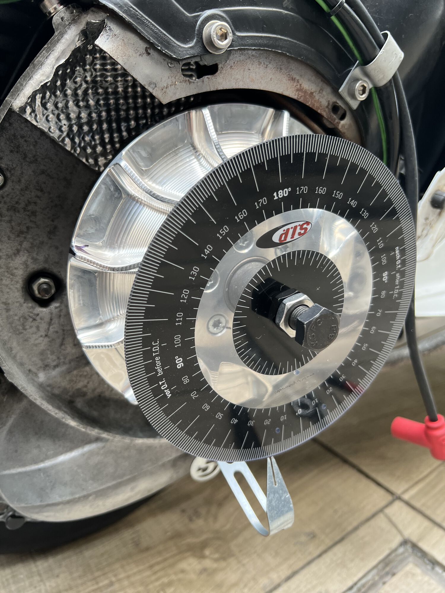

I'm completely over it.
I dropped the motor a year ago and tested for air leaks, shortly after my first rebuild, and it held 5 psi for hours.
The thing is , I've been chasing my tuning all over the place ince then.
I currently have a P125x with Malossi 166 kit. Case matched and everything flowed or whatever you call it with a Mazz race cut crank, Si 24/24 carb and a Sito Road 2.0 and a Vape variable ignition system.
Oh and a new S.I.P fast flow with the bowl to main jet passage drilled to 2.5 mm
And their filter opened up like a heart.
Jetting, and here's the drama,
Main stack= 130 air/ BE4 mixer/140 main!
Slow circuit is a 50/???, I can't read the second number currently and can't find my magnifier.
Thing is it's lean at WOT when I do a proper plug chop.
A wisp or a ghost of color you really have to look for and to narrow! Electrode being white as well.
I don't think I'm getting the revs out of it that I should .
My cheapo Amazon multi tasking hour meter, CHT meter and Rev counter shows me the highest rpm to be 6995 @ gps Speedo 55.
My Timing at idle is 19.5 BTC
I don't care about the speed, I feel I'm not reving out enough.
Fuel flow is was so much better then my stock, Dick Trickle, I was getting!
So I plugged my engine up and put 5 psi in her again and it's holding.
Any ideas why the high main jet accompanied with lean chop?
3rd and 4th both stutter out at max rpms, can feel the power rapidly stuttering.
One last question, if I can upload a short video, when I slowly rotate the crank my Guage jumps around considerably. Settles back to origanol number almost istantly.
Is that normal?
So I don't know what I'm asking.
It runs but I'm missing something in my set up that isn't allowing full potential, I believe.
Thanks for any pointers
Sorry I can't load videos

Timing at idle should be around 23deg at idle for a Vape sport ignition.
Because at 19.5deg idle, at 7000rpm you'll be at around 14deg btdc which doesn't make sense.

First off, you shouldn't be checking timing at idle anyway. You need to be up in the 4-6k RPM range to get a good, accurate reading.
As to why you're lean...hard to say. Have you confirmed that you have flow all the way through the carb? Tried different jets? Just because a jet is *marked* 140 doesn't mean it's a 140 unless you've measured it with a pin gauge.
Now that's all out of the way, we can get to the root of the problem, which is that you need to look at your port timings to figure out what's going on.
Measure your port timings and your squish. I'm going to guess that your timings are too low, which is why you can't get enough RPM's. The Malossi is a relatively revvy kit and likes higher timings. Do you have any base gaskets/spacers on the motor?
As a bit of an aside, you said you have a Mazzy race cut crank, but not if it's a 57 or 60mm. I assume the intake timings are 118/6, but the intakes themselves are not lengthened. That's not ideal, but it's not killing you, either. Nothing I'd worry about if you're not splitting the cases for other reasons.
Finally, the SR2 isn't doing you any favors at this point. You'll get another 500 RPM's on top and a little better curve before the peak just by going to an SR3. Any of the Big Boxes will also do right by you. I'm not saying you *need* a different exhaust, just that it'll be easier to get 8,000+ RPM's with a newer exhaust design.
We can get you there, you just need to be looking at the right pieces of the puzzle.

I thought I was miss understanding something.
I miss read what somebody was saying.
Will re time but question is , what kind of behavior am I seeing out of this timing I have now? Tempeture wise and what not?
If my gauge is correct It runs a high as 220f. Does that make sense given the incorrect timing?

Ignition timing too close to TDC means there isnt enough time for the fuel to burn before the piston moves back down. Usually means you end up with a huge main, but with lean conditions.
The cylinder is designed to with a specific ignition timing. I can only think of "modern fuel" and "high compression" being the only reasons why you might want to retard the ignition.
But most modern kits factor this in already so if its 23-24deg with a variable ignition system, then thats the number.
but as CM mentioned, if your squish is not to spec, setting your timing to any number will be a waste of time.

Issues been going on a while. As said get the timing done better.
That plug is not looking great. Jetting is lean. The stutter is lean misfire. Good idea to take the head off, check squish as suggested. And confirm the piston is not damaged.
The idle jet should be at least 50/100 to run well.
If you want the original filter fitted use an undrilled one. Heart drilling is really just for stock.
Main air should be AC120.

Lucky for you, I did a video on troubleshooting the entire fuel flow system about a month ago.
But even that isn't going to help if you don't get your port timings and squish set up right.
You didn't say if you're running a 57 (stock) or 60mm crank. If you're running the 60, it makes all of this a LOT easier, because you have 3mm of space to work with to get it all set up.
The VERY short version is...
Port timings are an expression of how much of the rotation of the crank each port spends open and allowing mix and/or exhaust to flow through it.
To calculate them, what you need to do is measure the distance from the tops of the exhaust and transfer ports to the top of the cylinder (the "deck").
Then, measure the distance from the top of the piston to the deck with the piston at Top Dead Center (TDC). You'll feed all of those values (to the nearest tenth of a millimeter) into a calculator and that will give you your timings.

OK so I plopped in a 120AC jet, set timing at 19 BTDC at 5800 rpm's, 23@idle.
Checked flow Thru of fuel system and carb per Chandlermann's video.
Haven't checked squish or port timing.
Took her out and she is rich and bogey lower rpms starts cleaning up nicely at or past half throttle and starves for fuel at about 6600 rpms.
So there is more there but am I introducing an air leak only at high rpms?

You can't be at 19deg @5800rpm and 23deg @ idle (1200rpm).
Did you use a degree wheel to measure the degrees to make the marks?

First off, one of your timing numbers is wrong *or* you're not running a Vape Sport ignition.
1200 and 5800 are only two degrees of advance different (-3 vs -1). That's relatively minor and while it might be limiting power, is not significant enough (if accurate) to limit the performance.
If your measurement is off, however, you could absolutely find yourself so retarded that the motor can't rev past some point. I've made that mistake myself before spitballing where to set the stator on a fresh build, and it leads to behavior that can feel like fuel starvation as the motor misfires and/or backfiring/power loss.
So at this point, I'd make absolutely certain that TDC is set correctly and that you've calculated timing accurately off it.
Can you confirm how you set timing? i.e. how you found and TDC; how you calculated your timing from there?
This.
I've spent way too much time jetting my own engines when timing wasn't set up properly and it's impossible to get it running well.
You can't offset wrong timing with different jets. It's just non-negotiable. You'll just end up chasing your tail.

Oh and everyone loves a picture. Every ignition needs to be measured

Peeteboy2 wrote:
I've got a fever today and to many know it alls jumping my shit.
Wait, I got a LOT solved in the garage with Covid.
If you can't get up it's Google time!
I had that exact setup with my first Vape.
Also ignored the convoluted instructions on page six of the booklet.
That was stupid. Then again, those instructions are stupid.
It's not done with the flywheel on. If you use the flywheel to time it you'll add time and confusion, and smash your washer.
Print out a paper degree wheel a bit smaller scale than those made for timing with a flywheel on, and glue it to cardboard.
Lightly screw down the base plate so you can freely rotate it.
Piston stop in (only use a screwdriver or flashlight peek through the hole to confirm. You can be off a few degrees without a stop).
Rotate the rotor with the degree wheel counter-clockwise until you bump.
Set degree wheel to 0.
Rotate clockwise until you bump. Divide the result by 2. Remove the stop and continue rotating clockwise to that number. Mark anywhere with a sharpie as TDC.
Rotate the degree wheel to 0.
Rotate counter-clockwise to whatever advance you want and use a screwdriver to line up the marks as at 2:00 in this video.
That's the dotted line in the graph. The curve is the CDI.
The CDI you have is an added complication, but IIRC I ended up with the dotted line at 23 as best advance before switching to static (it's not actually static either, just called that).
140/BE3/125mj, 52/140 with a drilled/Cosa filter.
120/BE4 was a nightmare combination at low throttle with that kit.
Don't go clockwise first as in the video.
