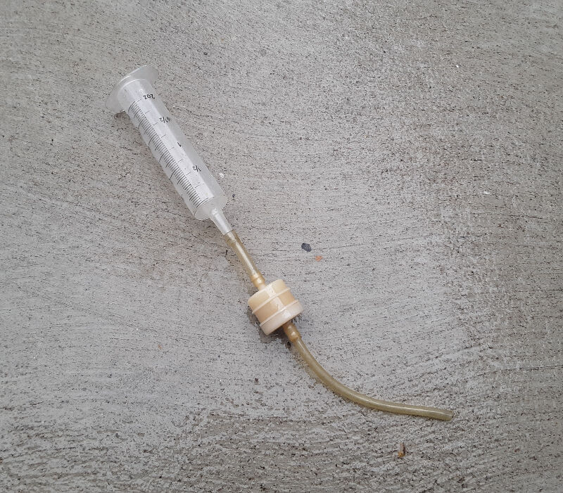

If this was mine, first thing I would do is to check your valves as already suggested. If within spec, at least you ruled that out. #2 hook up a temperorary fuel supply. Below is what I use. Remove the vacuum line going to the petcock and plug the nipple, Remove the fuel line going to the carb, and install temporary fuel supply. See if this will allow the bike to run. #3 Hope Greasy comes along and tells you what to do.

Thanks, I'll check the valve clearance tomorrow. This afternoon I rigged up an auxiliary fuel test bottle as you suggested. No change. It's definitely getting gas.
