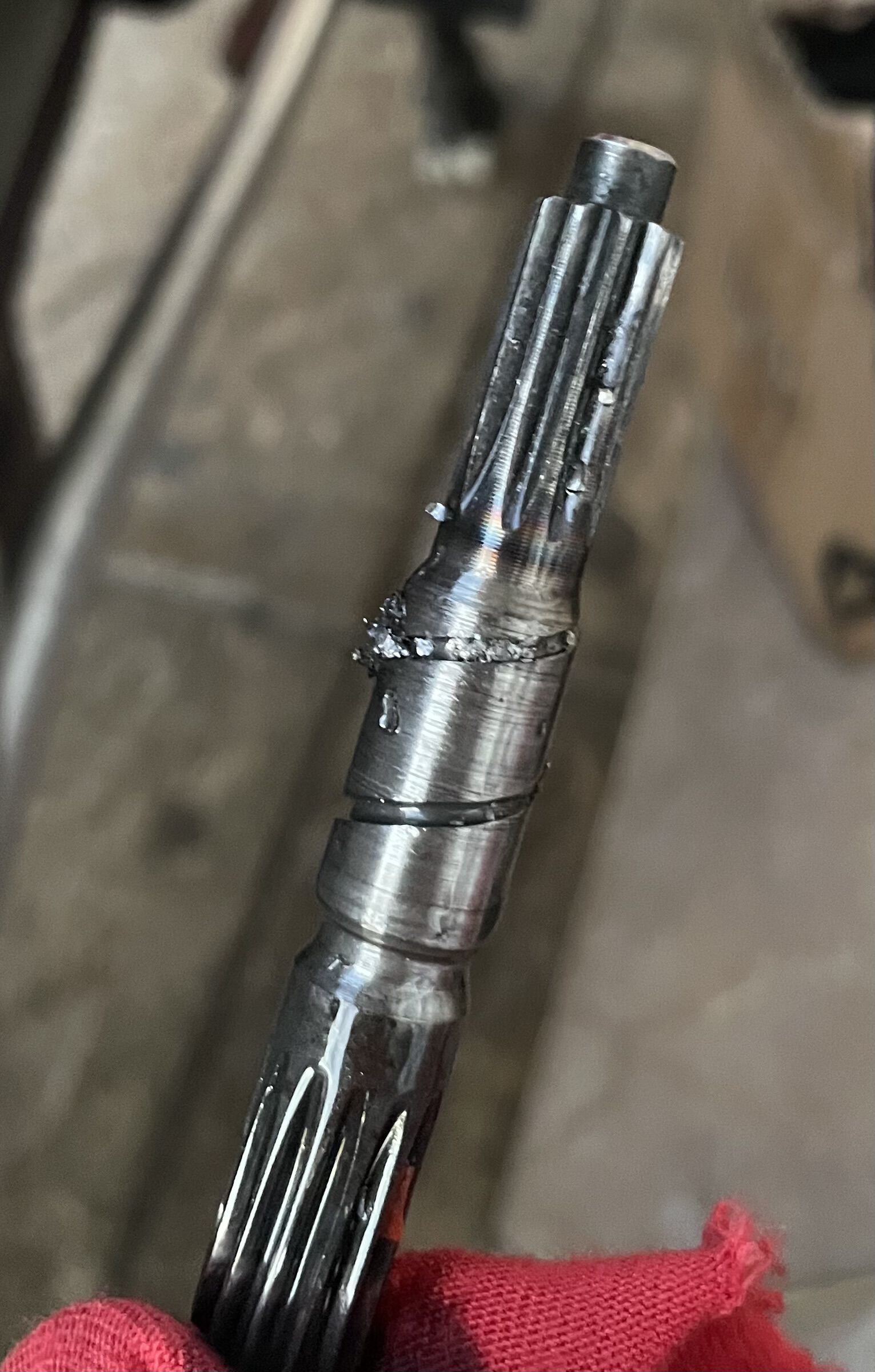

Update after a month
I took the time yesterday and took everything apart, including the oil pump ofcourse.
1. 1st thing I noticed was metal shards on the shaft drive. I can't figure where they came from, everything in the airbox were clean
2. If the siege was caused by lack of lubrication, that seems to be the "nipple" that drives the pump. It looks maximum worn and I have to replace it if I find the cap. The pump gear is good
Edit: I m thinking about the possibility those metal shards on the shaft, to come from the "nipple". They stick to a magnet so they are not aluminium
Can I just tap the oil line, leave everything in place and run premix temporarily till I find the part? All this time I was running the scooter with 1% premix for safety, and the pump working (oil was going down in the tank but I am not sure if it was ending up where it is supposed to. Some of it was leaking out of the carb box for sure). Considering that I was moving small distances around in town, I think 1% would be sufficient even if the oil didn't end up in the carb like it should
