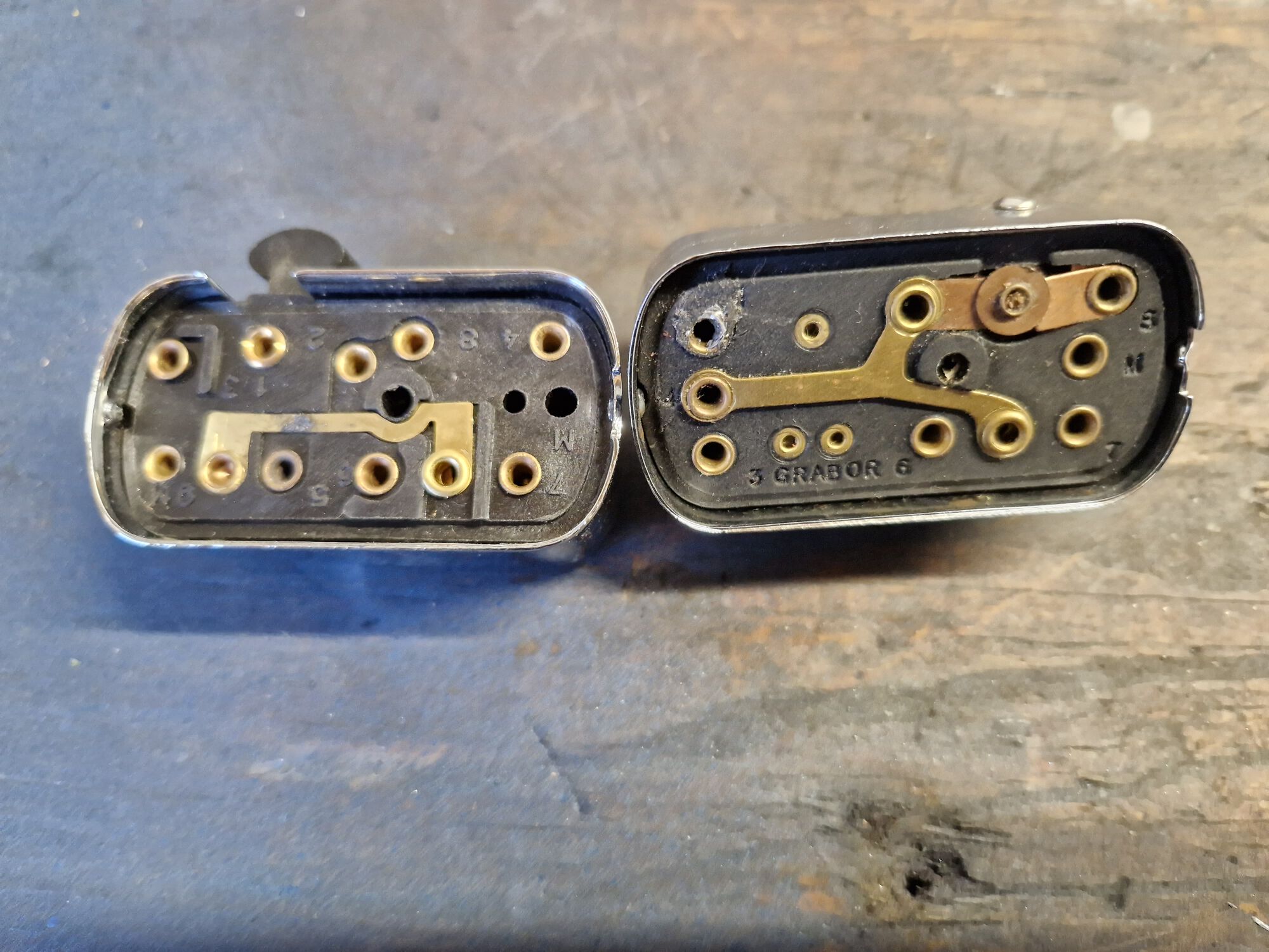

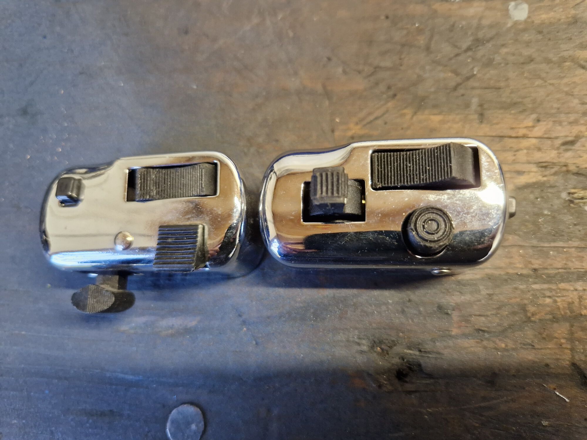

Are either of the two sets of switches pictured below suitable for 12v AC? (GL so no indicators or ignition switch)

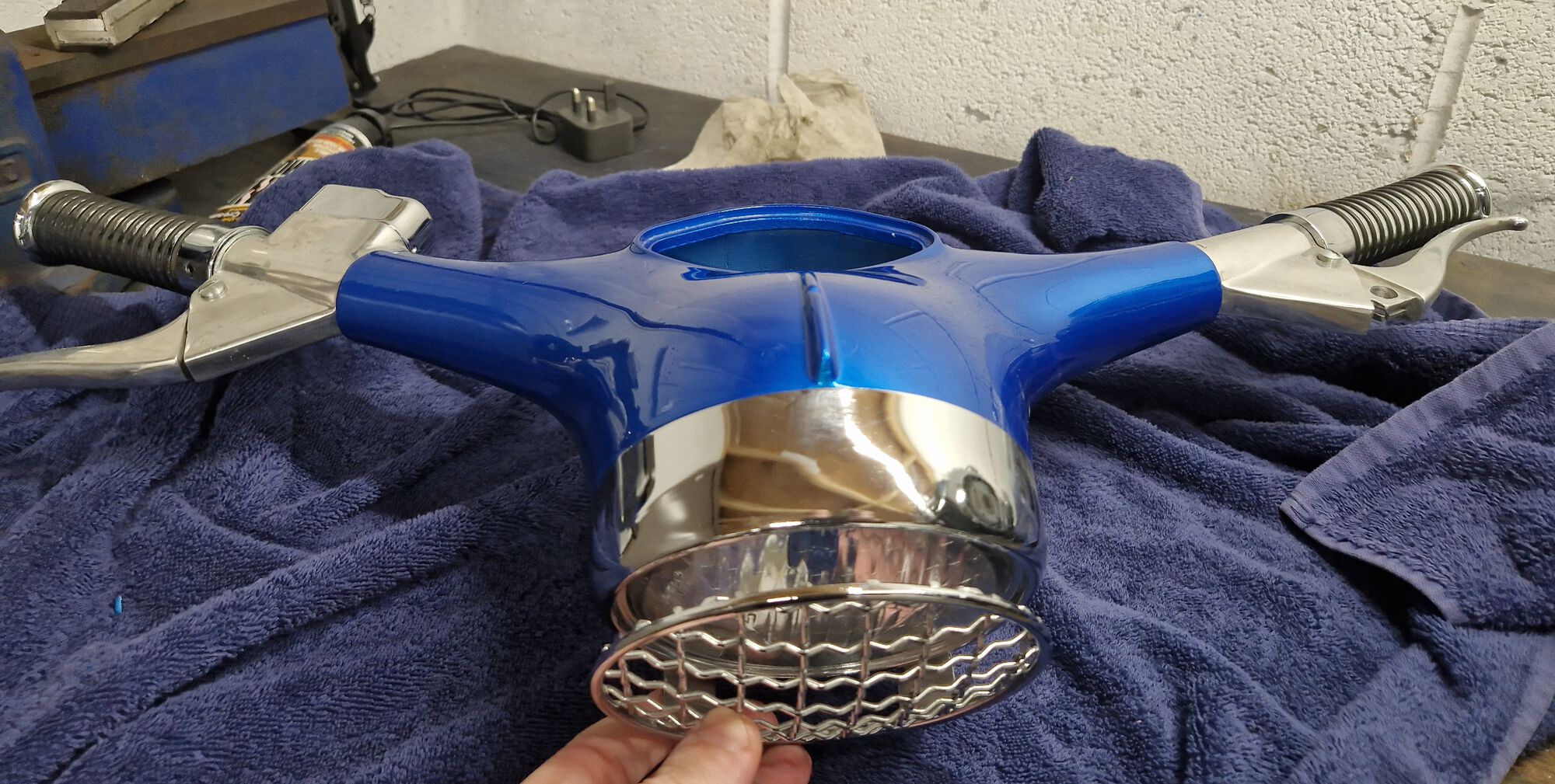

I've also got a SIP Speedo so I need a switch for it. There's no obvious place to mount one on this headset. I'm wondering if I could use one side of the indicator switch or if I need to buy one of these (assuming this is the right one) https://www.sip-scootershop.com/en/product/light-switch-sip-conversion_60091300?usrc=Light%20switch
I've read about the mixed results of using this Speedo on AC, but I plan to give it a try rather than converting to DC. I'm basically assembling what I've got for use next spring and I might have a rethink and rework next winter.

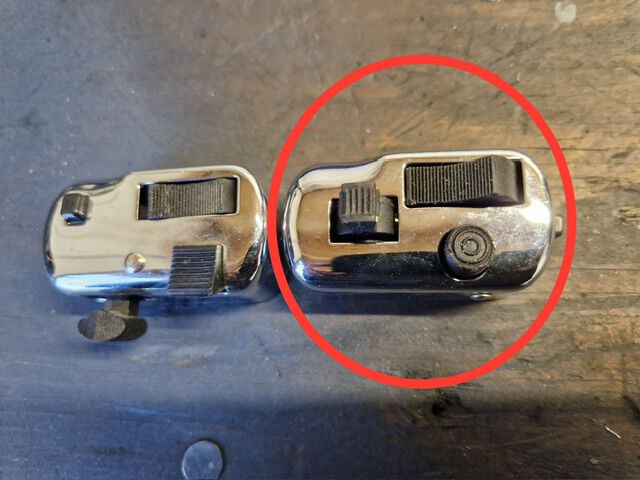

I think the one on the left maybe correct for AC.. but I am not good with electrics.

I have the one circled on my GL.
Shouldn't make a difference whether you run 6V or 12V AC through it.
