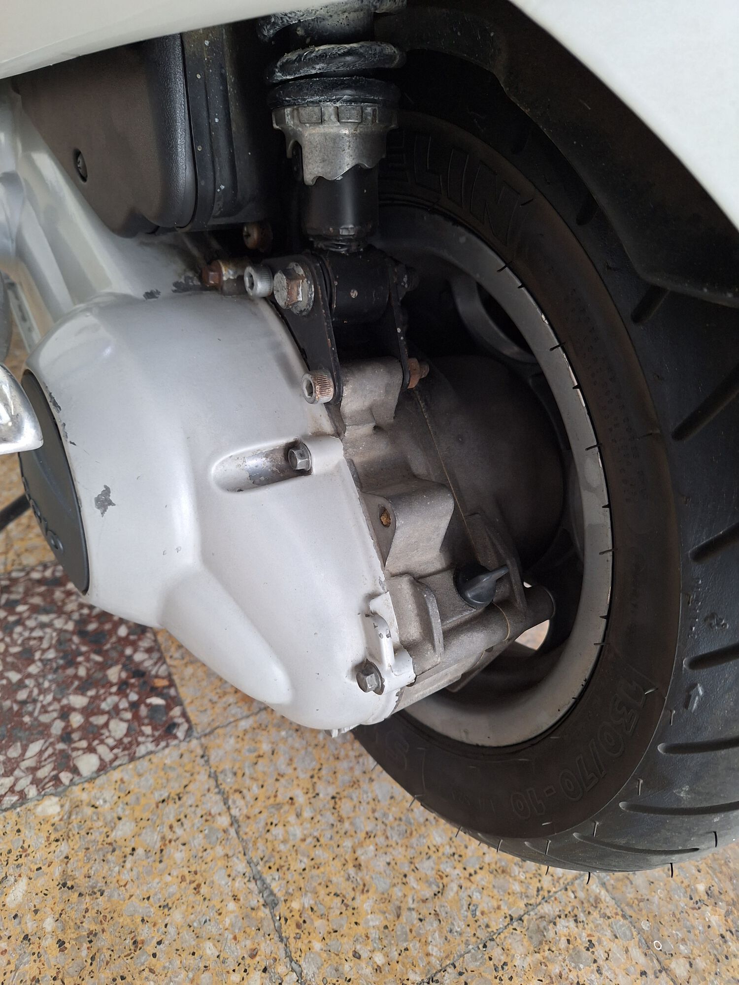

Here they are

Back

to answer your question, no, that is not normal.
looks like somebody swapped in a Piaggio Sfera front fork from the early 90's
luckily, those cables are widely available. so I'd just replace it and carry on.
the cost to swap back to the proper components would not be cheap.

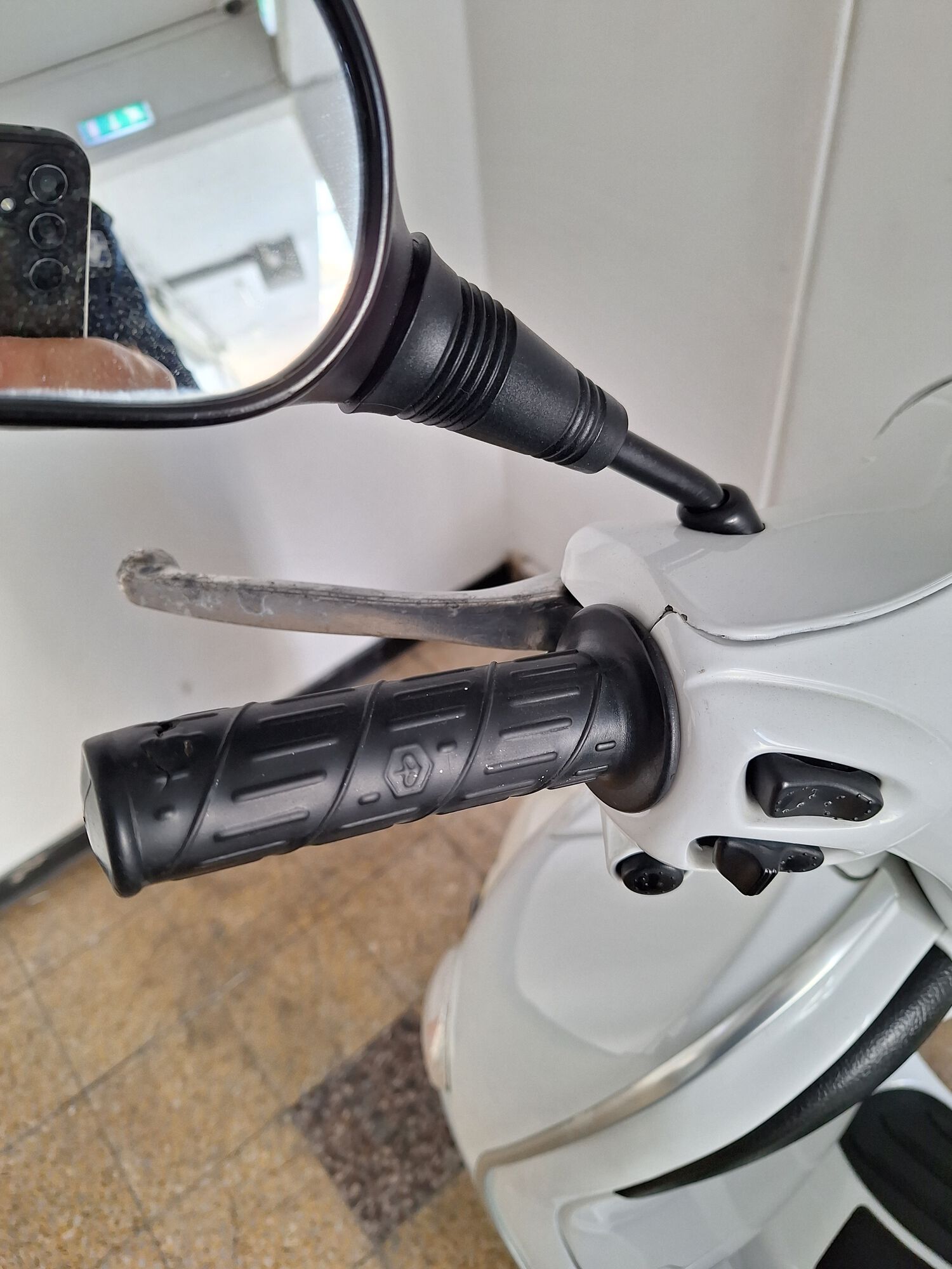

however, I don't know what they used for the brake lever perch but if I had to guess it's probably the sfera pieces. how do the back of the handles bars look, where the grip and switches are?

Here

Another

More

Plus this

this is going to sound rude, and really, I don't mean it to be but we can't answer any of those questions definitively.
anything is just a guess, to be honest. I'm *guessing* that they put the ET handlebars on there because the covers appear to kind of sort of fit. but unless you blow it all apart and show us pictures anything more is just a guess.
again, guessing here, but I'd think that the front brake lever and perch was scavenged from the sfera and just scabbed onto the et bars where the stock master cylinder would go. that would make the most sense in terms of easiest path with least amount of mucking about.
so basically, anything you need for the front end: brakes, shock, brake cable, lever are all more than likely sfera. all the rest, ET. maybe.
