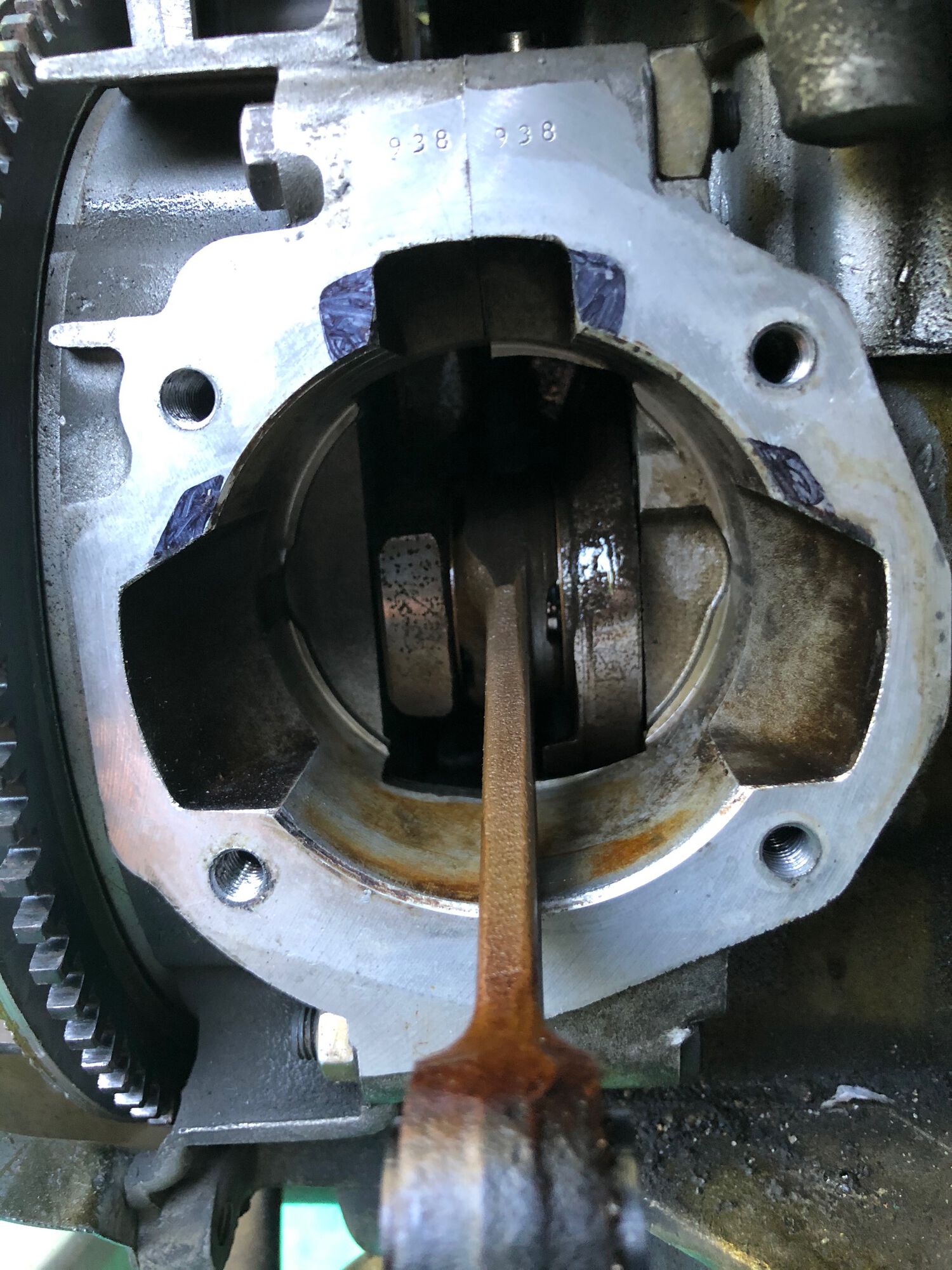

I did the unboxing just now. See it for yourself.
https://youtu.be/eHkgqwPvnuo?si=iJ3vkDFKRnEV9nL0
Actually I don't think it's a new case and it's definitely the reed valve version. The VIN is stamped and I assume it's painted silver on the outside.
It's a good case but sure it's not new.

Not new, but not bad.
Unless they have been machined off, there should be numbers stamped on either side of the face where the cylinder base gasket sits. It would be better if those numbers matched.
These days, LML reed equals premix unless you already have an autolube reed block at hand. New ones are no longer available.
I presume you will be replacing those bearings.

Yes, I run everything on pre-mix and AC voltage.
Actually this is the first time I have this case in hand (I got used to those old Piaggio cases) and I still can't figure out how to mount a SI carb onto this if it's possible.
And the CDI? Where to mount the CDI? Wha? emoticon
Yes, I took out all the bearings and bushings. Washed off that lovely paint with some thinner.
I checked it. One side says 200 and the other is off the edge and I can see 00 only.

the numbers don't even match in how they are stamped, much less being the same number. i don't have a good feeling on that.

There have been discussions about mismatched case halfs in the past. I don't think it's a death sentence, just suboptimal. I asked mostly because it is the kind of thing I expect from Indian eBay vendors and wanted see if expectations were met.

I wouldn't worry about whether or not the halves match. Those cases were in somebody's scoot for a long time based on the motor mounts.
The odds that dude found two used, mismatched cases with the last two digits matching seems a lot lower than that they came out of a dead LML motor and he was able to sell them to you for the cost of a can of silver spray paint.

He made them match (sort of) because the stamps are from different tools

For comparison, here are the numbers off a couple sets of LML/Stella cases I have lying around.

Zeros look the same shape on both, probably not punched hard on the flywheel side. Anyways, main problem is they sold you used, painted and different cases than advertised…

Photo is my 2005 LML/Stella.
Same as chandlerman's.
