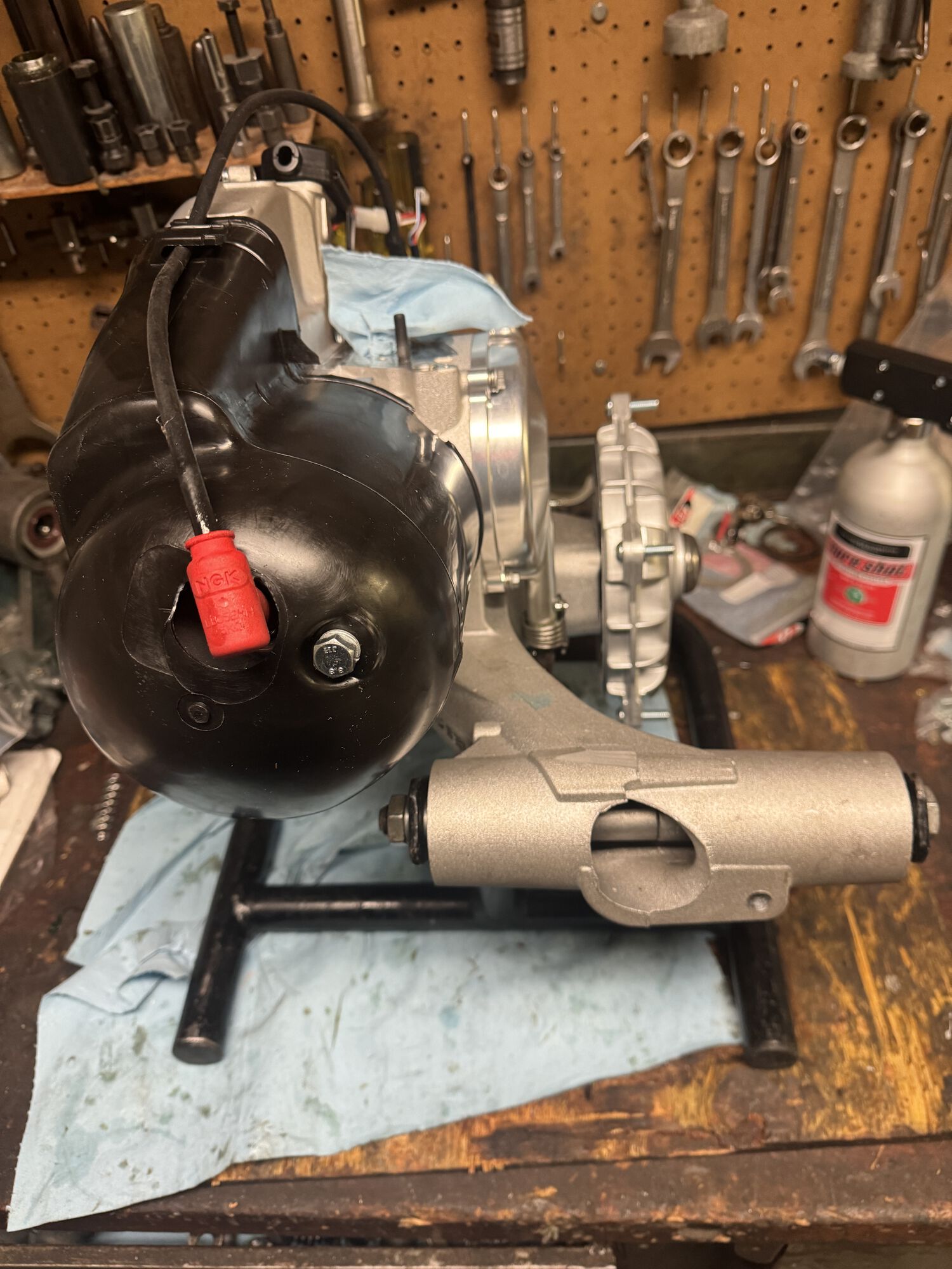

While I was working through my Rally 200 engine with significant case issues, I built an engine with all new parts. . . Every single one of them. I left nothing on the table and used the very best that is in the market today that I thought appropriate for a Rally with stock brakes and suspension.
My German market Rally 200 is non oil injected, so I left out the oiler gears and used a machined plug to fit the oiler hole.
A few specs:
Malossi V-one cases
Malossi 210, Sport version
BGM 57mm crankshaft
SIP PX output shaft & gearset
DRT Long 3rd gear
65 primary/piaggio PX Xmas tree
BGM primary repair
23t VMC clutch
BGM clutch cover
SIP Vape ignition- static timing
Scootopia rear drum
sprint/rally kickstart quadrant
Over 4K to build it out.

Any fitment issues among all the different suppliers?
@gickspeed avatar
Posts: 2514
@gickspeed avatar
Posts: 2514
None.

What exhaust are you going to use with the 210 Mark 3? Just built one last week, and the exhaust manifold Allen bolts hit the exhaust clamps I was using.
@gickspeed avatar
Posts: 2514
@gickspeed avatar
Posts: 2514
i would most likely mount a ceramic coated Polini Box.

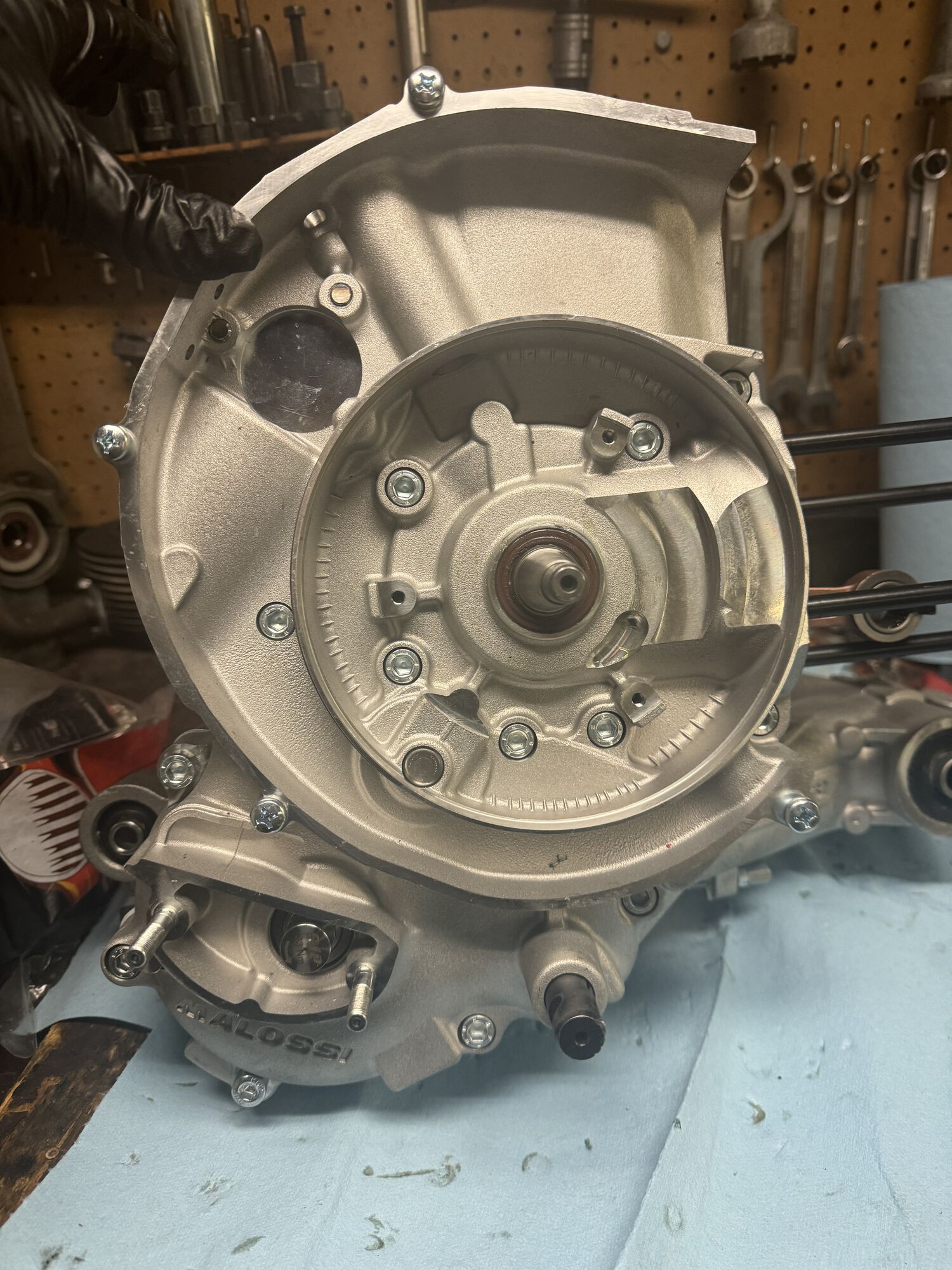

any port work on the cases or straight P&P on the kit?
beautiful work all around

Boost ports seemed to have been enlarged "worb5" style…
That 0.8-1mm base gasket will be pretty much perfect for the Polini.
Not sure if you would need to take anything off the top of the cylinder to balance the squish. 1.3mm to be riding all day. Lower compression head maybe too?

i widened the exhaust port to .68 x bore, then polished. Top transfer in the cylinder is opened up as it's constricted there. The piston is opened up. Nothing radical.

I'm building similar at the moment... can you guide me to the correct installation of the block off plug for the autolube? The Malossi instructions aren't very helpful
I've got the o-ring to pop on there somehow too!!
that is the correct orientation. there is a little o-ring that is added to it.

Okay, I probably have it right then, o-ring on the second groove... the top of the bung sticks out, thought maybe the carb box might "cap" it down and seal it off nicely. There's nothing really holding it in place.

If you're not worried about using it as an oiler you can epoxy the plug in.

Did you happen to polish your ports on the case before it got assembled or does it make any difference? I only have one mold line. Looks the same as yours.
