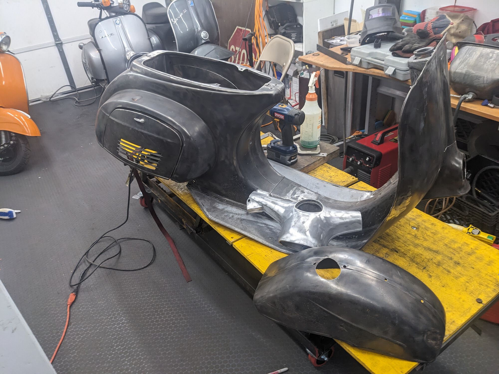

This week, I'm taking off work because I'm into "use it or lose it" for vacation time coming to the end of the year. My wife asked me, "What are you going to do all week?" because she's not taking the week off.
"Y'know," I said, "I think I'm going to repaint the white scooter."
And, true to my word, it has begun. This afternoon, I went and bought paint, then came home and tore it down other than pulling the last of the wiring out of the frame and the mudguard off the fork.
Tomorrow will be car wash time to get the bulk of the schmutz off and then the work will begin in earnest. I'm going to replace the floorboard and modify the engine door to fit the Quattrini cases.
The floorboard is going to be trickier than I was expecting because of how it transitions to the legshield, but I think I'm up to the challenge.
Then I just have to hammer, paint, rebuild the fork, then put it all back together. No biggie, right? Razz emoticon
Current considerations are if I want to install a SIP speedo (maybe? Eventually?) and whether or not I'm going to order a new wiring harness (probably).
Anyways, everybody get ready to ride along for another fun workshop adventure!

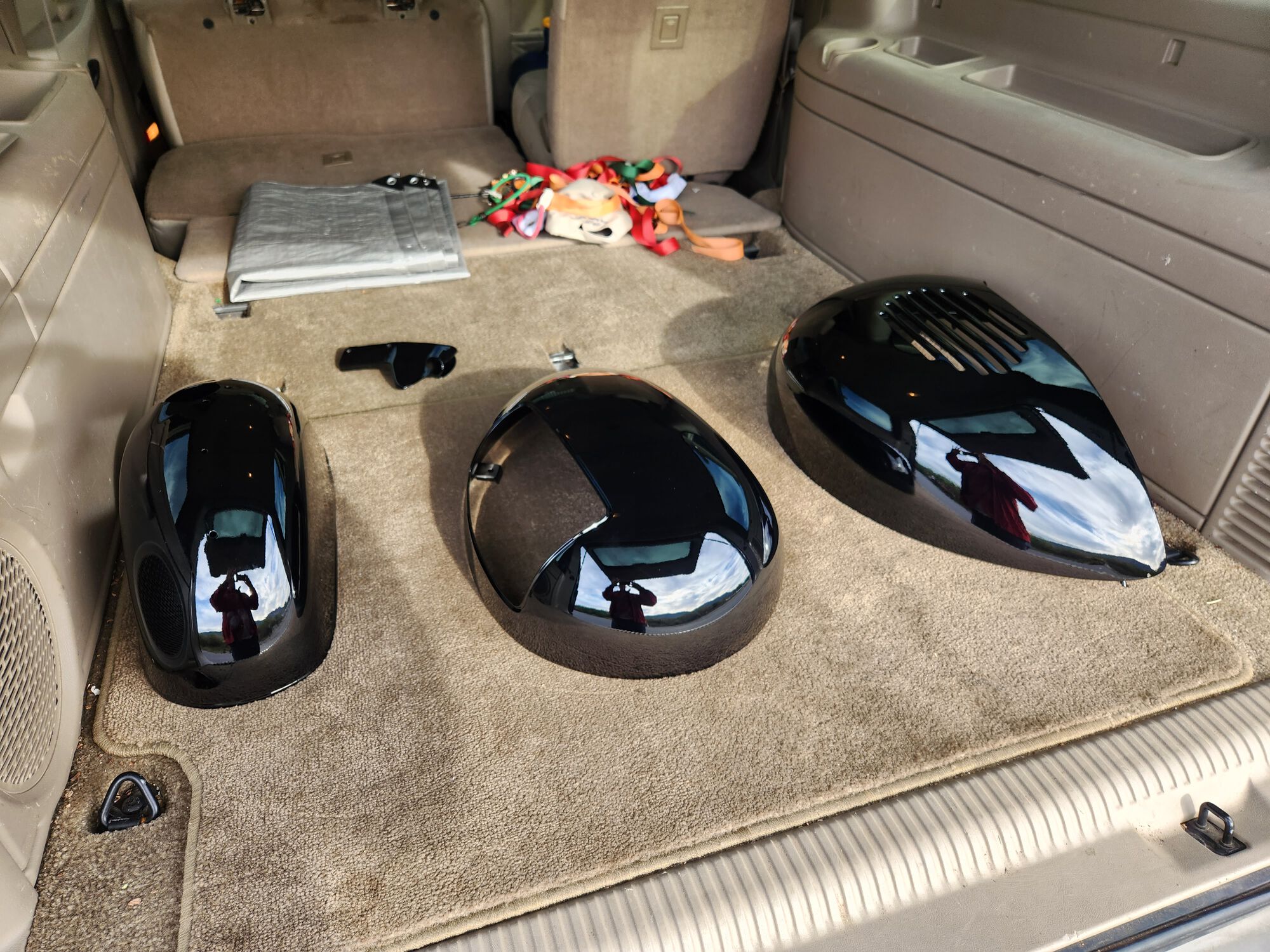

My GS is two stage gloss black. The P I inherited will have some metal flake with kandy green and solid green. I use House of Kolor for paint and Roth metal flake. Here's a shot of the GS when I started.

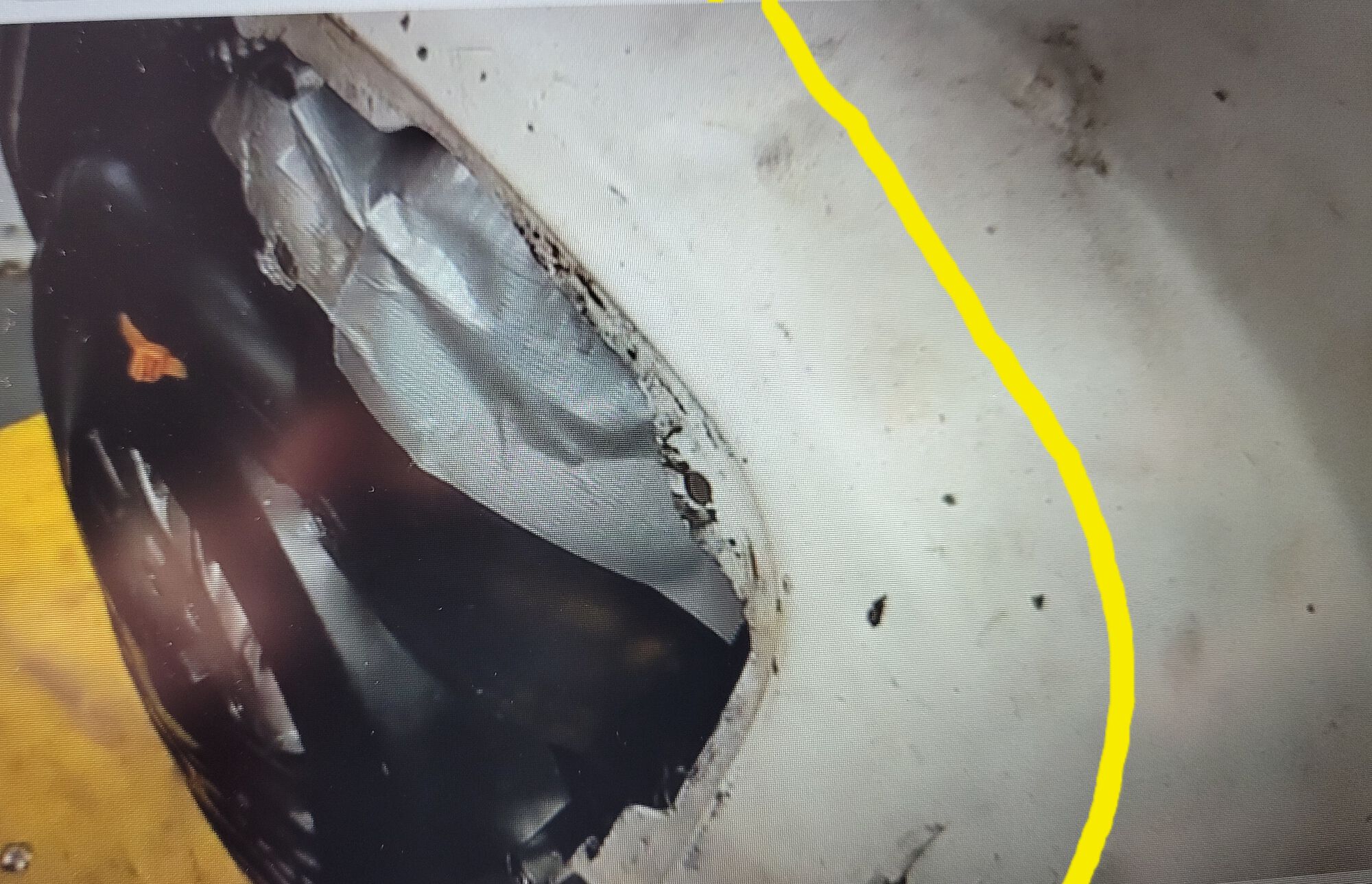

Are you going to use a repair sheet?
That damage at the base of the leg shield looks pretty tough to deal with otherwise.
You painted a GS 150 black?

Yep! Couldn't stand the original color and don't plan on selling it. Knew I would get some comments about it sooner or later. It also has a 221 going in. I have the original engine but needs lots of work to be a runner.
Yes, I'm replacing the floorboard and may have to fab some repair patches there, too. I'll have a better idea what's going to be required once I get some hammer and dolly work going, plus the floorboard replacement.

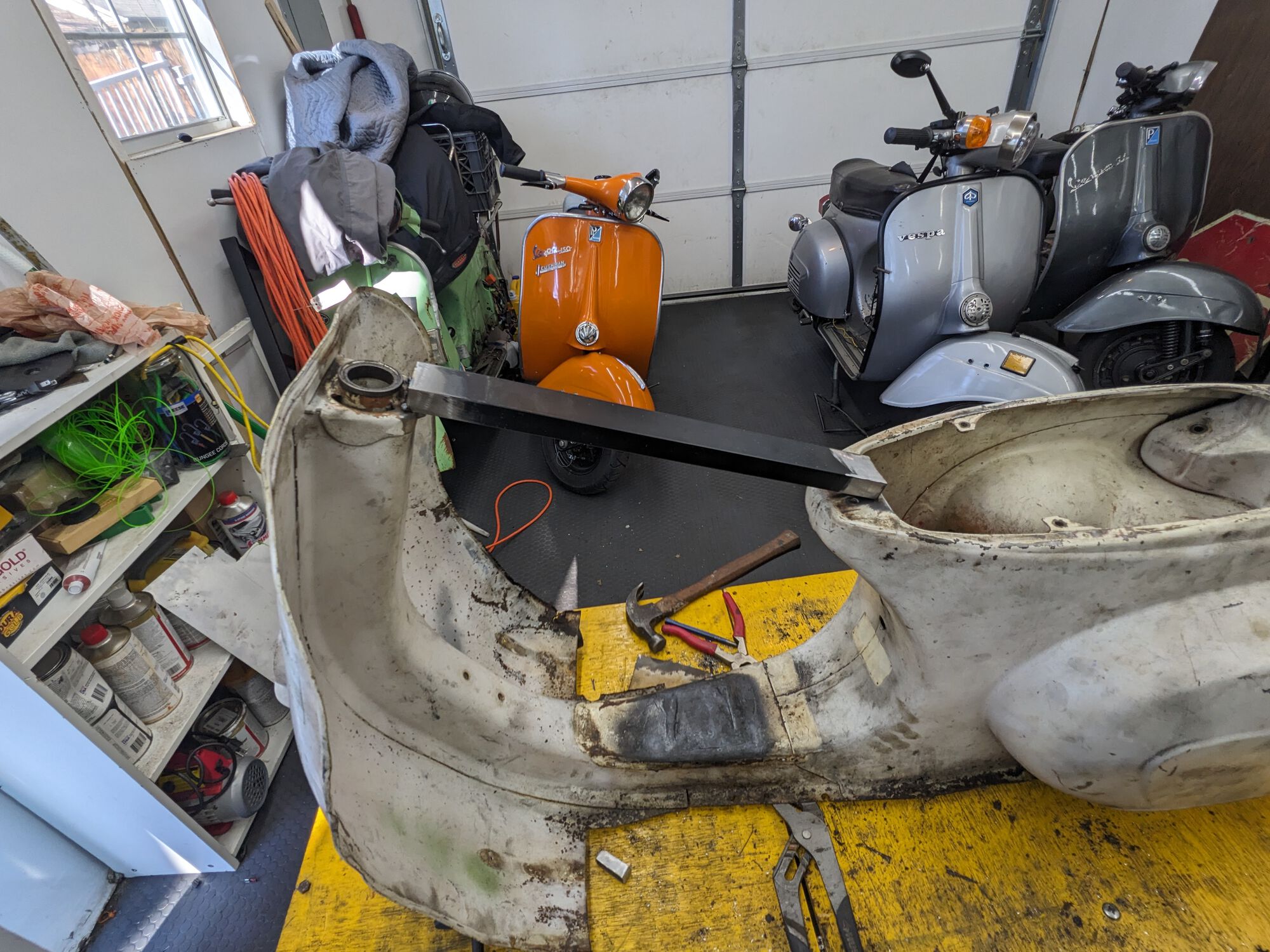

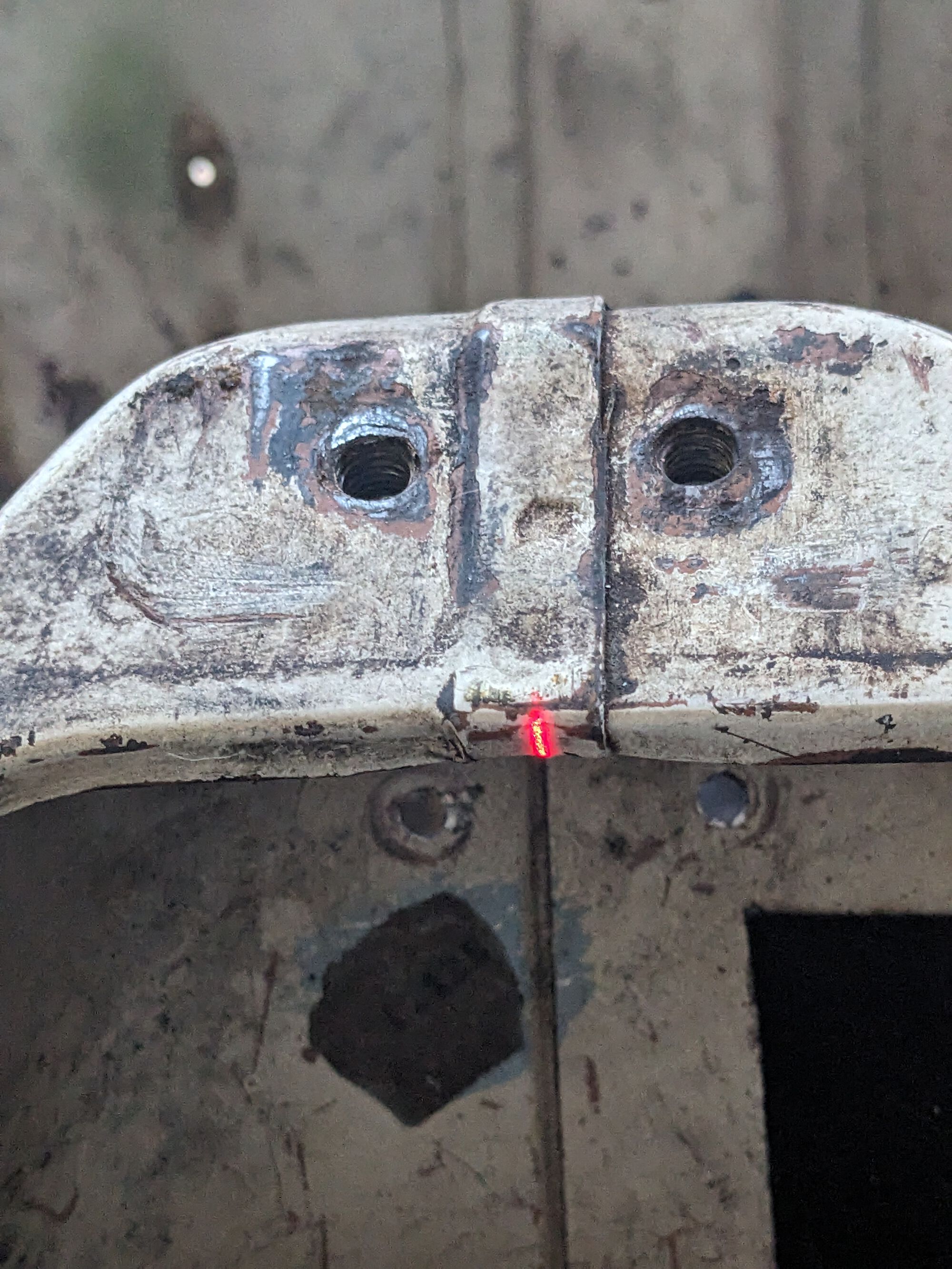

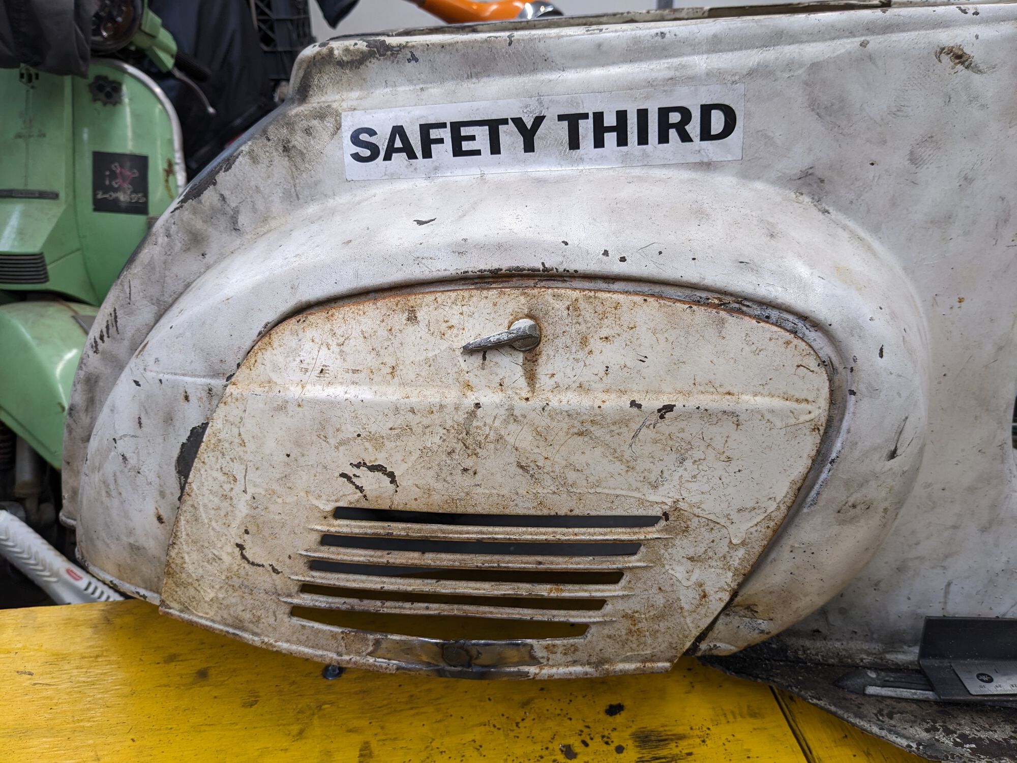

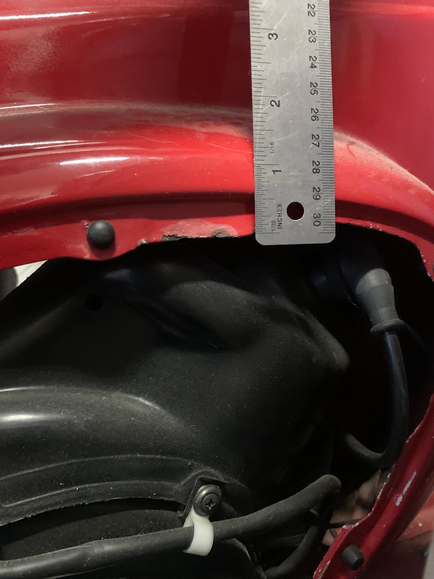

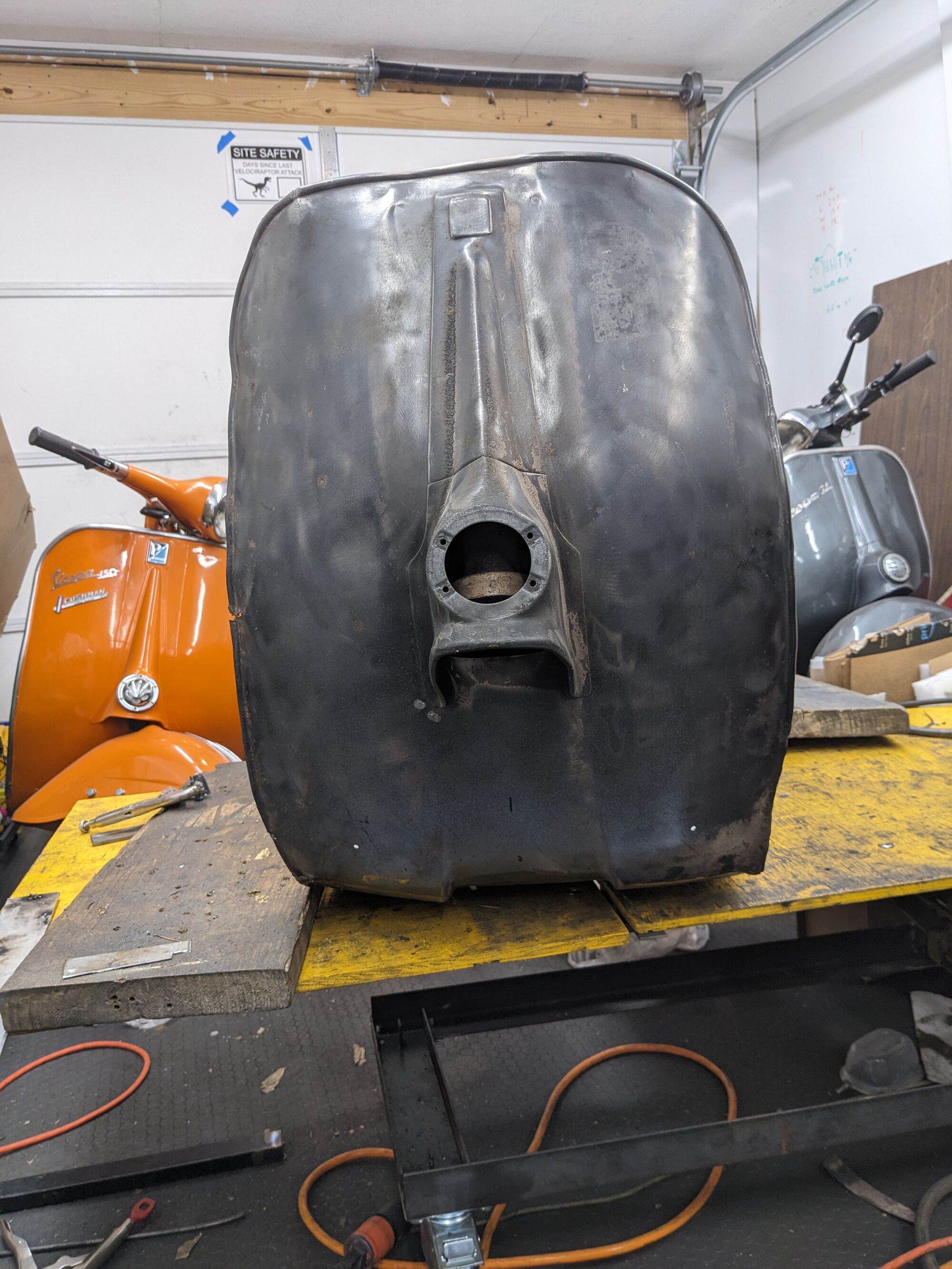

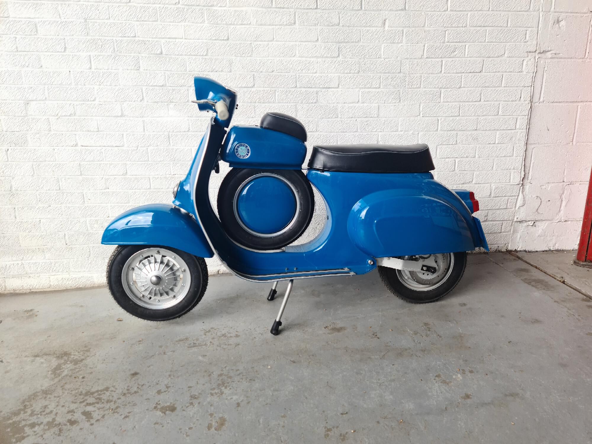

About the door:
"I'd" cut the cowl along the line in this pic and extend it so any door can be used/replaced. BUNCH of clamps and mark off a 3 or so inch sheet strip at a 1" gap and cut.
Tack and hammer/shape. It'll take quite a while and risk trashing it ROFL emoticon

About the door:
I thought about doing exactly that, but pulled up short of actually doing it because I wanted to make sure I didn't trash it. There are also some internal braces that will need replacement/adjustment as well.
If I try it and pull it off, it'll definitely be one for the ages, though...

Should be fun!
I did see one smallie door idea where they used standoffs to push the door out. Gap all round, so ventilation was improved as well (found my saved pic). I assume they're allen headed screws you can see in the pic.

My original (and maybe still) plan was to to cut something that basically winds up looking like a scoop and go from there. I'll have to try and mock something up to demonstrate/test in the next day or so.

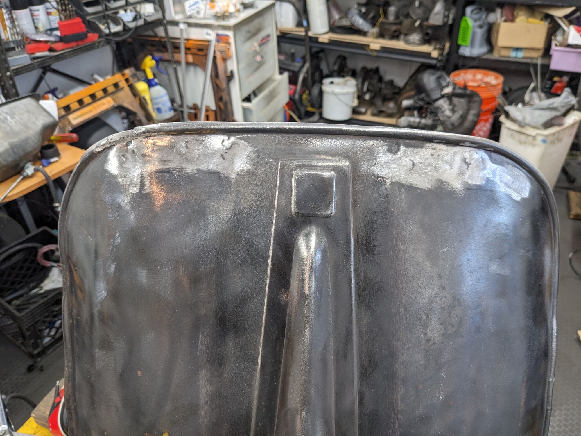

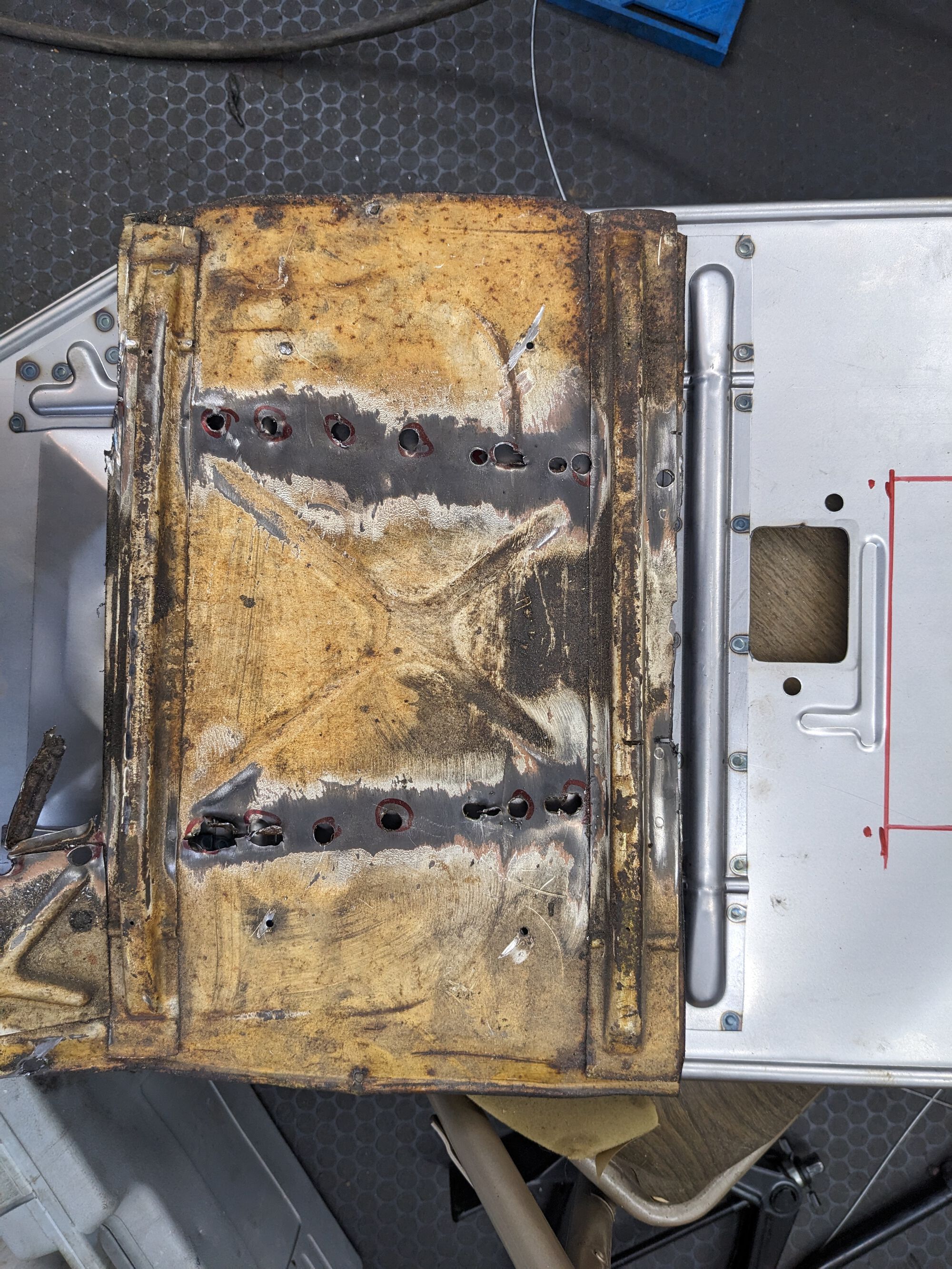

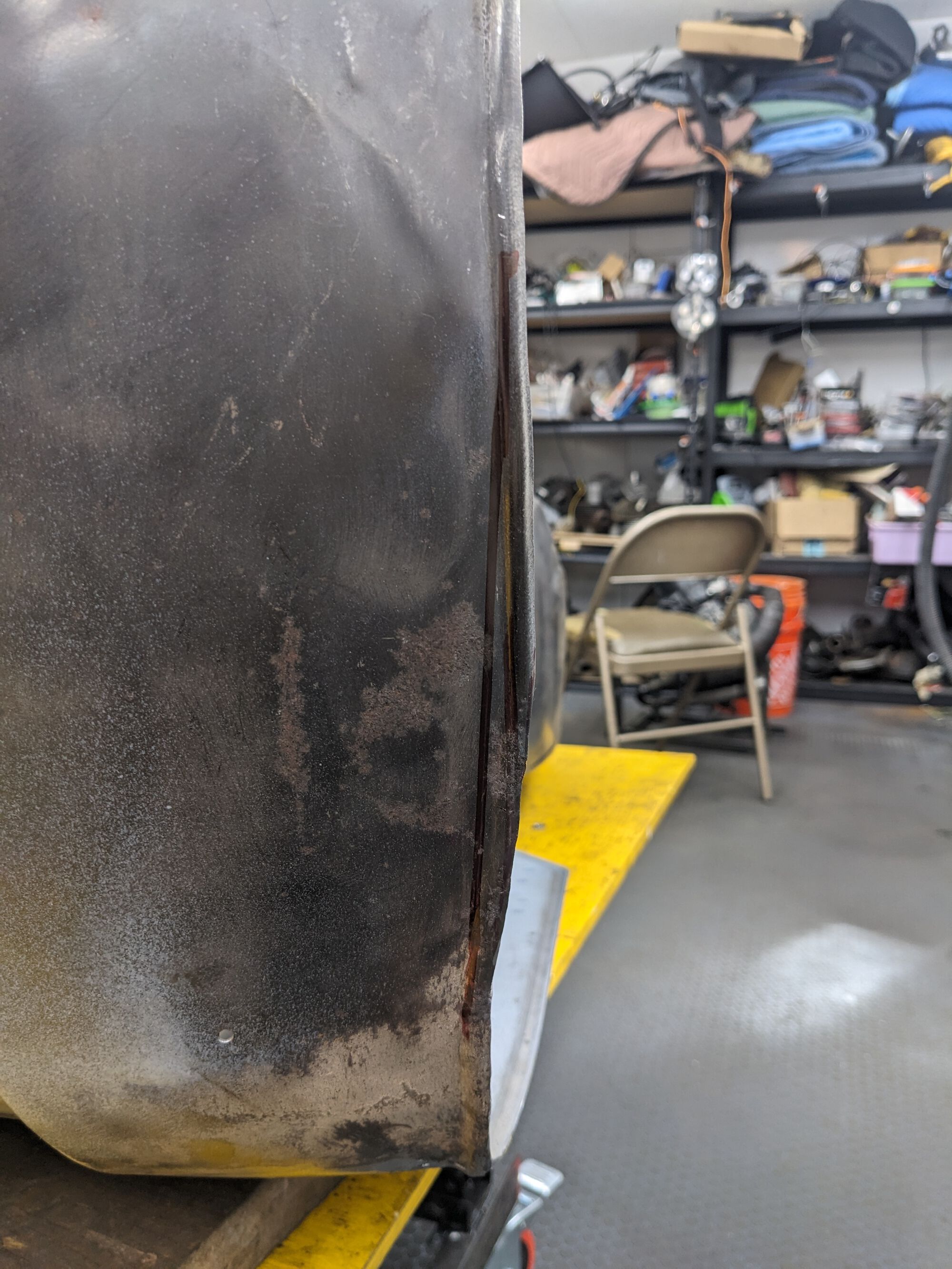

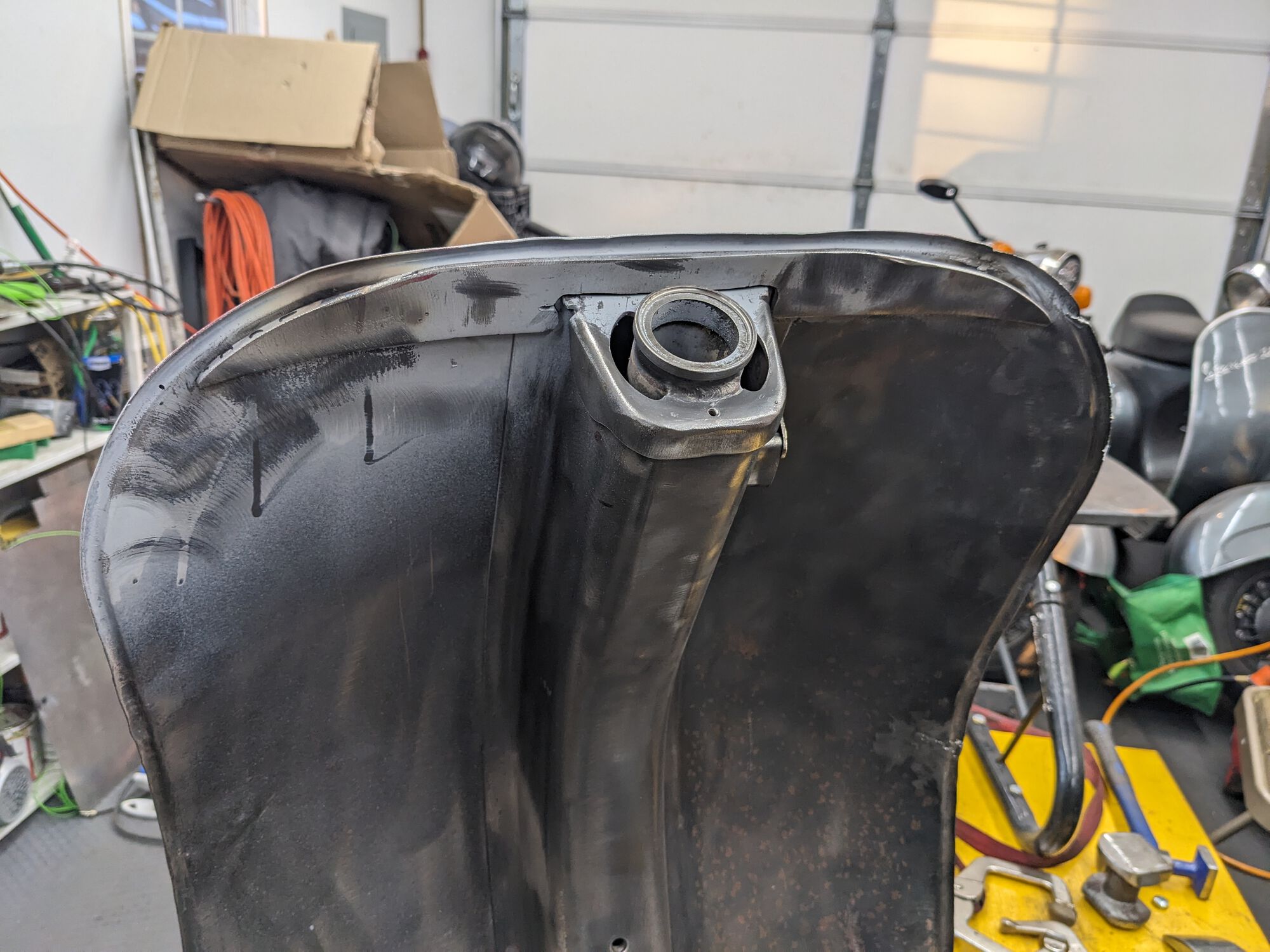

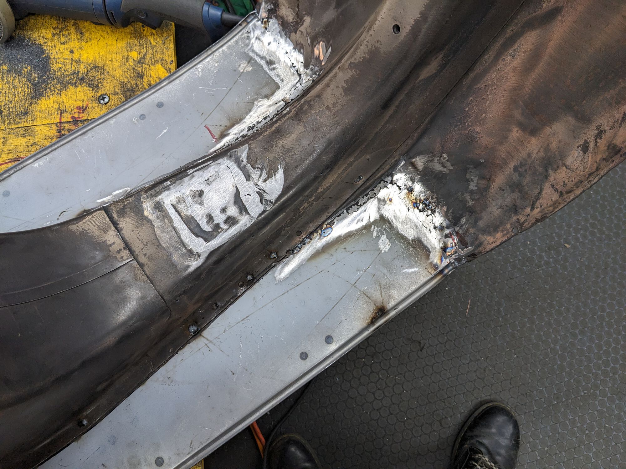

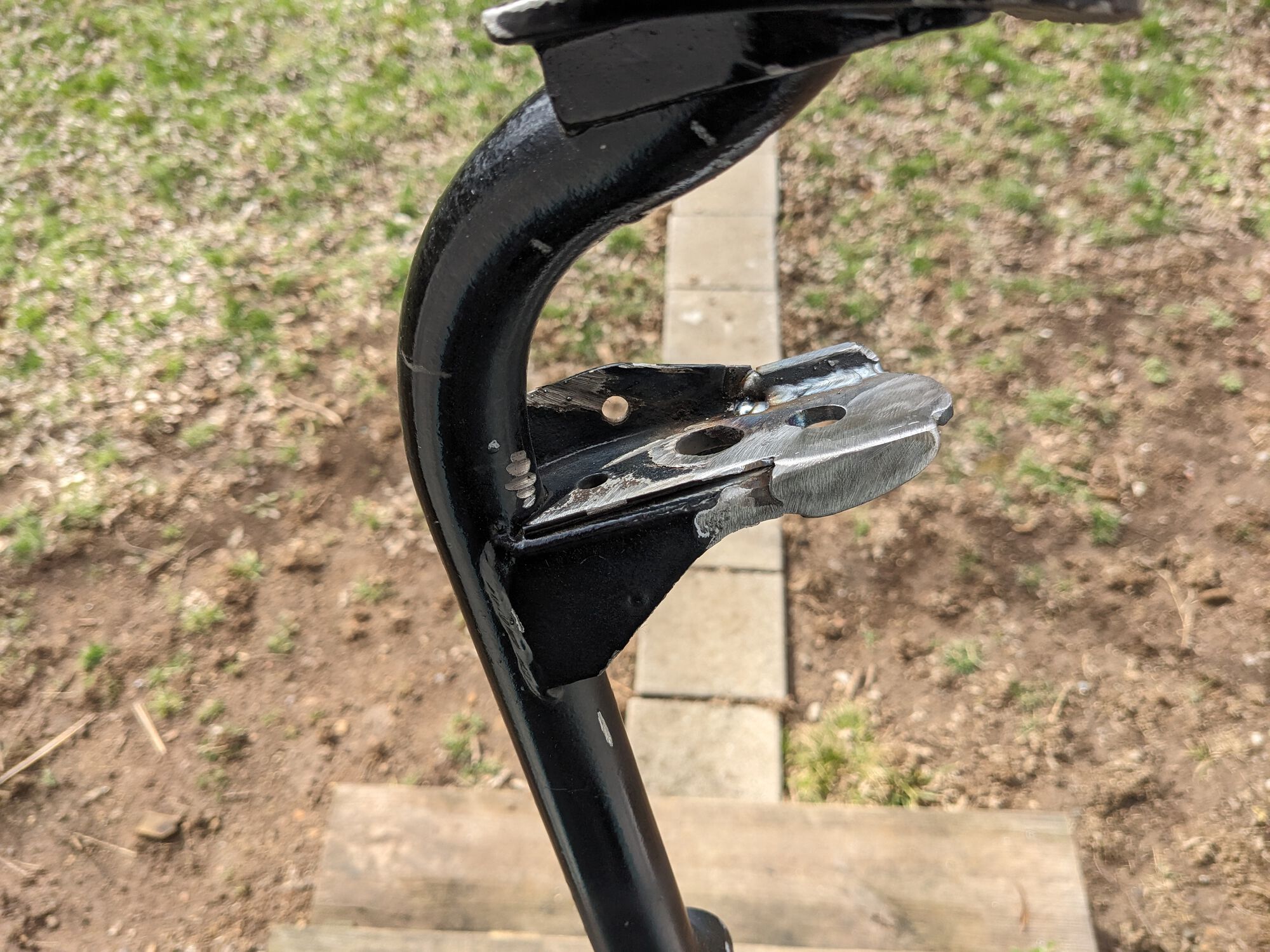

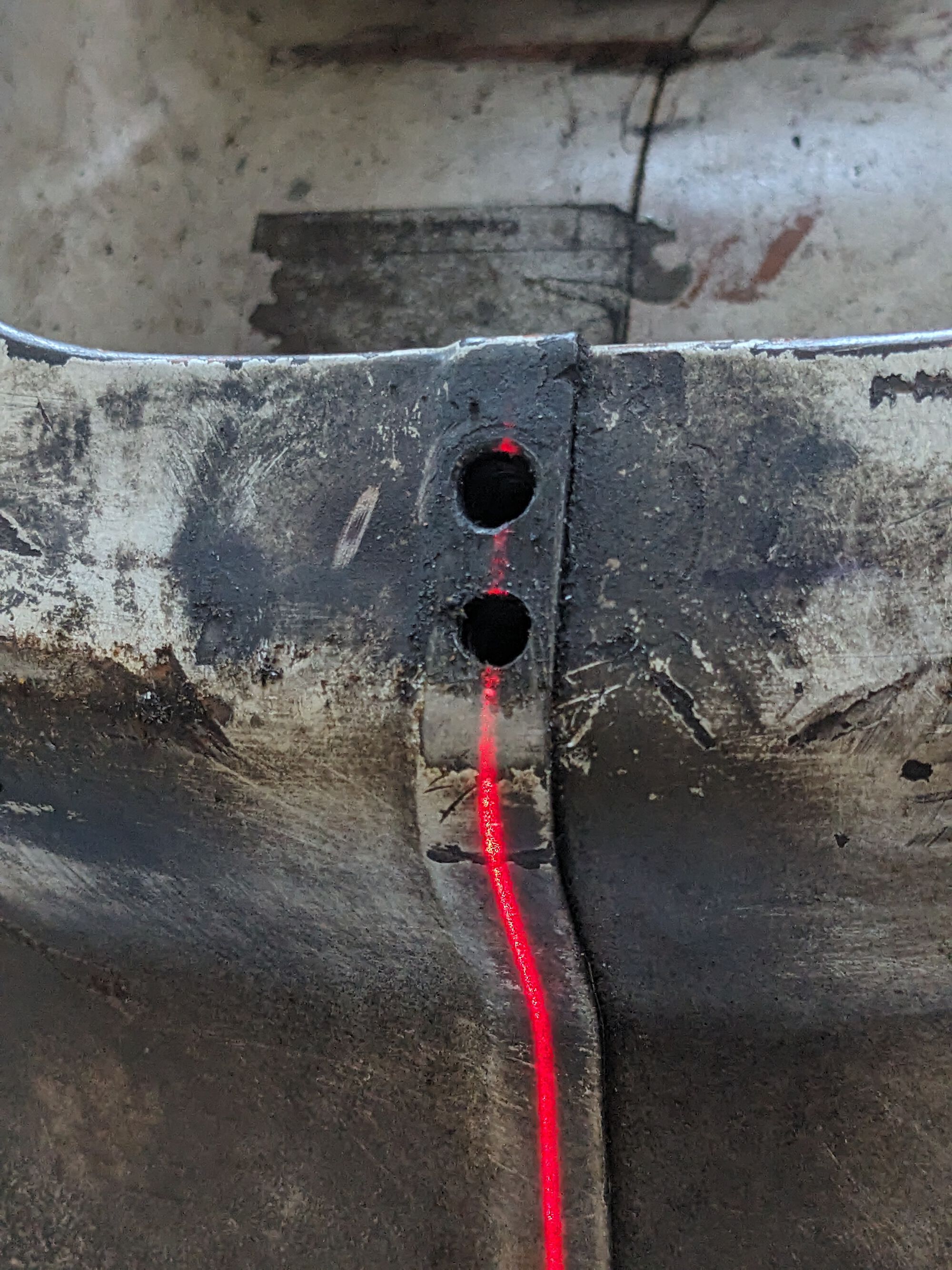

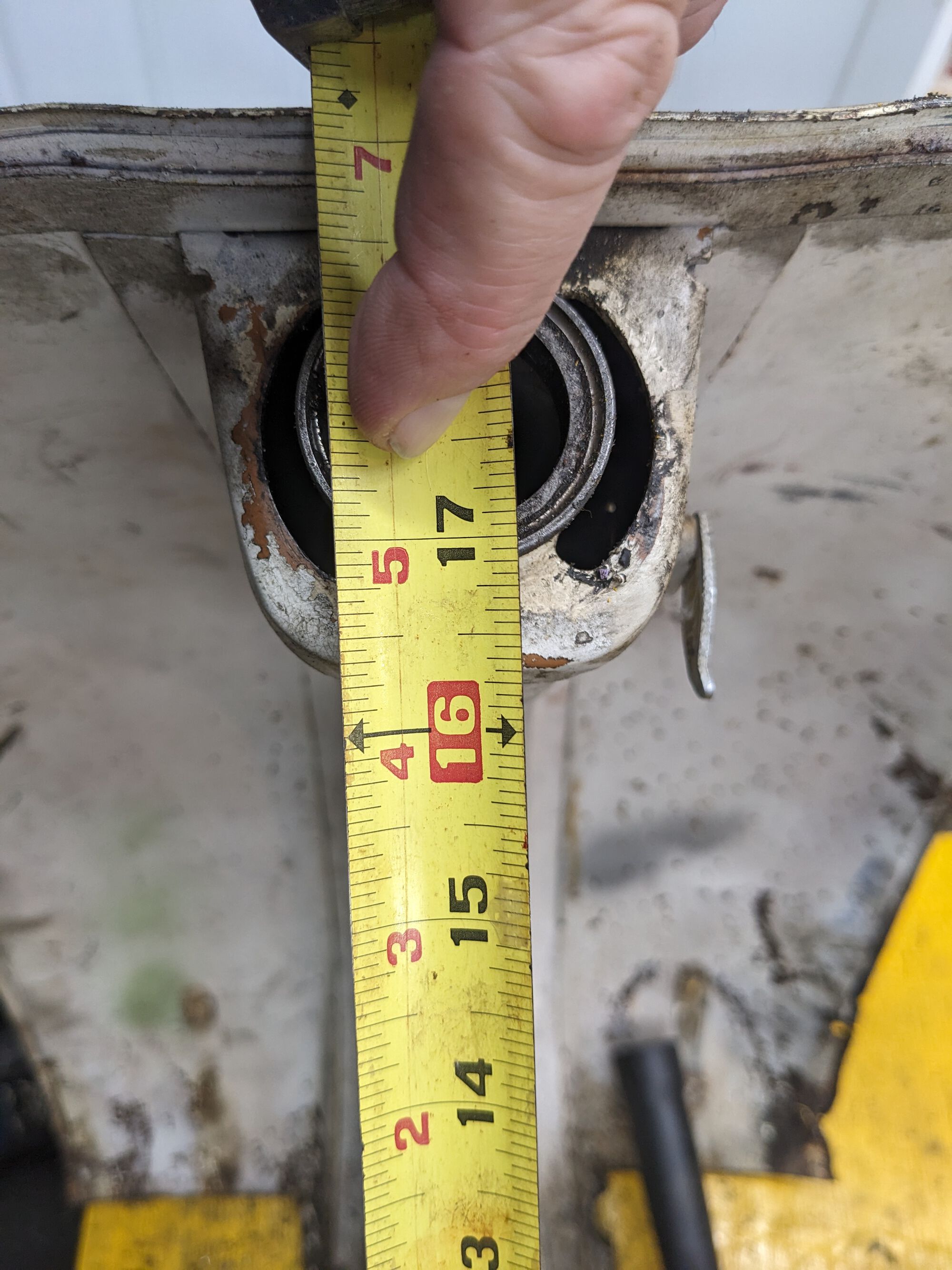

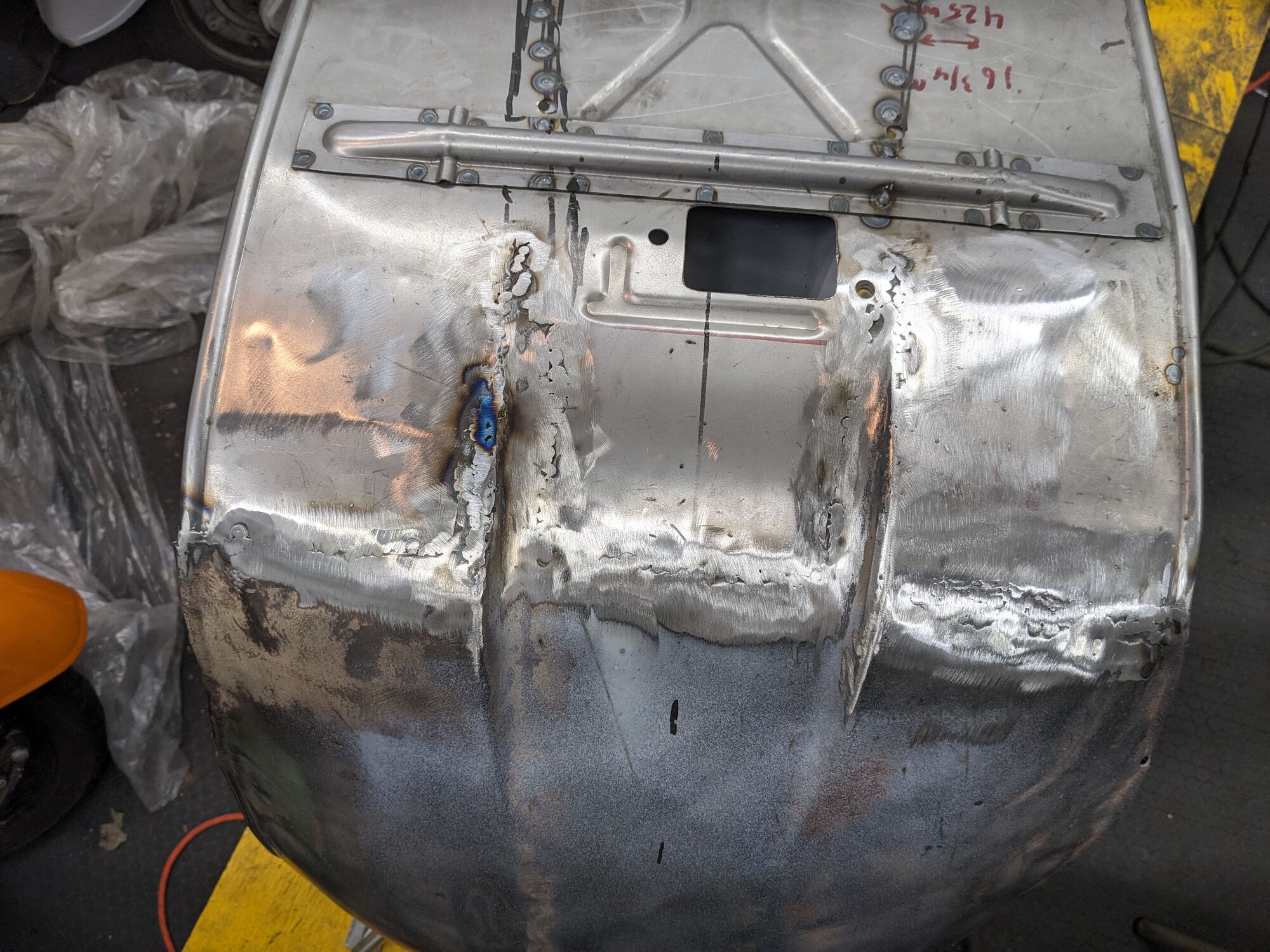

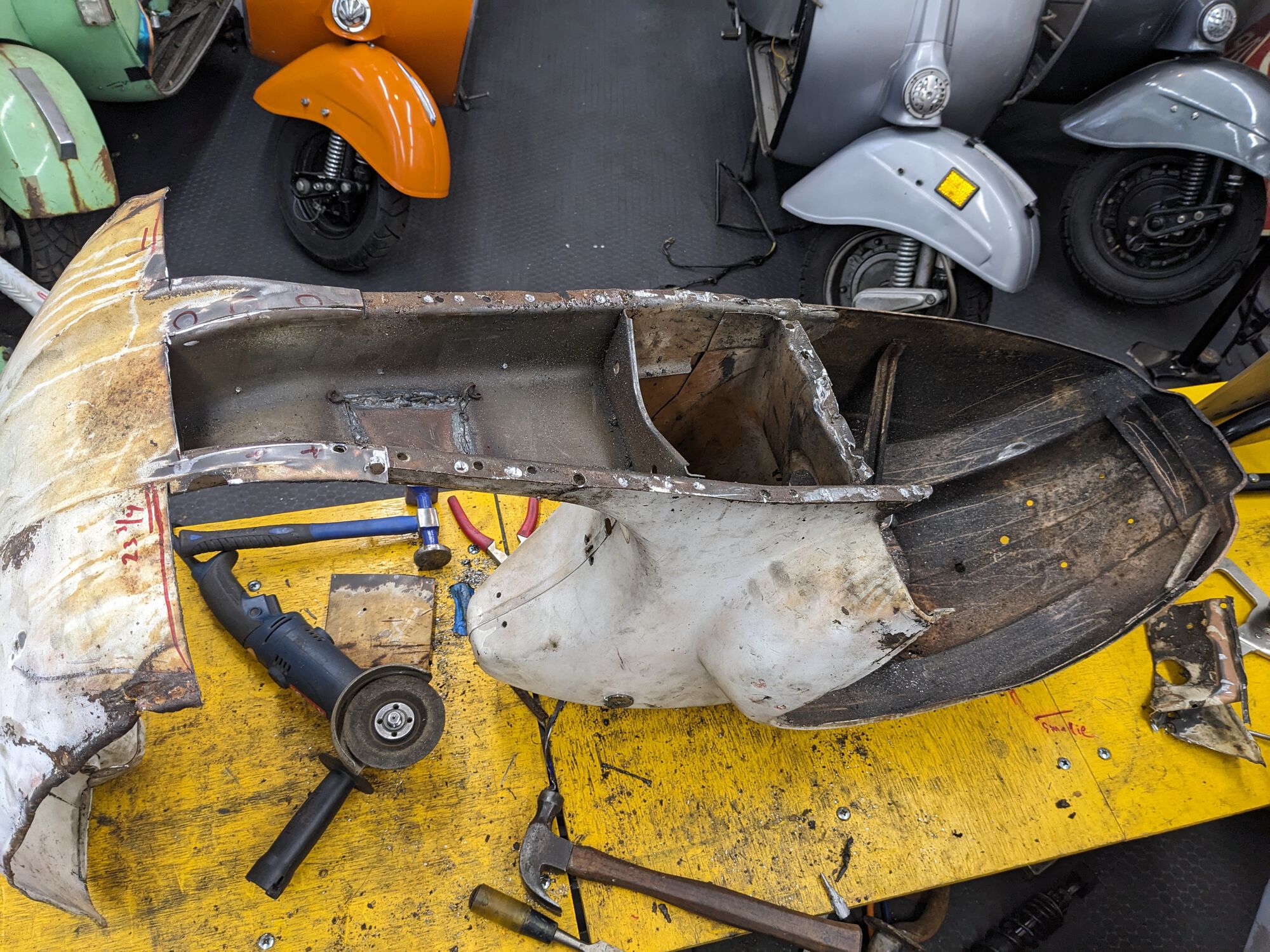

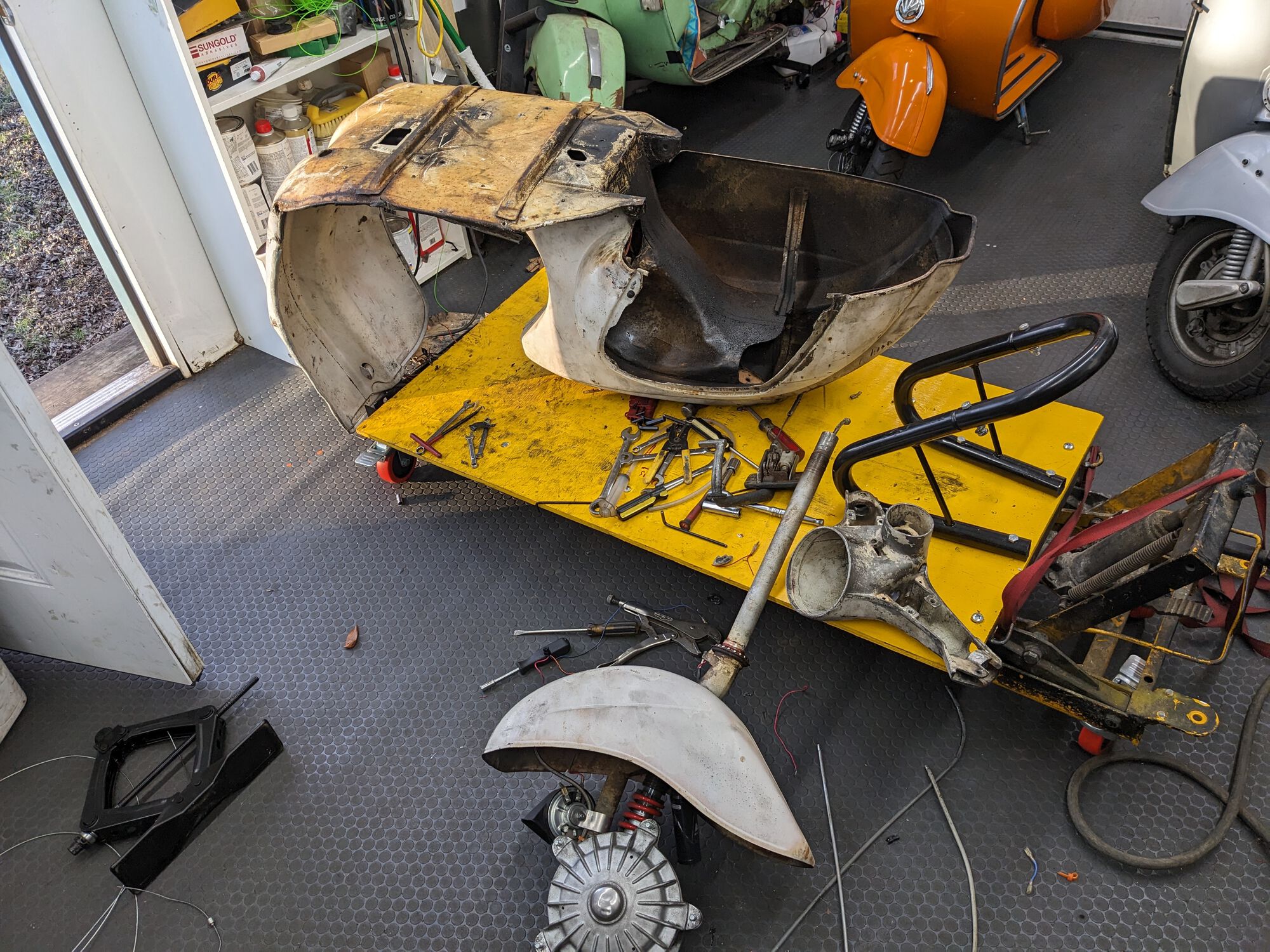

More progress today. I solved the engine door issue by adding a small section to the bottom which gives it enough clearance to fit with the Quattrini motor.

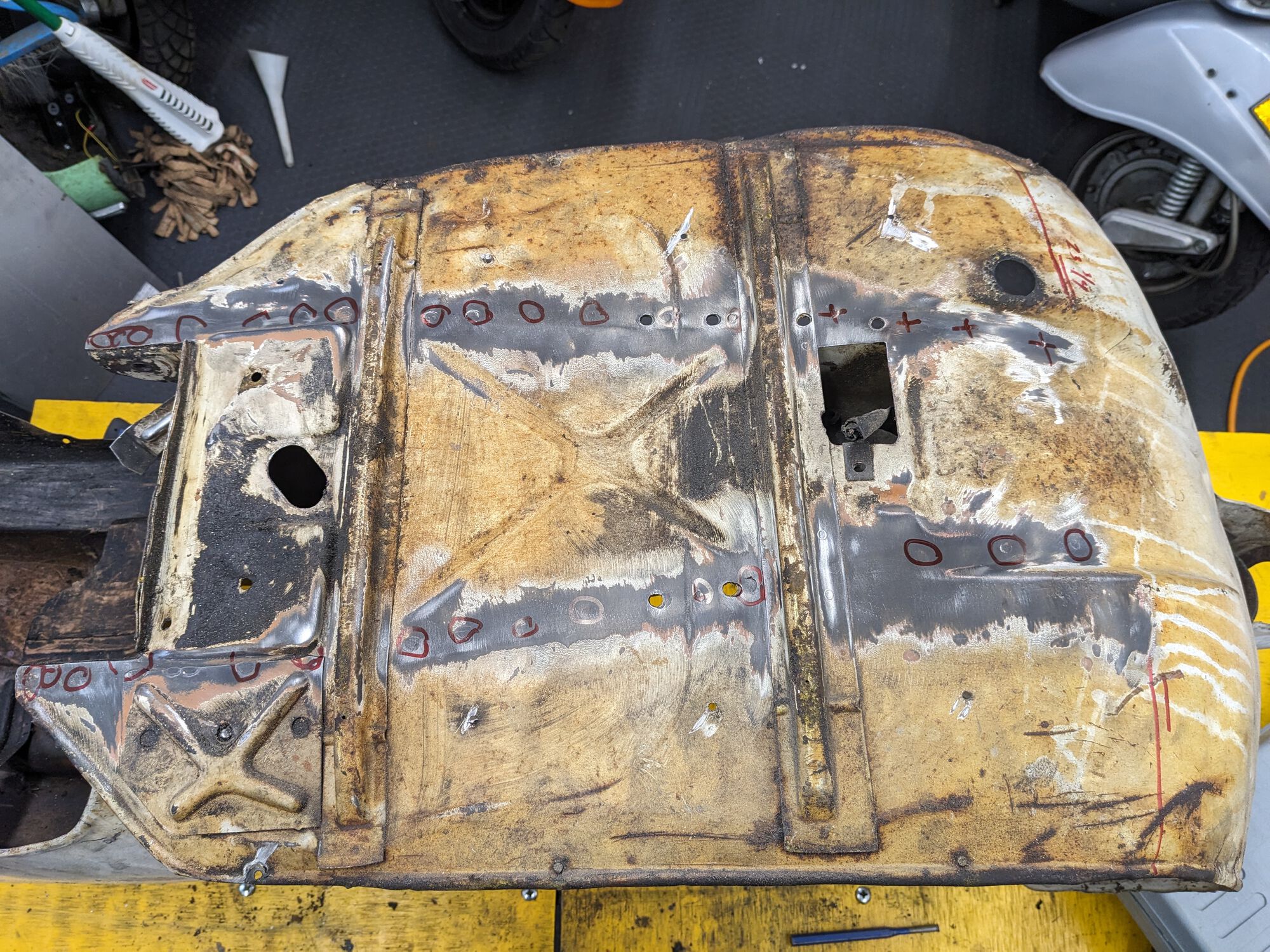

Then, maybe because I was feeling saucy from that victory, I did a bunch of dent hammering, which somehow turned into removing the floorboard.
Anyways, other than one reasonably bloody cut, it was an accident-free day in the workshop and I made some good progress. Can't really argue with any of that.
I forgot to take a picture before I pulled the engine back out, so you have to imagine it's there and fits.
up close
up close

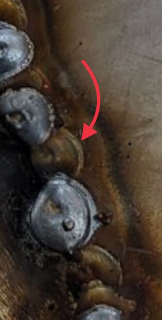

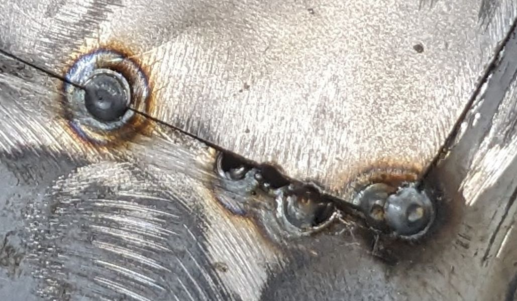

before.  Plug welds marked for drilling.
after
after

Doesn't look too bad in there. Love the sealant worms around the patch in the tunnel.

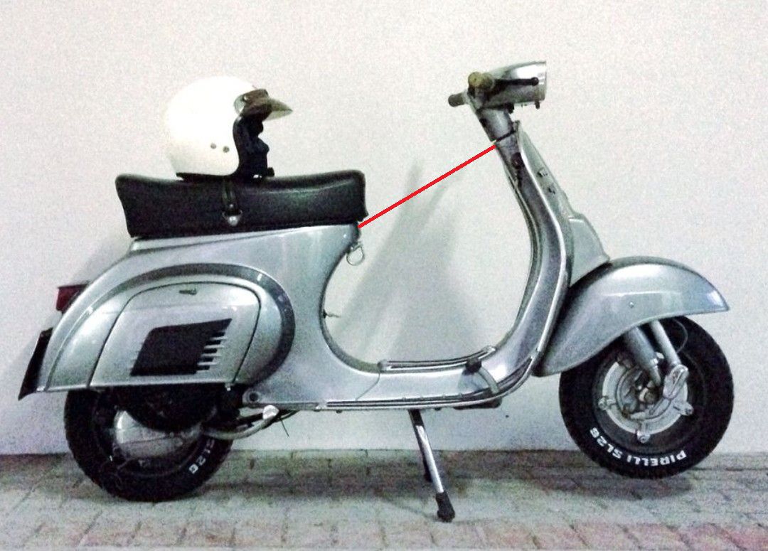

@greasy125 avatar
Posts: 15100
@greasy125 avatar
Posts: 15100
sir, where is your reinforcement bar between the neck and body?
*cuts eyes*

*cuts eyes*
Ummm...I thought about it?
What's the spec on that space and I'll add one tomorrow.
@greasy125 avatar
Posts: 15100
@greasy125 avatar
Posts: 15100
uhhh, about this big *holds up hands with fingers apart*
if somebody doesn't provide tonight I'll measure mine tomorrow. Razz emoticon

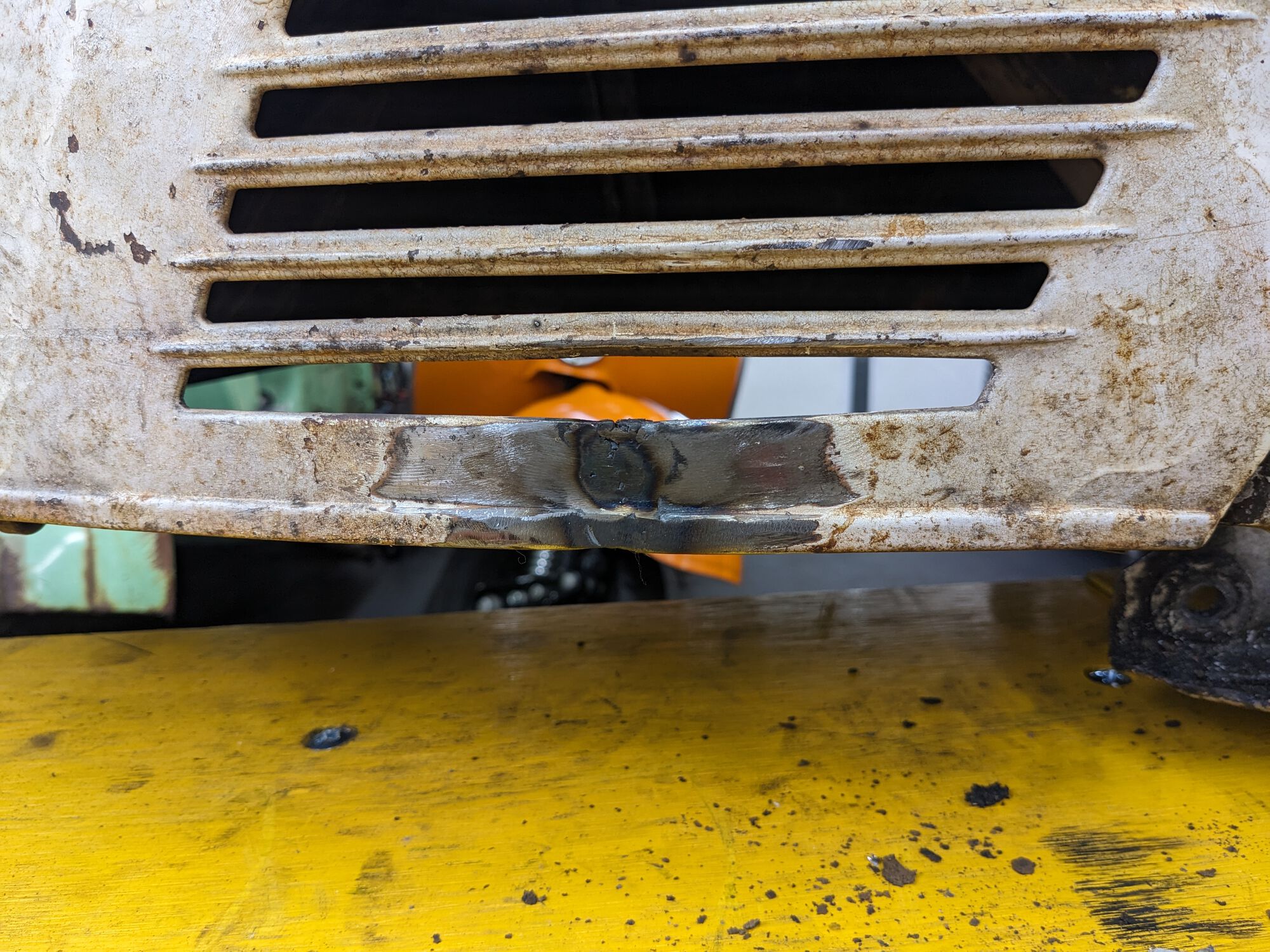

I never had the stones to try this. Good man, CM!
Silly question: is the step-through spacing on the Bluebadge the same as a Primavera? I thought the Bluebadge had a shorter chassis than the other post-'66 smallframes, with the exception of the 90SS?
@greasy125 avatar
Posts: 15100
@greasy125 avatar
Posts: 15100
that is an interesting question to which I do not have the answer.
Smallframe Chassis Identification
Not totally clear, but it references a "short" and "long" chassis and says the change occurred in '67. I was surprised that the Google came up with an MV link first.

huh. TIL, thanks!

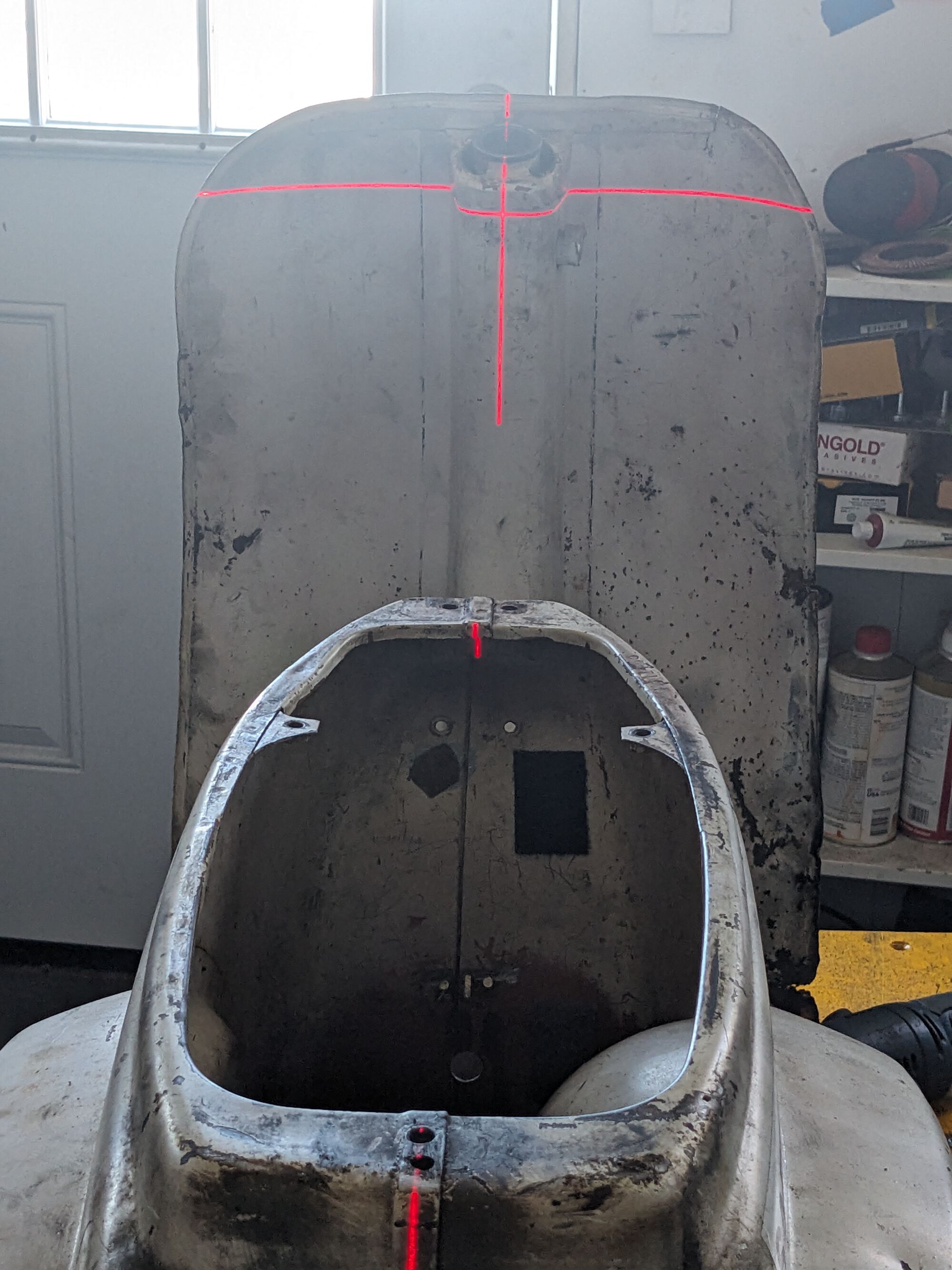

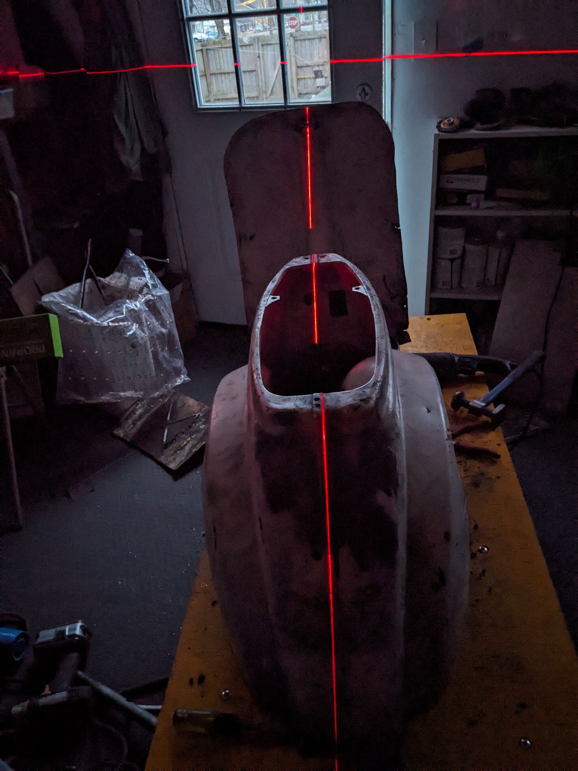

I'm sure there's a spec out there, but in this situation it's more of a preventive measure that the frame doesn't taco when CM drops it off the roof since he's welding up there "because the light is better"...
kidding, sort of.
but more so it doesn't warp up when welding is all. I mean, I know that there's a critical measurement but I'd go with "close enough" so it doesn't turn into a pretzel with metal starts melting.
Jet Eye Master
PX221 MHR, PX200 O tuned, PX181 M1XL, PX125 O tuned and some motorbikes
Posts: 5010
Location: London UK
Jet Eye Master
Posts: 5010
Location: London UK
Is it not easier to cut the legsheild off too? Changing the whole lot would look smoother and probably save time from this point.
@christopher_55934 avatar
2007 Stella 225
Posts: 3547
2007 Stella 225
Posts: 3547
Might as well go for this, your already there a few more cuts and length will be good. Also has the support bar your missing for length. I don't know why, but I get a bit of a stiffy looking at one of these.
https://www.scooter-center.com/en/conversion-kit-vespa-ss50-ss90-vespa-v50-v90-pv125-et3-76700268
I thought it was smaller…. But could be wrong.
POIDOG would know if we can find him.
*bat dog signal*
@poidog avatar
Drama Free
79p200e 66smallstate 85pk50xl 84p125ets 63GL
Posts: 408
Location: Flatness, TX
Drama Free
@poidog avatar
Posts: 408
BN, you're funny!!
It is in fact smaller than a Primavera. Reason it is a fave to do the 90SS conversions.
As az_slynch pointed out with his link to swiss1939's in-depth filter and re-post about the different small frame iterations by Jasper Foehn off of FB. (gotta give credit where it is due)
My SmallState is in storage at the moment. If no one else comes up with measurement, I can go later today and take a look.

poidog wrote:
BN, you're funny!!
Where should the measurements be taken from/to?
