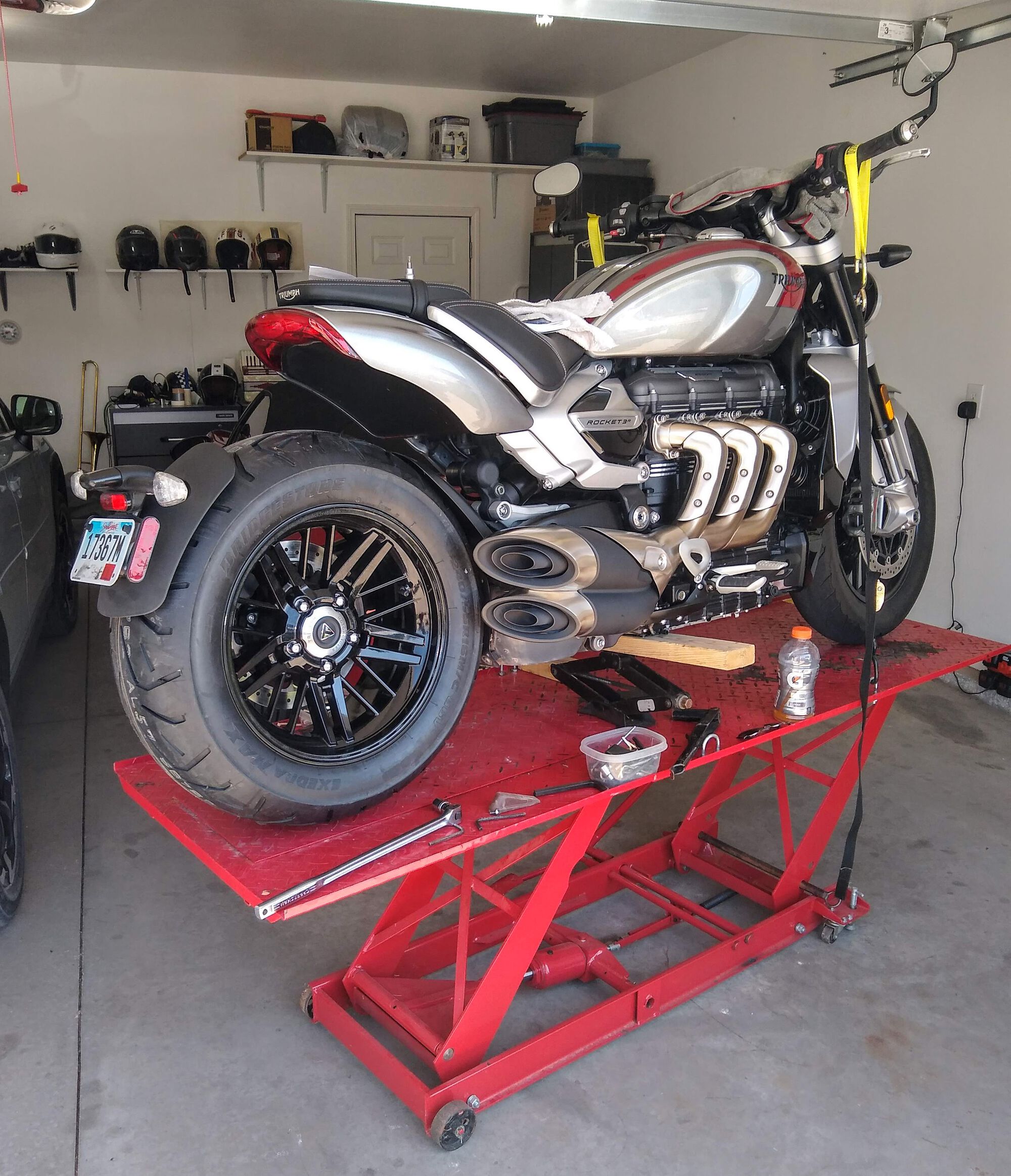

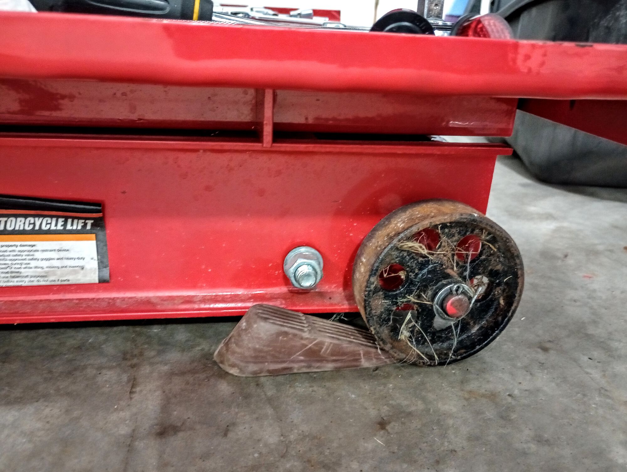

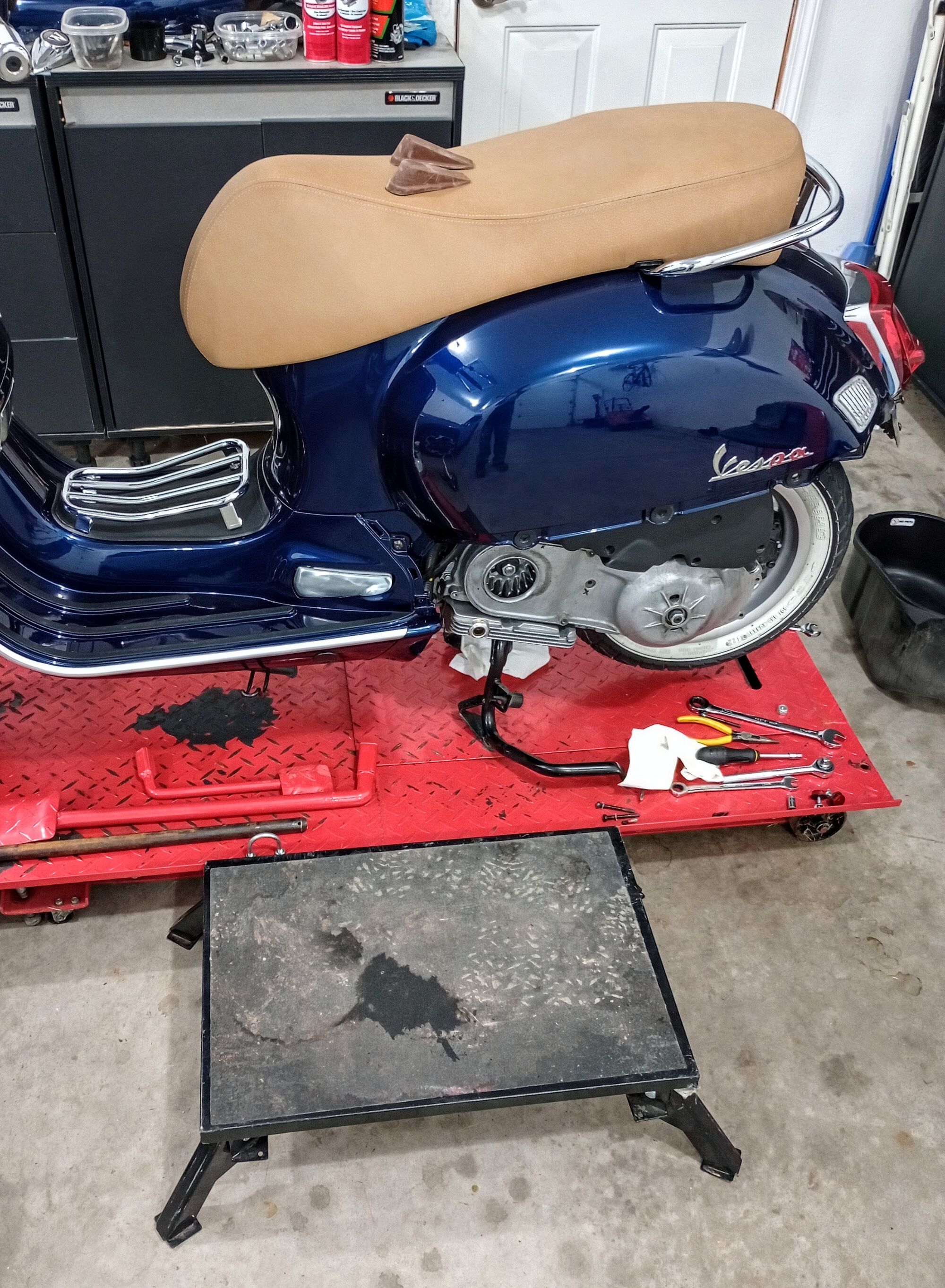

Probably the most economical, basic, MC lift table would be the Harbor Freight unit.
They're operated by a foot pedal to pump it to the desired height, with a second pedal to release the hydraulic pressure to drop it back down.
They're not the kind of lift that a professional MC mechanic would find suitable, but I find mine to be just about perfect for use in servicing medium to (relatively) light machines, though in a pinch, mine has lifted an 800 pound Indian Chief as well as a number of equally heavy bikes, though I don't really recommend doing so as a regular thing.
My HB lift table has honestly served me well for almost ten years without any problems, though it has begun to slowly leak down from it's maximum height, but it has a locking pin that will prevent it from losing more than a couple inches.
The included front MC wheel chock that comes with the lift is junk and should be replaced with the optional HF 'better' wheel chock, though I seldom actually use the chock and just roll the Vespa up on the lift and set it up on the center stand to work on it.
When I bought my HF lift, it was no more than $300, but I think that they're now between $500-$600.
They come in a large flat carton and require some assembly, but it's not a rocket-science-level project to get it up and 'running'.
There are definitely better ones, but mine has been well worth it's price in saved knees and backs, and is ideal for working on a 350 pound Vespa.

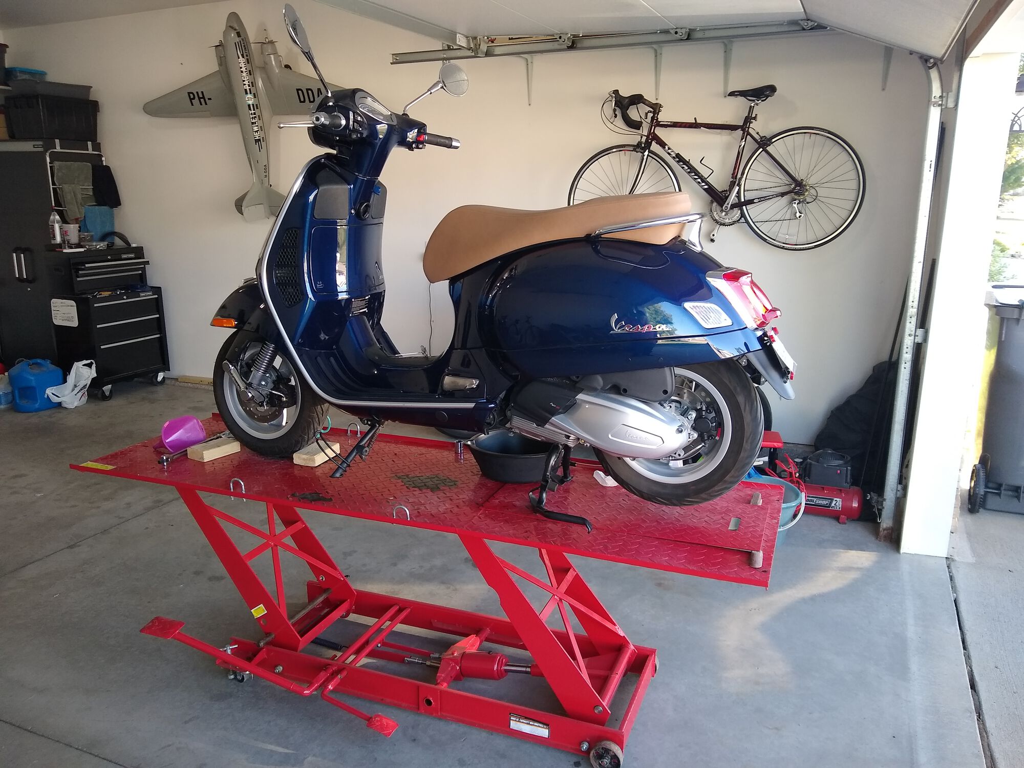

I forget what name it was marketed under way back when, but the one I bought in the UK and still have over there is identical to the HF unit. So google about the usual places in your area and find one that looks the same. They work very well, and are a huge blessing if you have even the slightest of back problems.

... although looking at JBacklund's pics makes me wonder about having a longer one for pulling the engine out ...

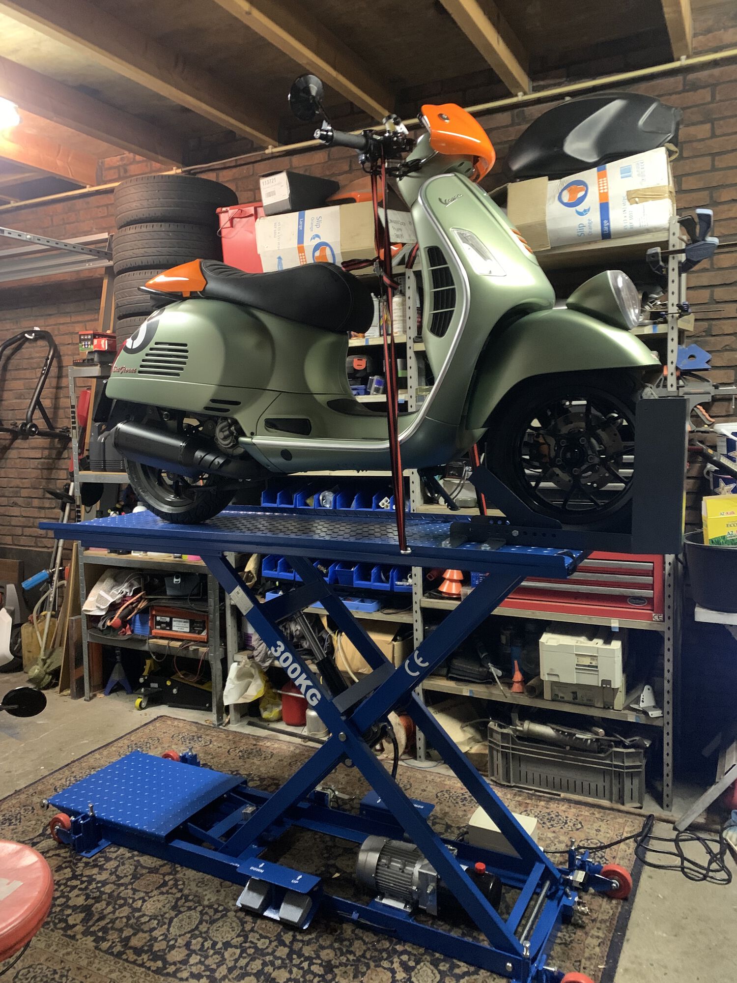

I bought one a few weeks ago , you pay what you get , they are all made in China
And sold all over the world
Mine goes up electric/ hydro , and down you need some air , so happy

Hey that looks good, most I have seen at the cheap end of market are either hydraulic or air.
I like the carpet on your garage floor, kind of classy.

Steelbytes - I think the removable ramp can give you a bit more length for engine removal.
Then the weight as you drag the engine out is further from the scissor point of the lift and less stable. Problem in reality? Don't know.

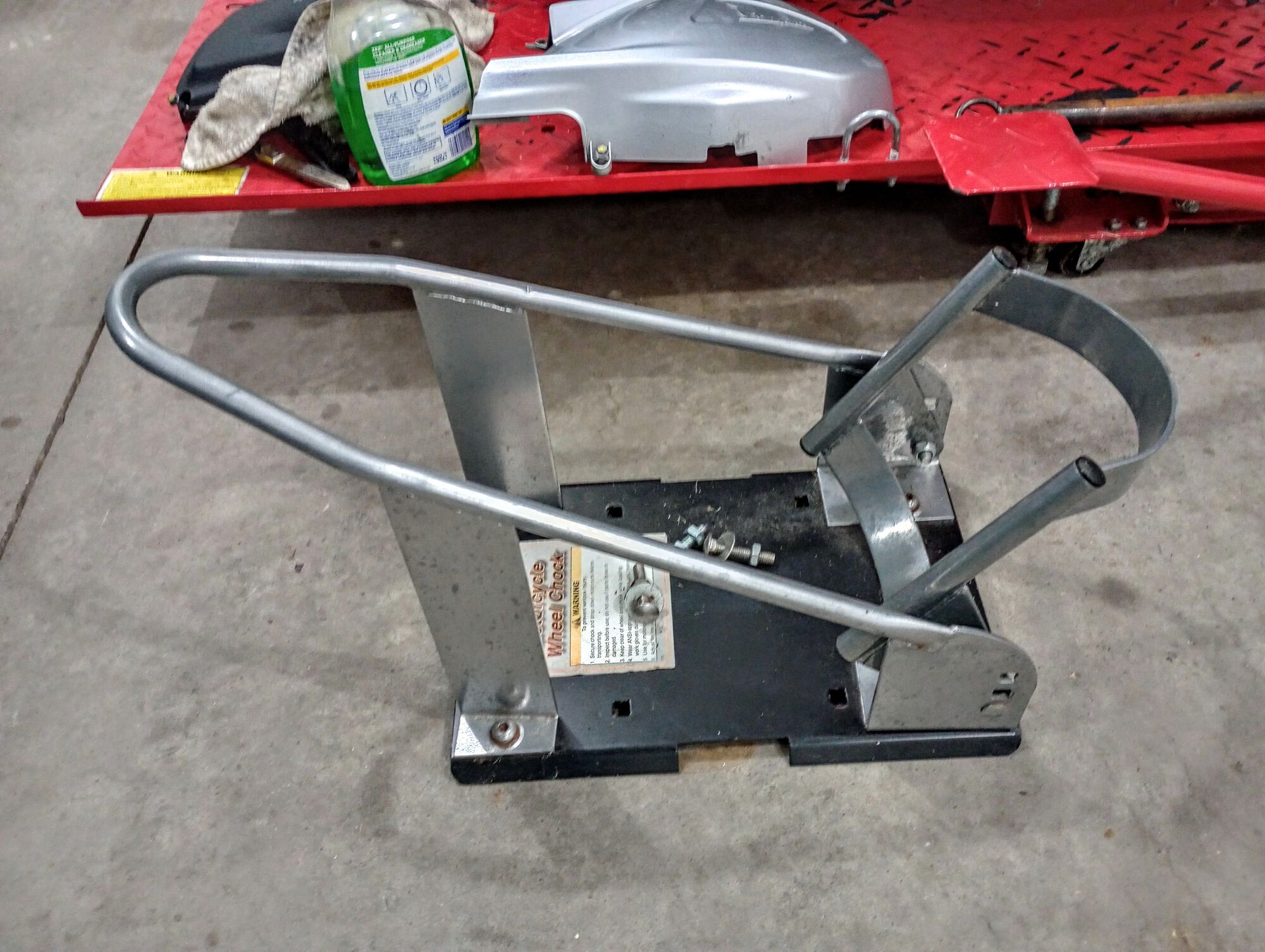

I think an important feature often overlooked is the front wheel chock arrangement. I opted for the pneumatic upgrade on the HF lift 15 years ago even though I didn't have air in my shop. It was and additional $35 (or something similarly insignificant), but it came with upgraded front chocks.

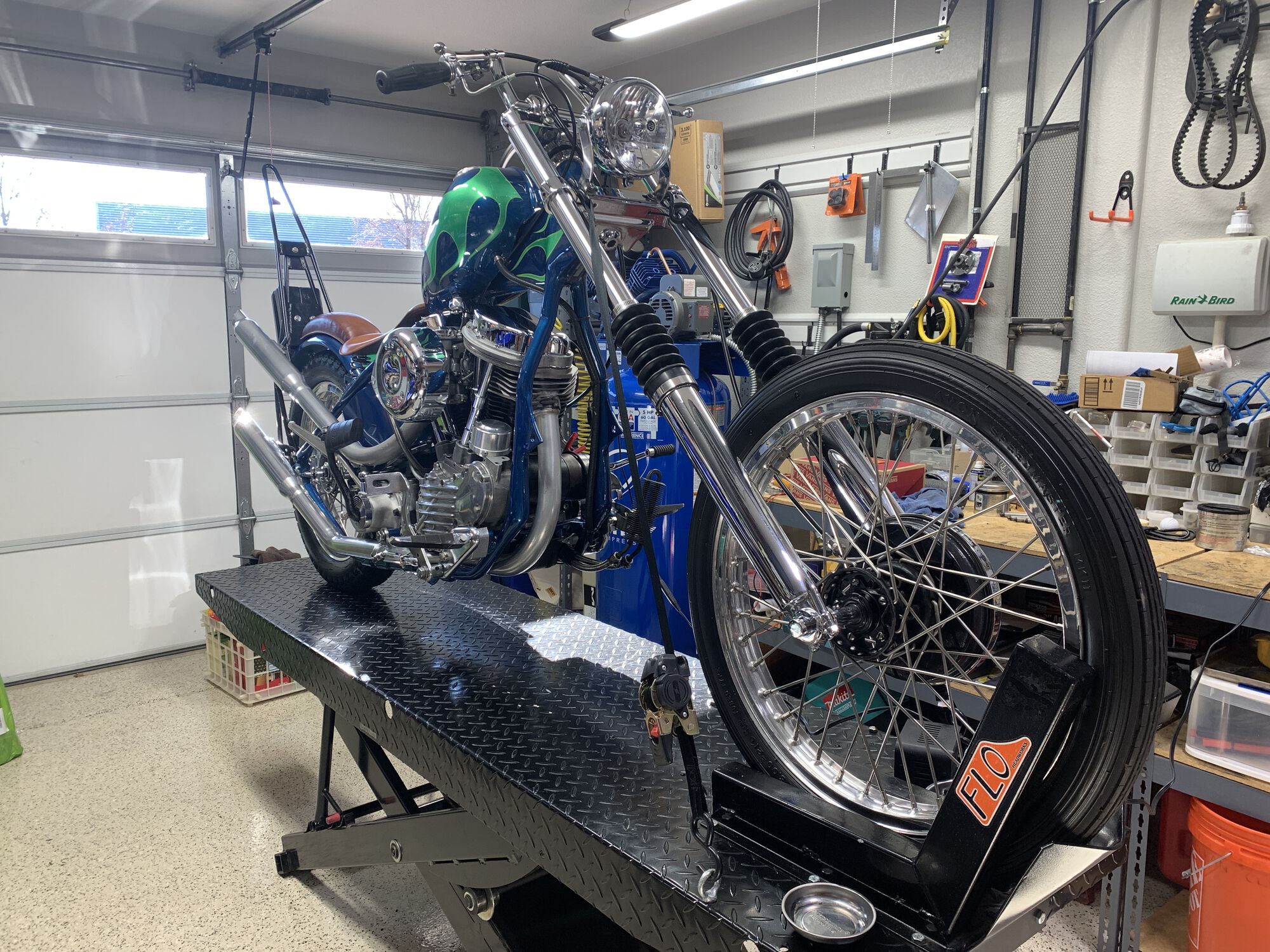

When I had the harbor freight the front wheel vise was terrible. I just dropped four holes and put a wheel chock on.

I immediately ditched the front wheel vice that came with my HF lift table and bought this for it, also from HF. I don't actually use it very much, especially for my Vespa, which I set on it's center stand when on the lift.

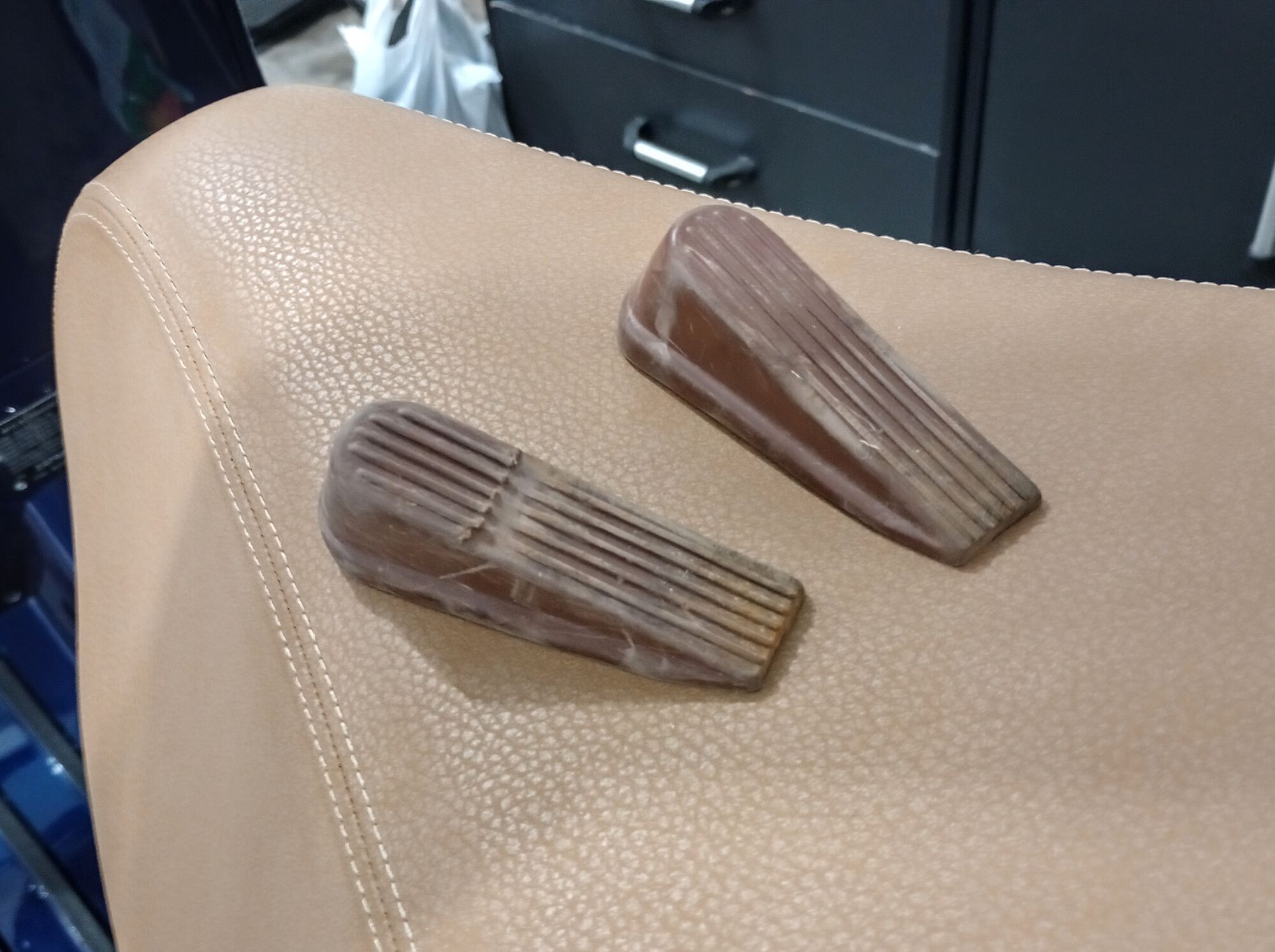

Several simple but helpful details I found that help when using my HF lift table with my GTS300 are these small rubber doorstops that I position behind the lift's rear wheels before pushing the Vespa (or any of our other bikes) up the steel plate ramp onto the lift. They prevent the lift from rolling forward as the bike starts up the ramp, which at first was a bit of a problem. They cost almost nothing and work to steady the lift when trying to get the bike up on it.
⚠️ Last edited by JBacklund on UTC; edited 1 time

adri wrote:
Great minds. I bought the exact same one:
what the hell are all those 2x4 bolts to the lift for?
@adri avatar
Atypical Canadian
Posts: 2319
Location: Toronto, Canada
Atypical Canadian
@adri avatar
Posts: 2319

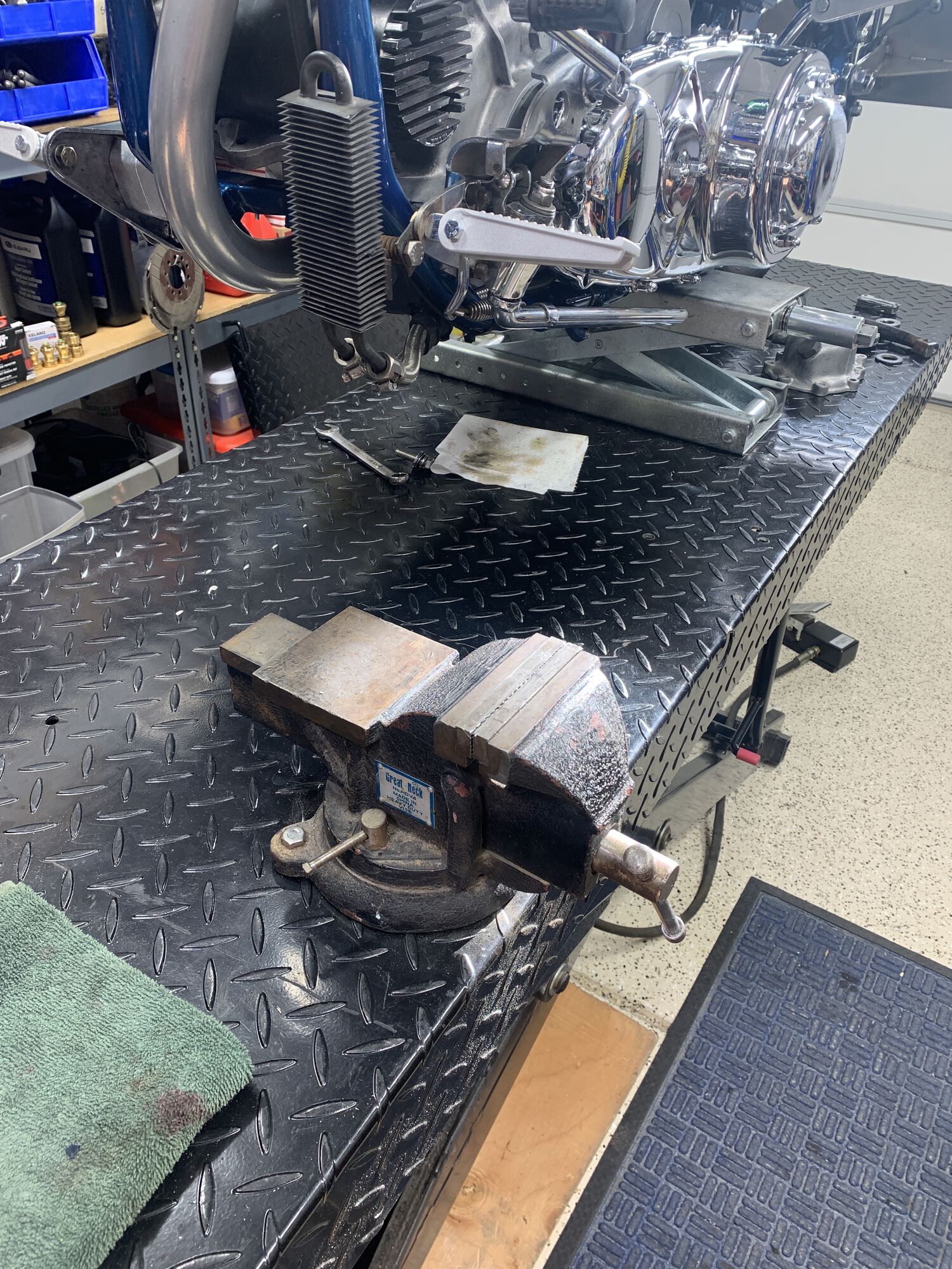

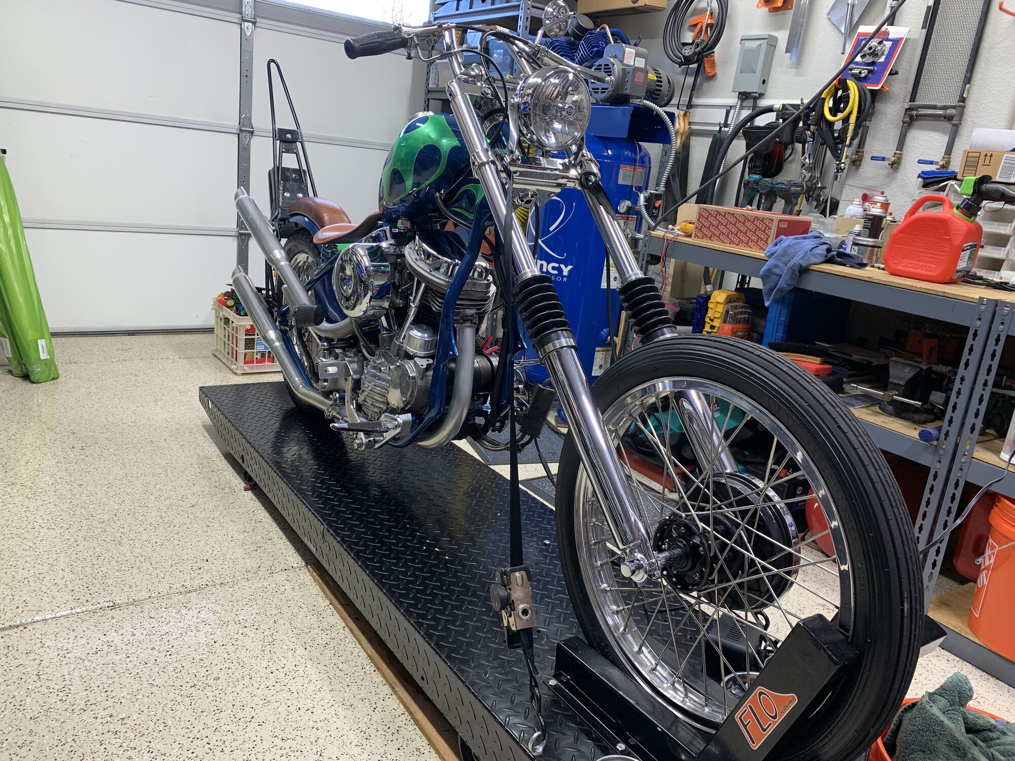

Giving the option of duck walking 900 lb bikes on and off the lift with ease by widening the footing a little bit.
It's side lift table extensions but at a fraction of the cost of buying them.

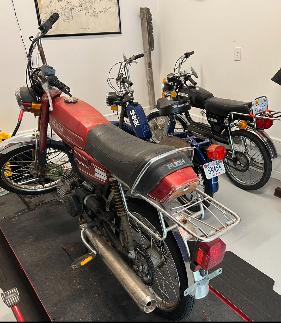

I have the red Harbor Freight one, picked up a couple years ago, serves my scooter needs perfectly. Also good for changing water heaters.

Most of the extensions I've seen are 12" wide on each side of the lift. That's way too wide for my liking. If I have to stand 12" back from the bike, it's going to kill my back reaching out to work on it. Kind of defeats the purpose of a table lift if it adds to my back pain.
I like your narrow 2x4 extensions a lot!

Great idea to use the table to help load/unload bikes and heavy items into a truck!
Along the lines of tips and tricks, I mount my vise to the lift table. Bike still goes on/off with the vice in place. My workbench is not great for a vice. The top is too thin. I can also get the vice at the best height for the job by raising/lowering the table.
Might have to "borrow" this. TY for sharing 👍
@caschnd1 avatar
Grumpy Biker
Posts: 5714
Location: Sparks, Nevada, USA
Grumpy Biker
@caschnd1 avatar
Posts: 5714
It's super easy to remove from a table lift if you need to get it out of the way.
